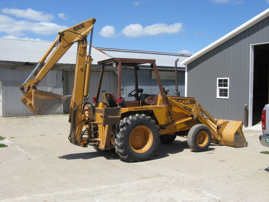

Case 480E 2800hrs original paint, always stored inside, sheet metal is excellent!
Couple questions.... The dump feature on the loader seems slow for some reason? I've ran 580E's in the past and just trying to compare and figure things out.
I know the 480 is a lesser unit but should it be able to pick itself up with the down riggers more than 1'? Could just be the limitations of the pump I guess?
Thanks!!
Ian

$8k, Needs a cutting edge, ball joints on the knuckles, and a seat. The filters look recent but I'm going to do a complete fluid change so I can start keeping track.
I kinda figured the pump limitations were the cause but I wasnt sure. Ive ran 580E and super L in the past so those were the only comparison I had to a 480. It isnt as powerful but thats fine, I'm not a contractor by trade so the couple times a week I use this will work out pretty good.

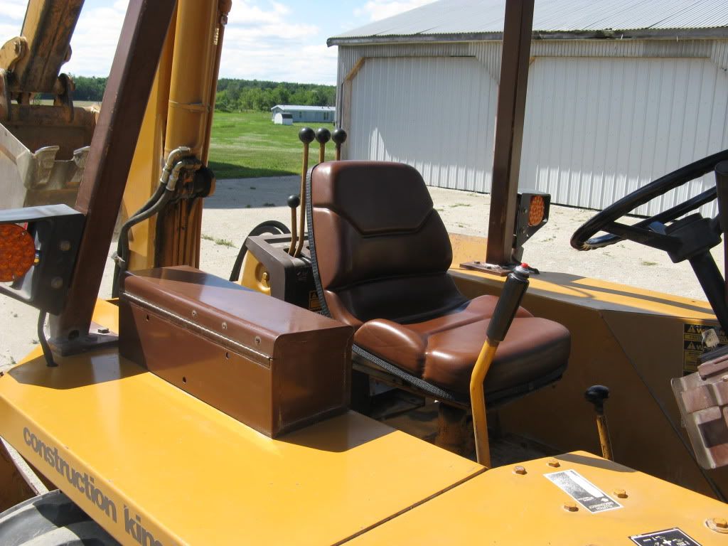

Biggest issue for me is the 3 stick/foot wing controls! I learned on a 4 stick foot swing but then went to the pilot controls (2 stick) and its hard to get back into the groove!! Anyone have a set of 2 stick controls and valve block sitting around? :D
Ian
   / Case 480E #7
$8K, Now you are bragging and you should.
I have a new set of 2 stick controls for a 580D/E. The valve block/sections
are all the same for both control lever setups.

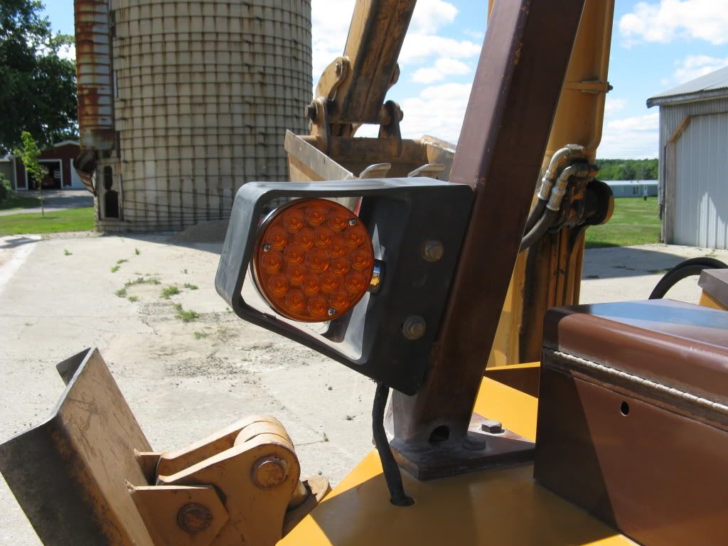

new seat (from northern tool), lights on ROPS, LED flashers, and scored a 46" ditch bucket on craigslist.
