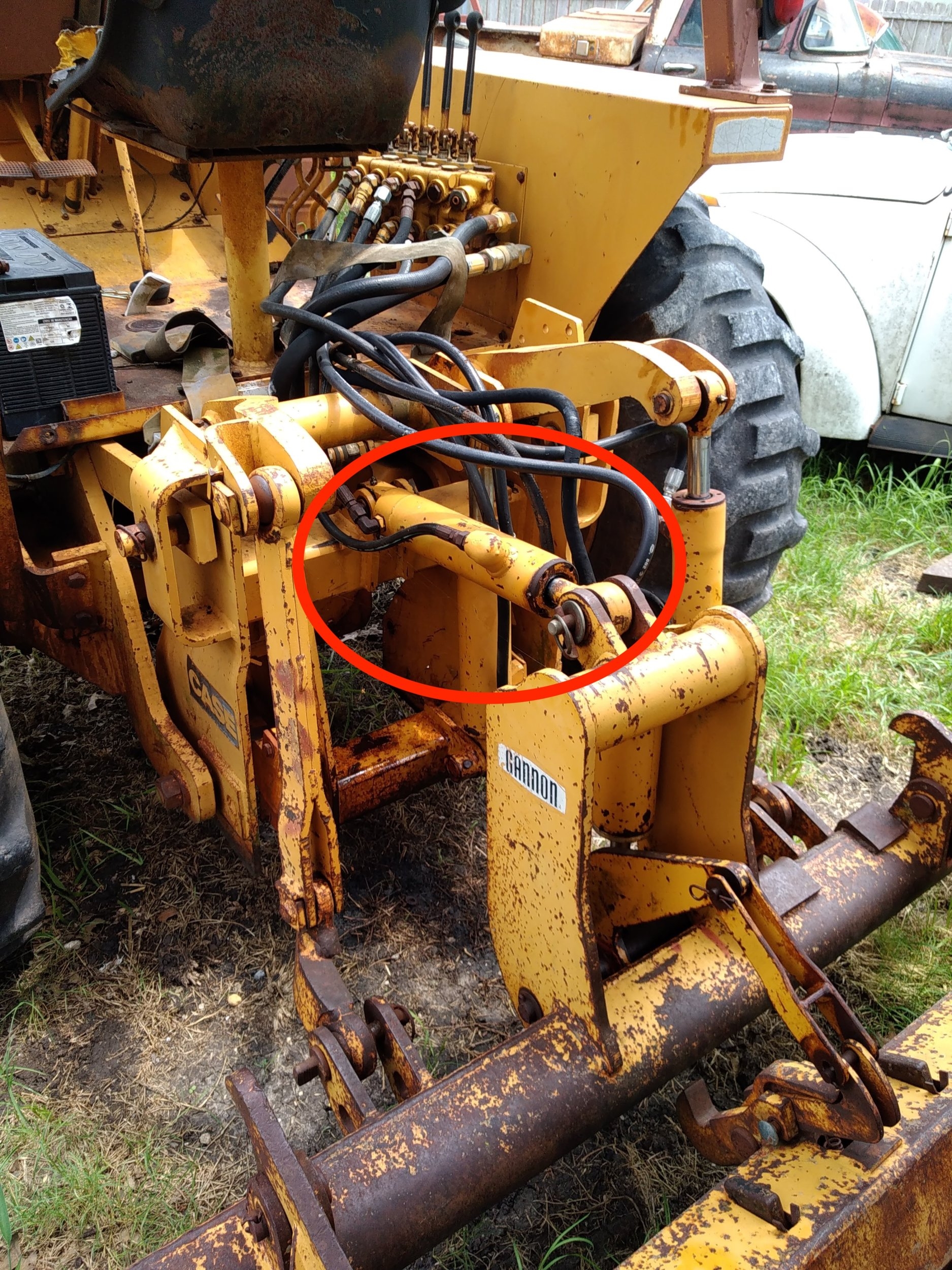

Looking to find a seal kit for a hydraulic actuator, but Not sure which one to pick in the Parts Catalog.
What is the cylinder called that tilts the box blade front to rear (Not side to side or up and down).
Circled the one I mean in the picture.
I bought this tractor like this, the way the lines are routed they rub each other and parts of the tractor.
Can someone share a picture of what theirs looks like or an image of how to clean it up?

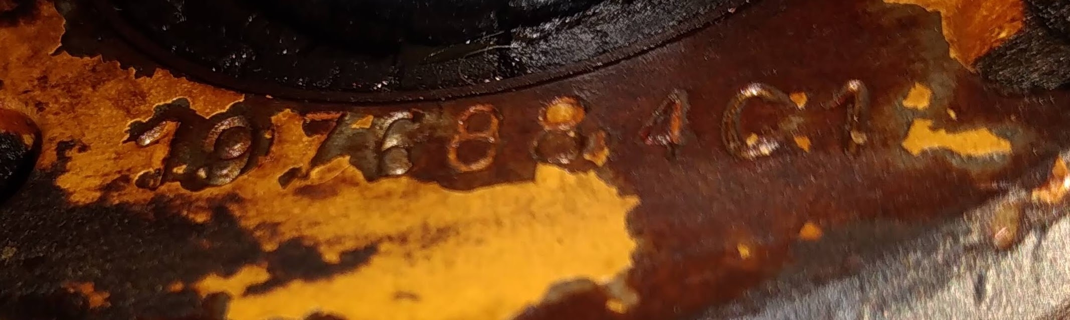

It's called a top cylinder or pitch cylinder. Case calls it a pitch cylinder. The cylinder number is stamped on the top of the gland nut.
For G33128 THREE-POINT HITCH PITCH CYLINDER, FOR CATEGORY I HITCH W/3/4'' DIA. MOUNTING PINS, Kit G109476
For 1976884C1 THREE-POINT HITCH PITCH CYLINDER, FOR CATEGORY I-II HITCH W/1'' DIA. MOUNTING PINS, Kir G110055
As far as the hoses go, loosen them up on bothe ends and get them to lay flat. After that, you may need to take one end off and reroute.
I've worked on a couple, but none nearby.
