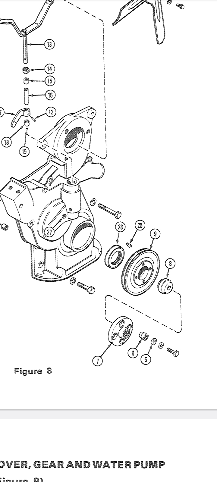

So I managed to get the nut off (parts 8 and 9 from the first post) but it looks like the the pulley - part 9 - has some sort of sleeve on which makes it impossible to pull the pulley out of the engine bay because of the depth clearance. If that makes sense. I tried scraping the seem to see if they were pressed together and couldn't really tell but it looked like it was one piece.
I am trying to access the governor and the front case also seems to be stuck pretty good. I sprayed half a can of wd-40 where the seal is (I have a new seal and oil ring already) and will try again to pry it off but there isn't much to get leverage on.
I'll snap some pictures tomorrow but just wondering if anyone encounter this or understands what I'm trying to describe lol.
I have a 480ck gas model.
Looking at the service manual it might be the oil seal pressed into the pulley but it sure seems like it's one piece. And the piece in the back side of the pulley doesn't look like an oil seal to me but I don't know what oil seals looked like in 1969.

Not sure how much it will help, but here is a picture of the crankshaft pulley on my old 310B w/148 spark engine. I do recall that nut and what appears to be a large washer behind it was all one piece. After finally getting that off, I was pleasantly surprised the pulley slipped right off. The big difference was this was an agricultural tractor and there was room enough to come off without removing the front end. And for the life of me, can't remember why I had to take it off, but assuming it was to replace that crank pulley seal. Note, pic is from 2010, and I've worked on a lot of stuff since then.
Here is an exploded parts diagram of the Case 148 crankshaft pulley from the backside. https://www.mycnhistore.com/us/en/c...-E111-9FCE-005056875BD6/5DCD6496-EFBE-E111-9F showing it's basically like other pulleys I've seen with the shoulder for the seal to ride on.
Just took a quick look in my service manual, although it's the diesel section, it shows the pulley coming off by hand, go figure. Without pictures seeing how much room you have to work with, if you have a large bearing separator behind that pulley and a large 2 jaw puller will get it off. I don't expect it is on there that tight, at least not like the press fit pulley's on my small IH C-113/C-123 engines.

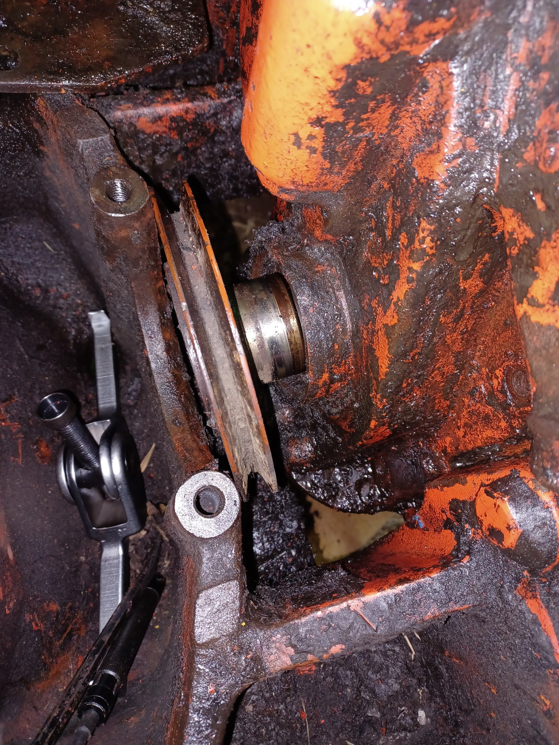

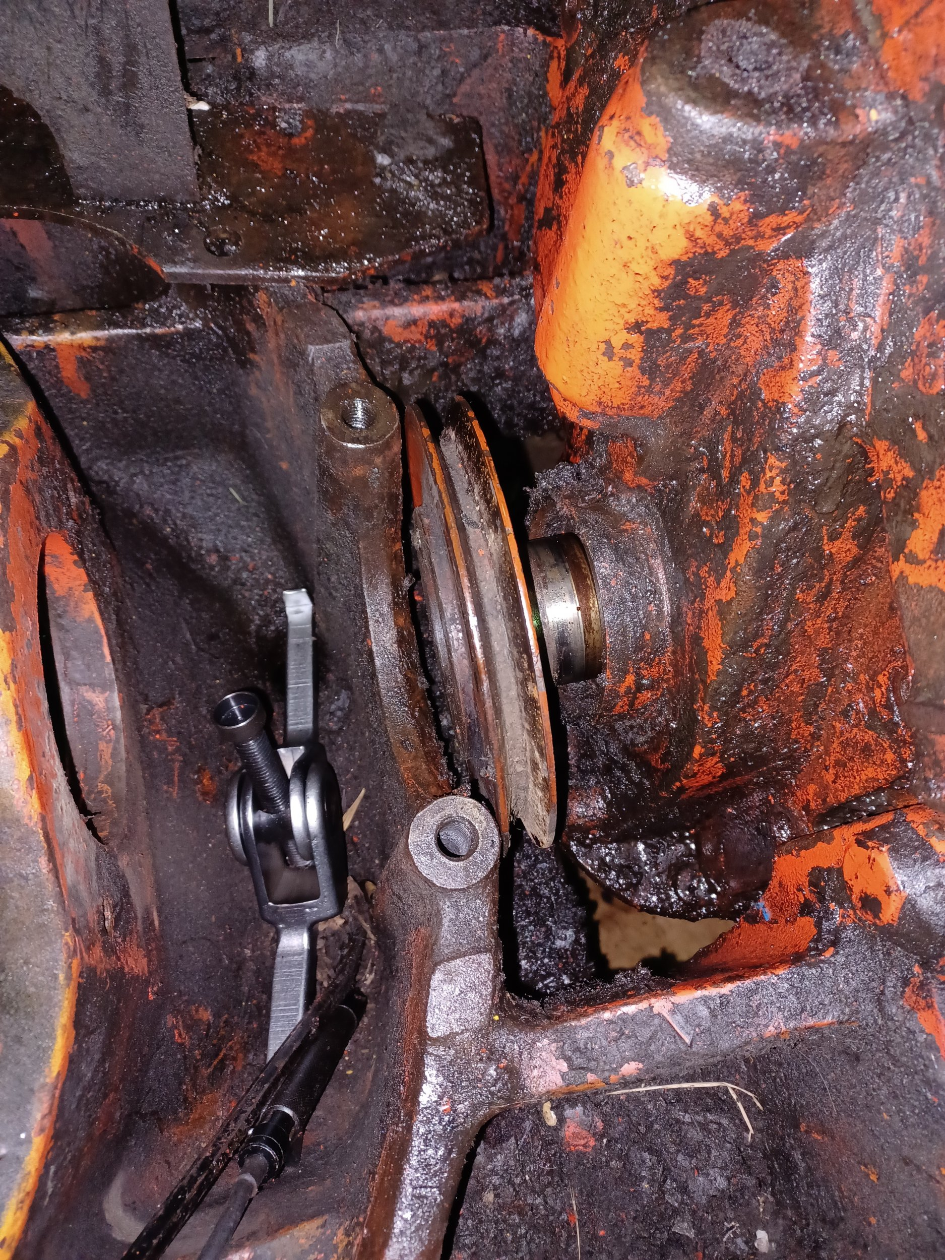

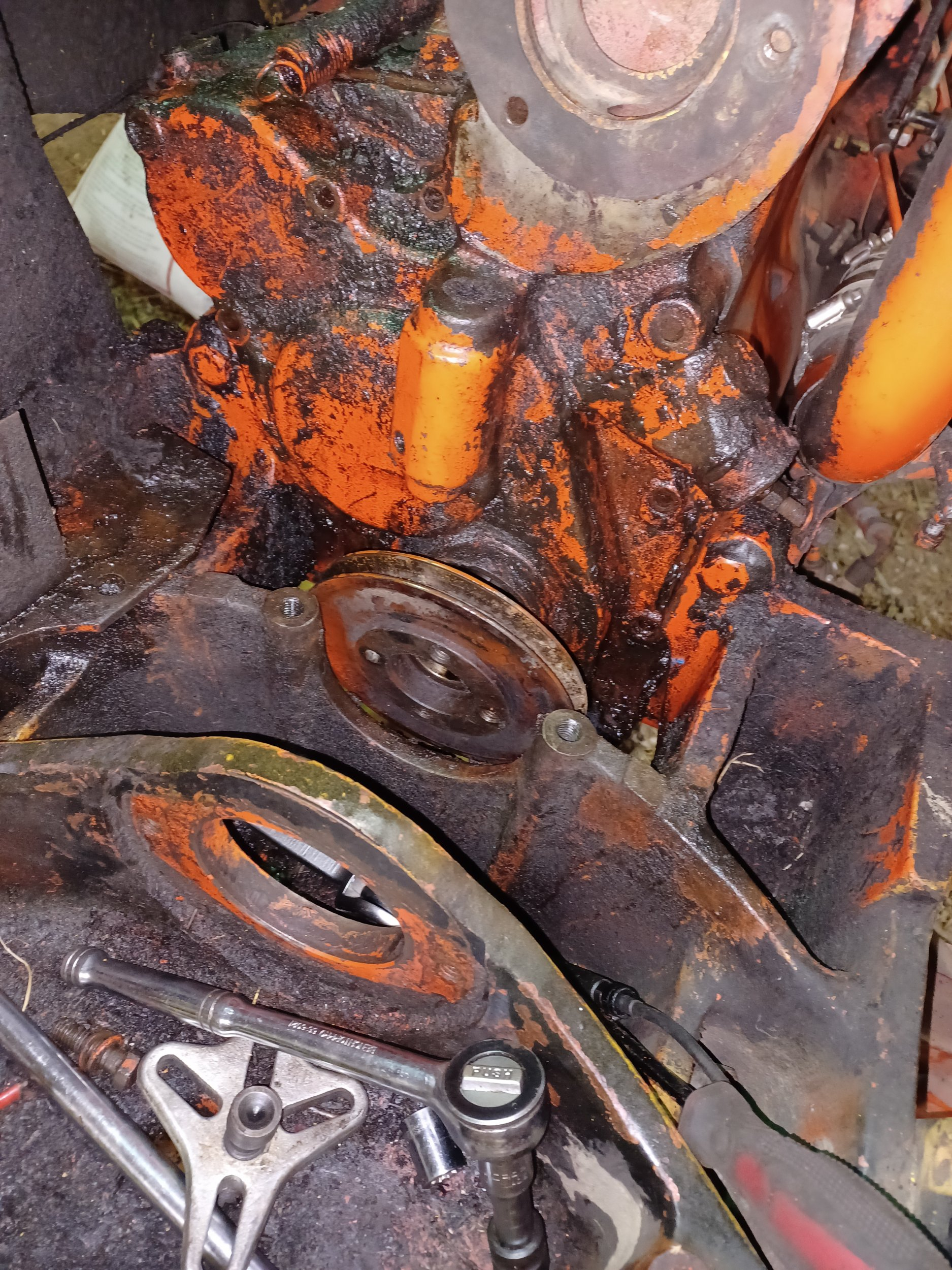

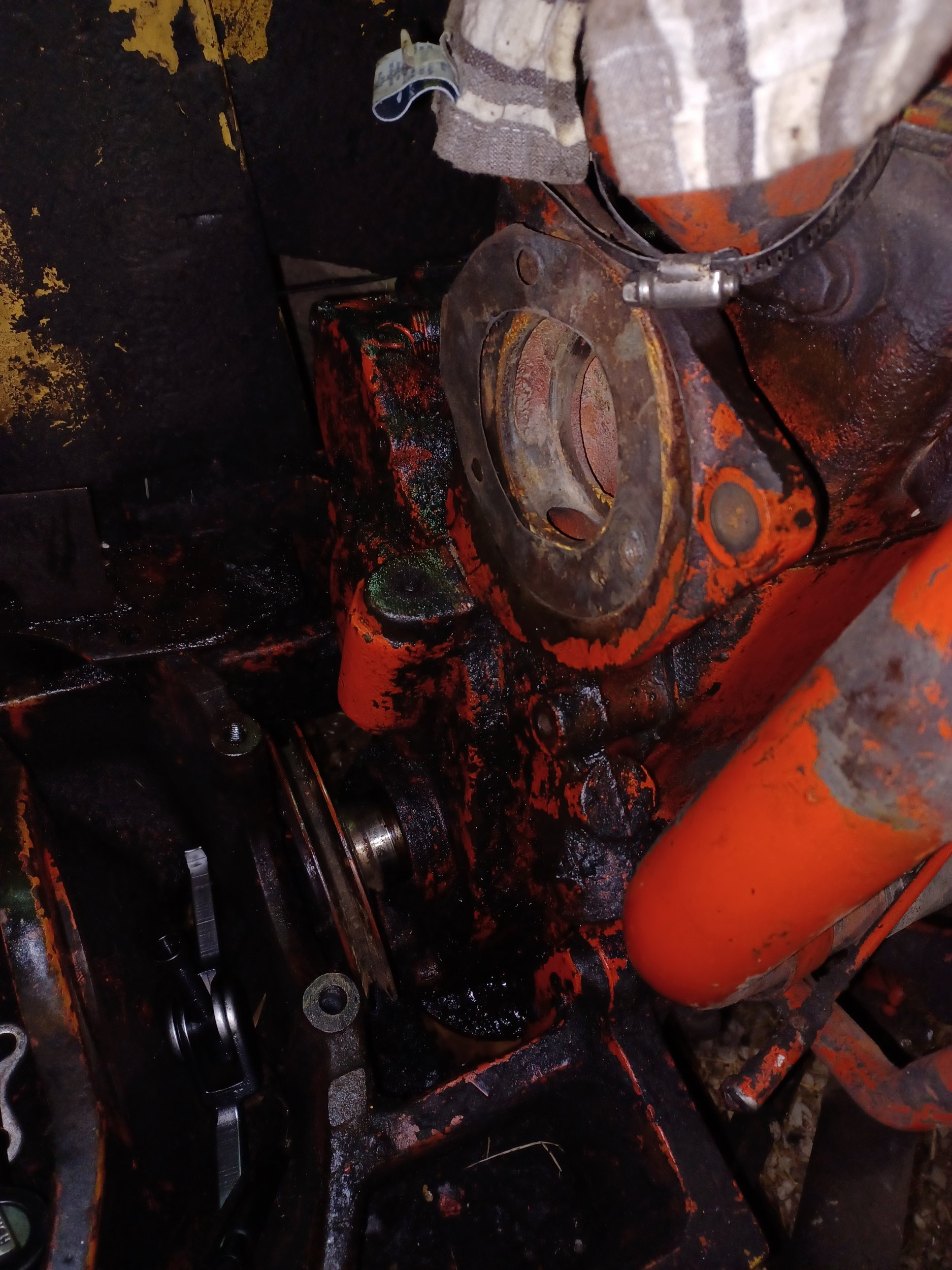

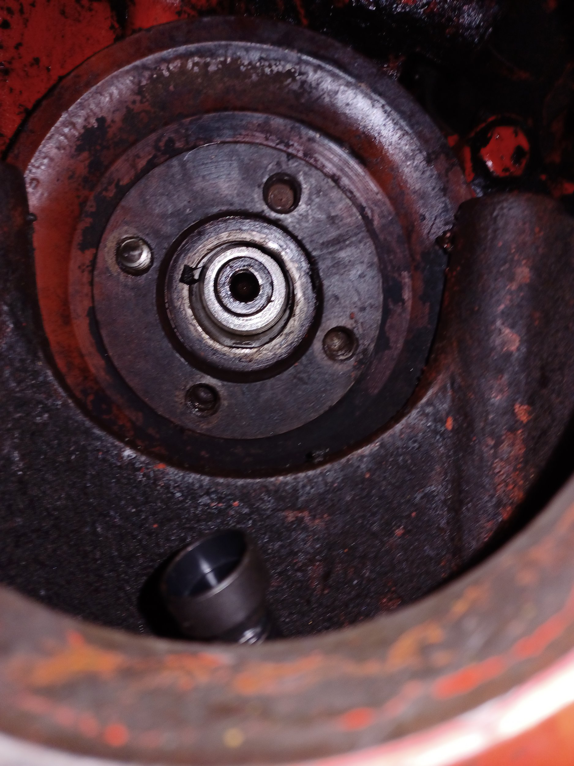

Here are the pics. This pulley won't come out as it is. I'm hoping that the change in weather/temps will help pop the case off. If this happens I think it all can be removed as one piece.
For a great penetrant, a 50/50 mix of Acetone and any ATF works great. Works better than anything I've used off the shelf. Just have to be careful where you use it, as the Acetone will remove paint. I just bought a quart of each to try I think when I started working on the old 310B. When that was gone, I started buying Acetone by the gallon, and ATF in a 2 gallon jug at Rural King so it would always be on hand. I use a dish detergent bottle with snap lid to keep the Acetone from evaporating. It will separate in the bottle, but a quick shake will mix it up.
DJ,
Thanks for the info and especially the penetrant info. I will try this in the future. I just talked to a farmer buddy and he explained how the sulfur that used to be in 'acid rain' was beneficial to his crops. Now it costs an arm and a leg. Touchy subject I'm sure but these bits of information a priceless.
I bought 2 2-jaw pullers recently online and neither will work for my situation. I intended to send 1 back but for the nominal costs I think I will use them at some point in the future. Good to have on hand.
Thank you for the link but it doesn't seem to be working for me. See if the pictures I posted help explain my dilemma better than I could explain. I could rig up a punch of sorts but I still swear that pulley and 'sleeve' are one piece. As mentioned, I might have to remove the front end. This 2-3 year project might take a decade if this continues!
