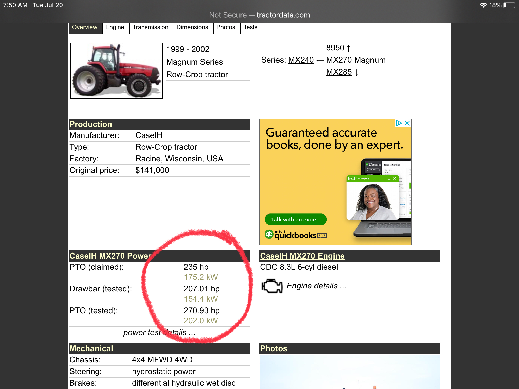

My Case-IH is rated at 270 engine HP. On the dyno it made 270 at the PTO! Which means it makes more like 300 engine HP.
In almost every case, Case-IH “under rates” their engines. Kubota tends to rate their engines closer to max HP.
Note below Case-IH rates my tractor at 235 PTO HP and 270 Engine HP. In testing, it tractor data testing, it also made 270HP at the PTO. I found this to be pretty common with several other Case-IH models.
Pretty cool for those who do their research.

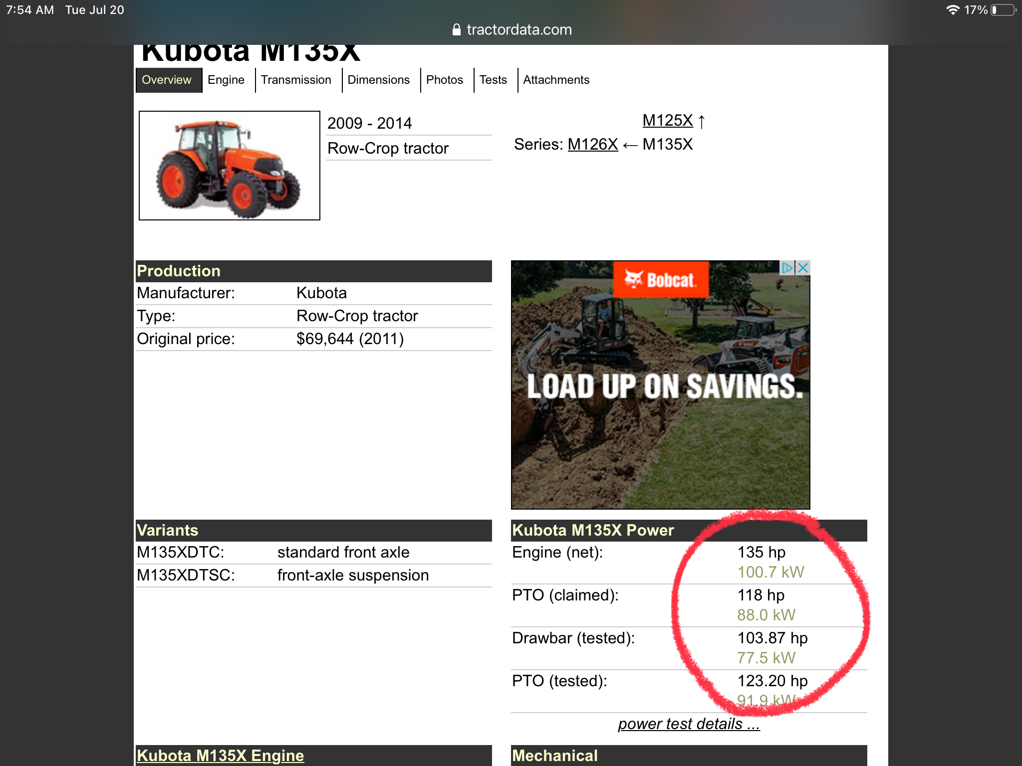

Dont get me wrong, I like my 2 Kubota farm tractors a lot. However, for a 6.1L engine, they are not powerhouses. They are good, reliable strong engines and they are well built.
My M135X also exceeded claimed PTO HP by a small margin, which is good, but Case-IH REALLY over does it on the HP.

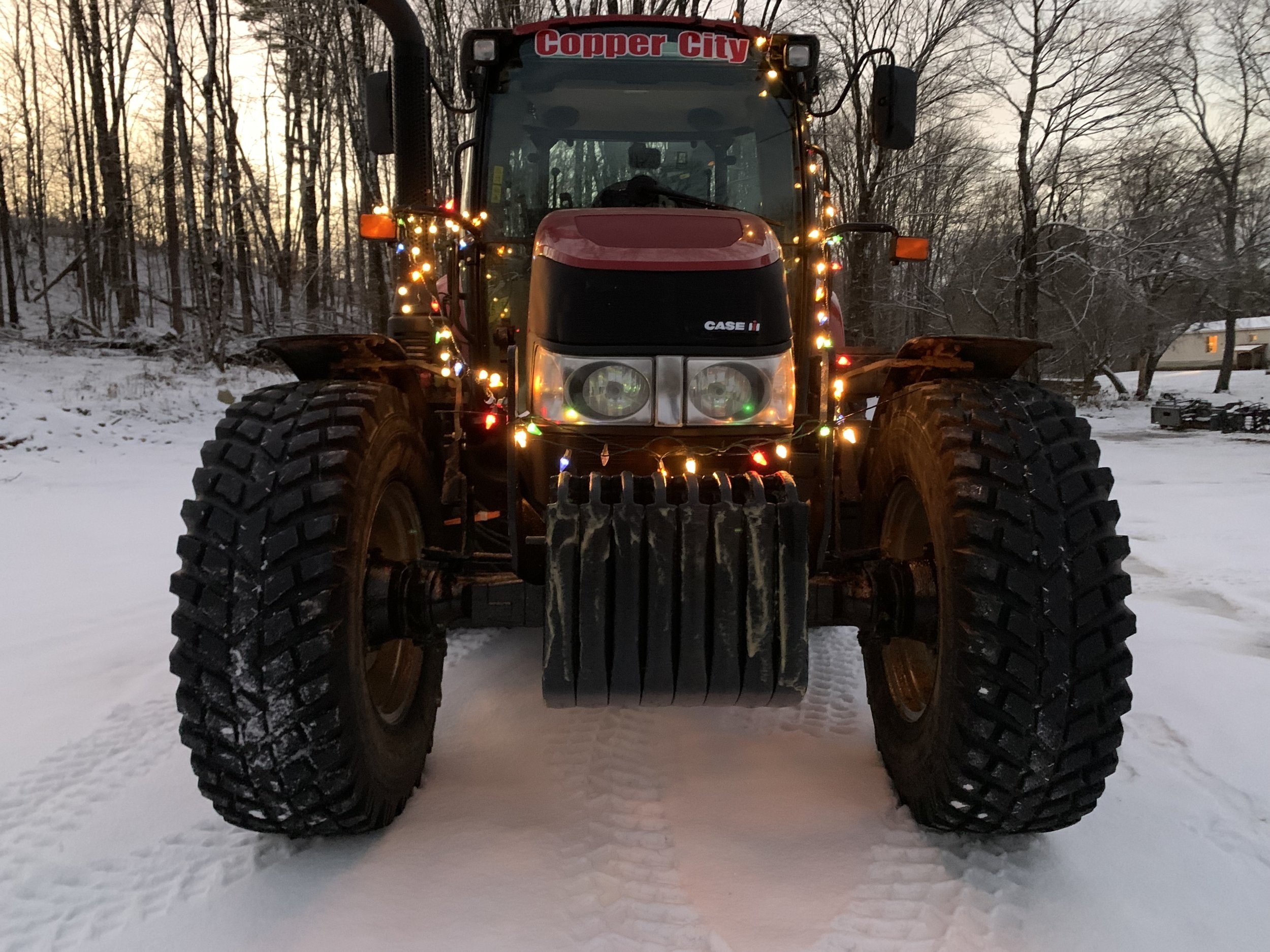

Just an update for my fellow tractor nuts. I am two winters in with the Case 110C. It has only been down once for a def issue. I found out they run the same setup as the Kubota. Everything else has been great. I put a set of Nokian snows on and it runs my blower great. It sees no summer use. I will be putting on an extended warranty before mine is up. I think I made the right decision. Then again maybe I would have loved the Kubota. I will say every time I get into a heavy enough snow that this tractor knows it is hooked to something I smile at the power I have. I think quite a few times the Kubota would have run short.

Unique choice of add on lighting. ;) Nice looking setup.
I typically dress her up a little bit for Christmas. When I put up the pic I never even looked. She sure is pretty...
