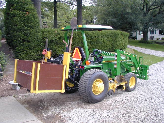

Here's the approach that works for me (see series of 3 photos in this and related posts). I have the equivalent of a "pickup" box that I carry on pallet forks. The fork frame also has removable racks (yellow and black) on each side to hold shovels, rakes, pitchforks, etc. For loader ballast, I always have several old wheel weights in the box. When hauling loose materials such as mulch I take them out. The box is very handy for carrying tools, firewood, fuel cans, slings, etc, and I keep it on the tractor most of the time. The forks and tool racks were manufactured by a company called Attachments Plus in Michigan. Not sure they are still in business, but any pallet mover or carryall could be the starting point for fabricating your own pickup box. I built my box as a flatbed with removable sides. Hope this provides some ideas for your own inventions.
