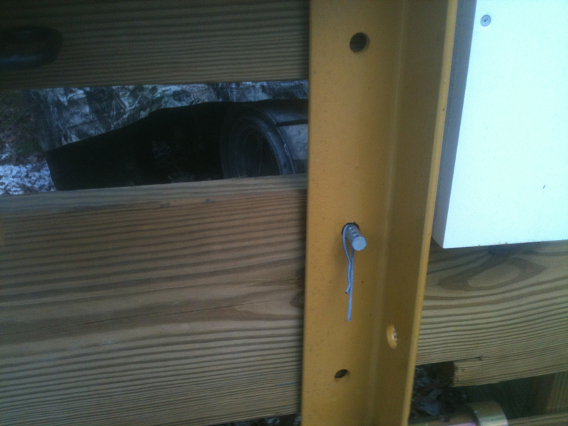

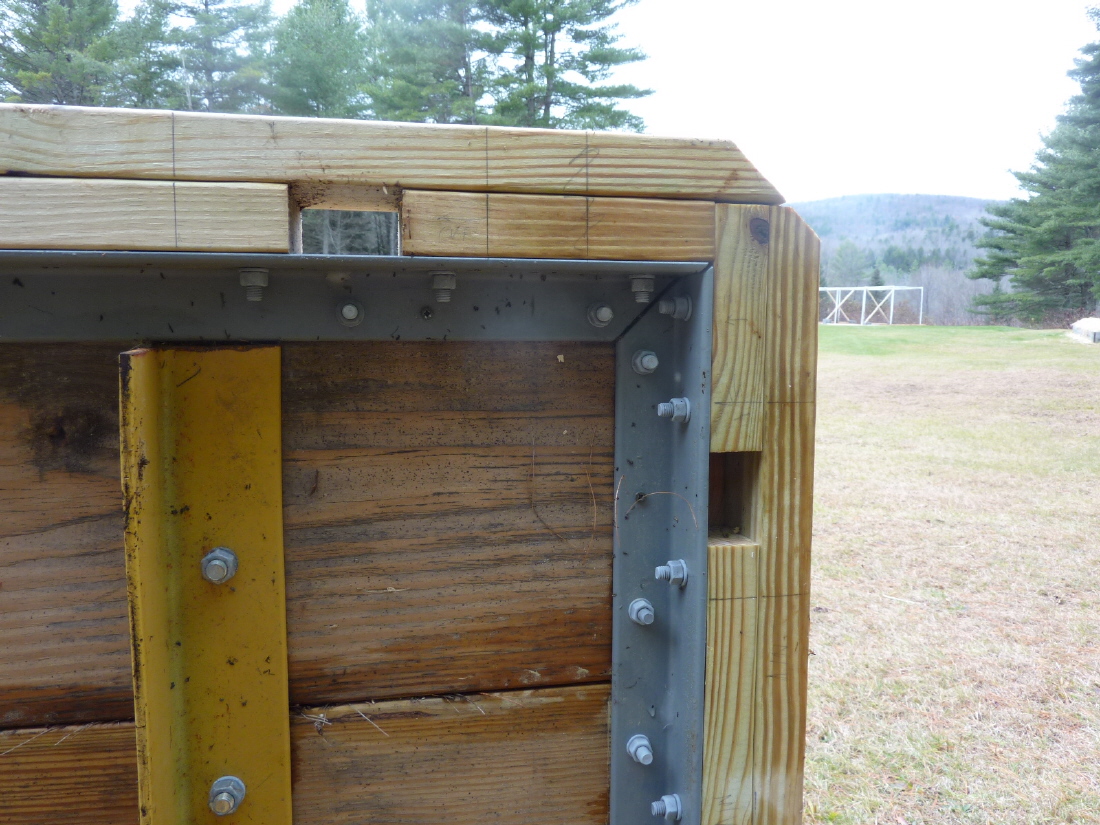

What does the underside of it look like, where the 2 x 4s go down through the floor?
/ Carryalls #22

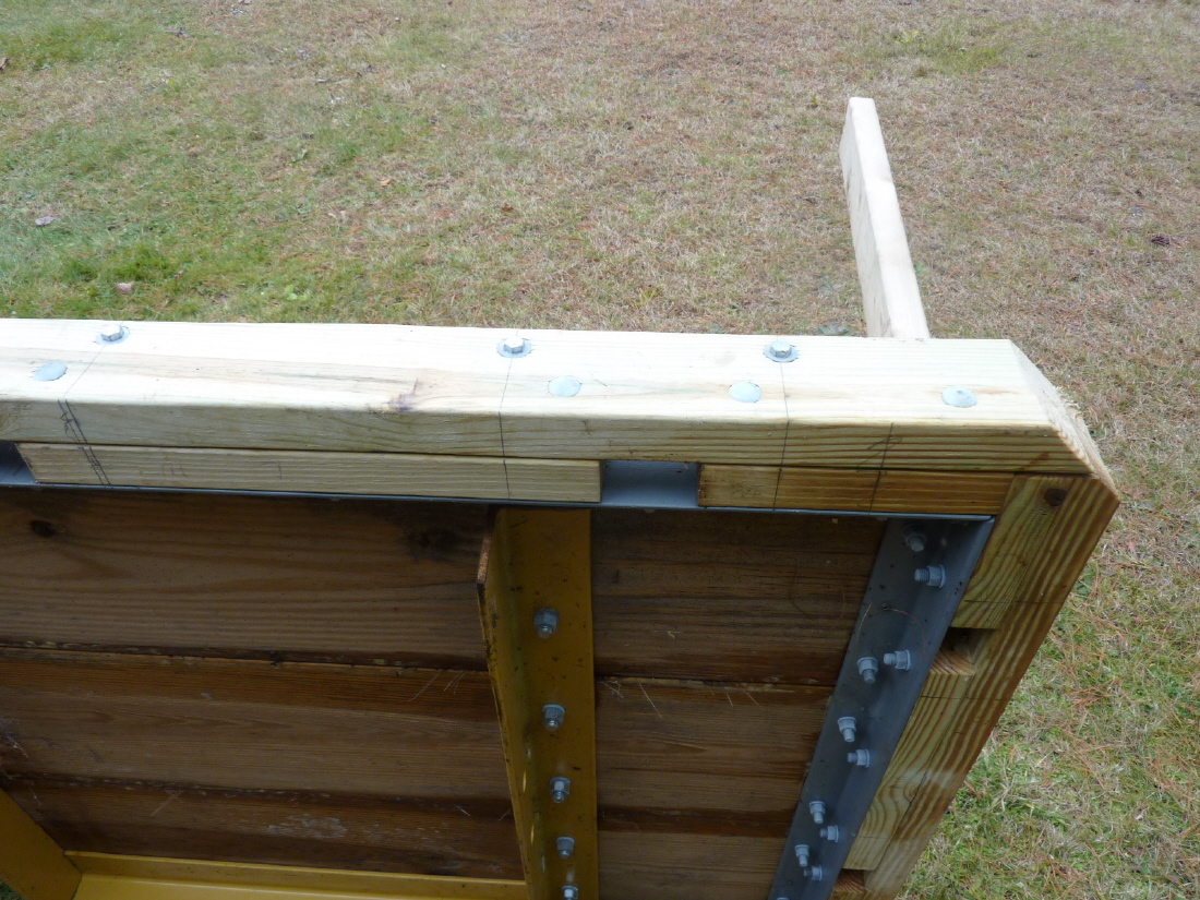

Gordon,
Welcome to TBN coss.
I used a piece of 2X2X1/4 angle I had to make the edge 3 1/2". Then bolted and lagged 2X4's to make a rim with pockets. It seemed a little clunky as I was making it but it works good and is plenty strong. I cut a piece to short so I mitered the corners as a cover-up to avoid criticism :D

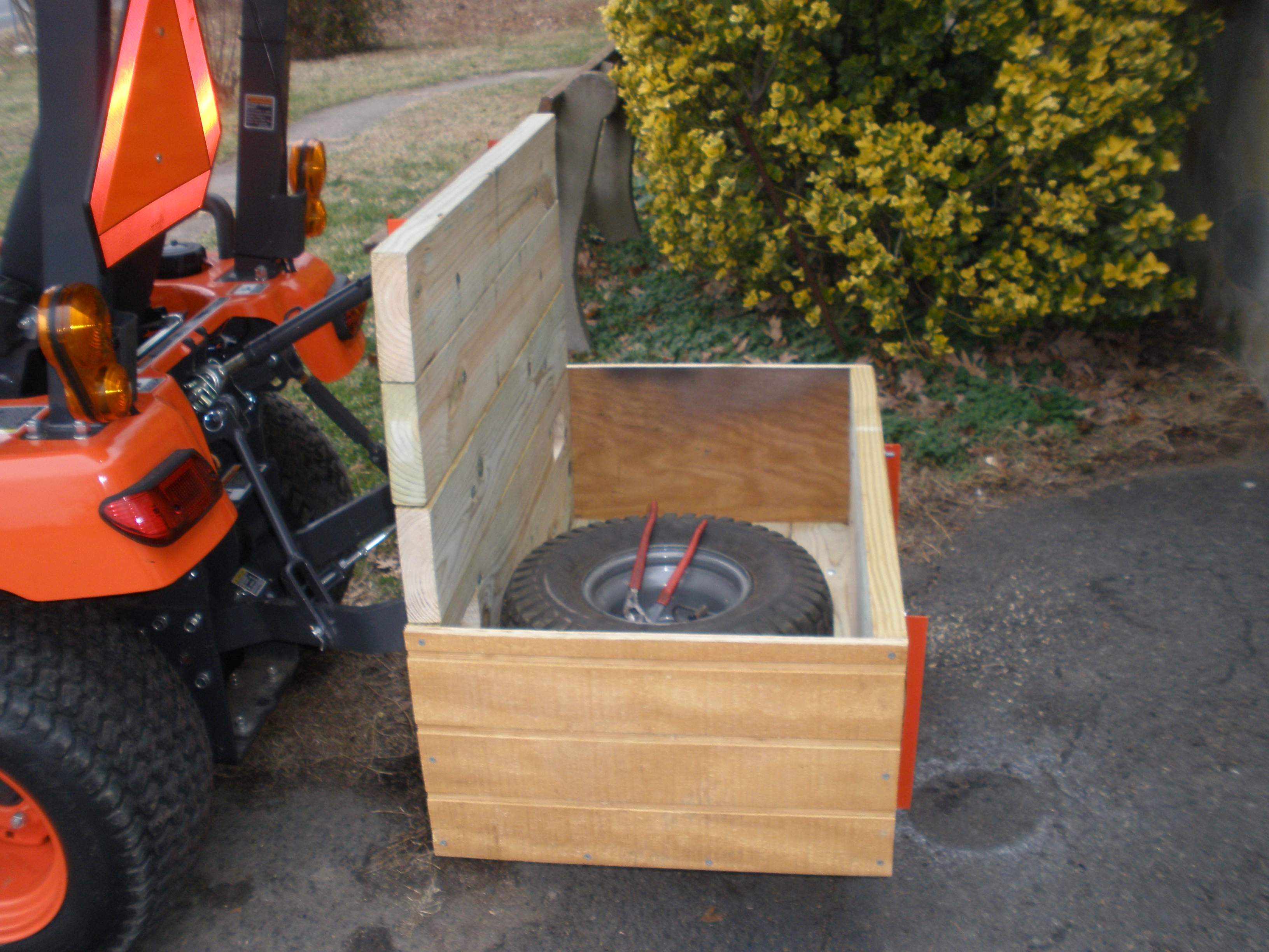

Just this last week I ordered a hydraulic toplink for it. I drilled holes and put 3 pt pins at the bottom of the uprights. I can lift it high enough so that it can dump now. I plan to side it with some 3/4 plywood I have, and line that with tin flashing. I'll use it as a winter wheelbarrow- horse manure- so that I can leave my snowplow attached to the bucket all winter.
I've had the idea for some time- finally acting on it.

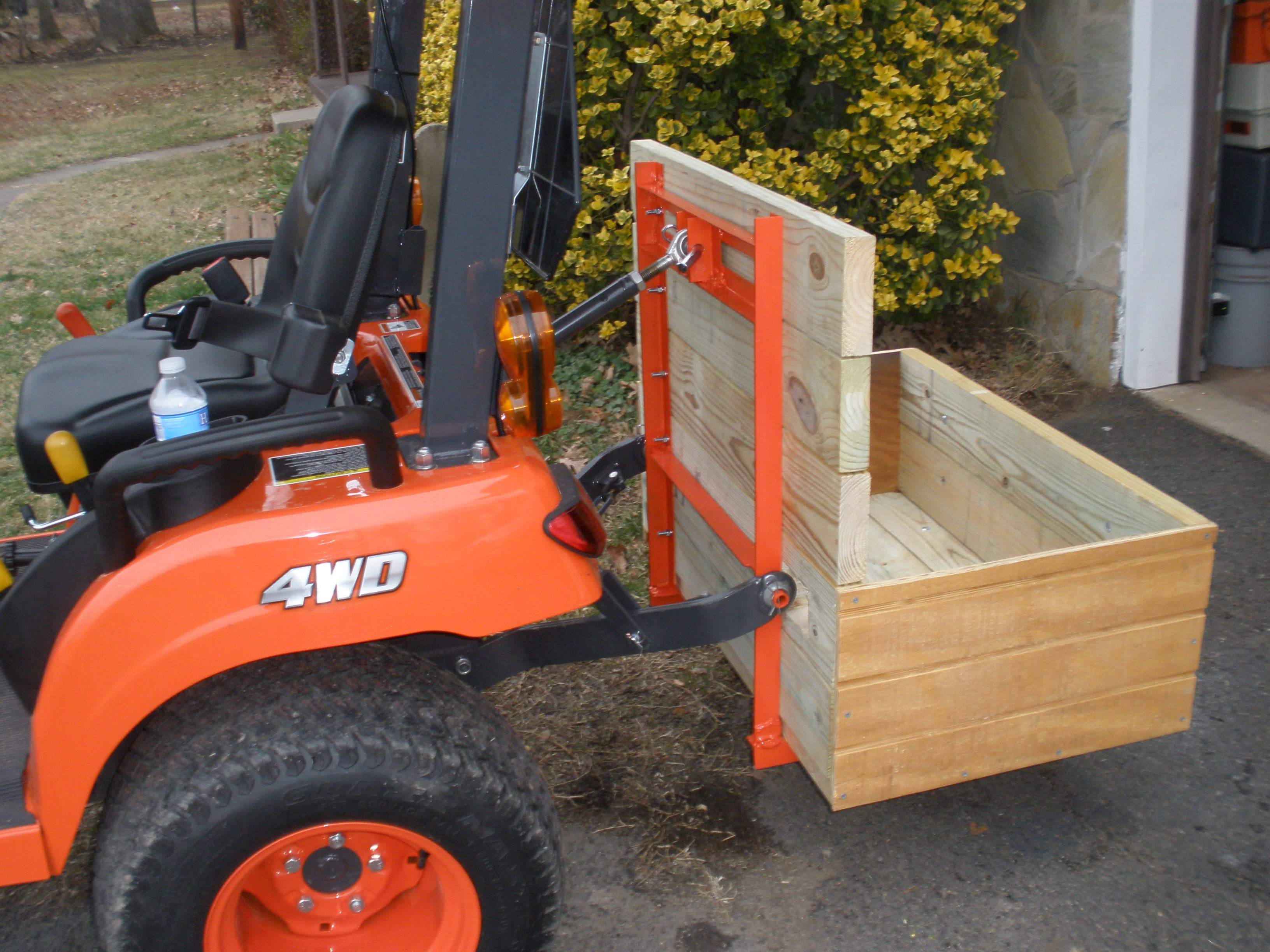

I put this together this weekend. The hydraulic top cylinder has an 11" stroke to it- 18" would have been ideal, but I got tired of looking online. I made the difference up with a couple of pieces of flat stock which I drilled out. I'll get some new pins and work out some spacers still. The carryall will have sides and a front of 3/4" plywood. I'll use some inside angle iron for reinforcement probably. I'll use wide tin or aluminum flashing on the wood. This will be for horse manure in the winter, and I want it to slide off easily. Manure will freeze to wood.
View attachment 346363View attachment 346364
Just looking at the pics- I had the thought that if I put a horizontal bar through the two holes above the old side pins, I might be able to attach the top link (minus the brackets) to the horizontal bar. That might give me a better dump angle. I have to look into it.

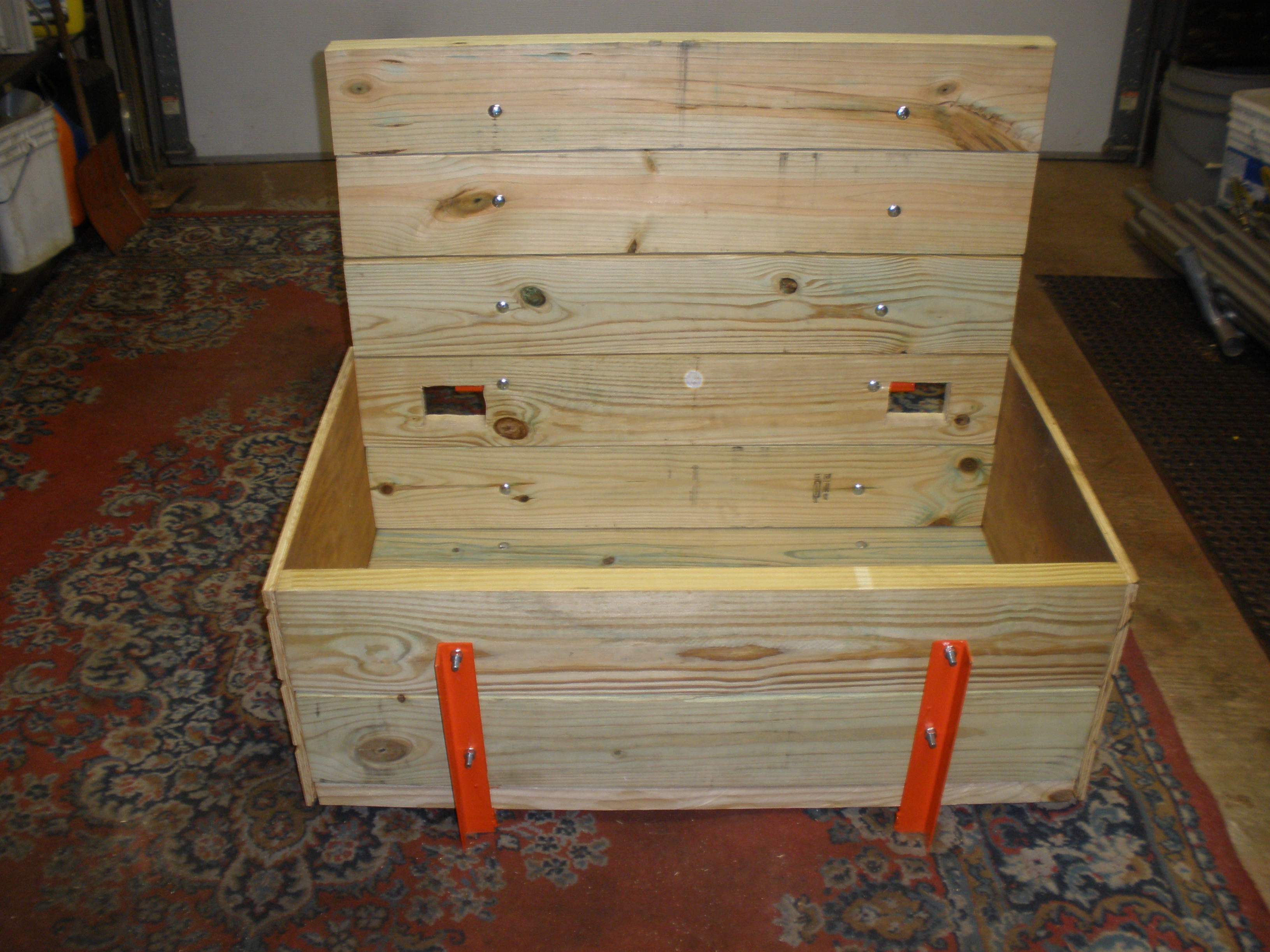

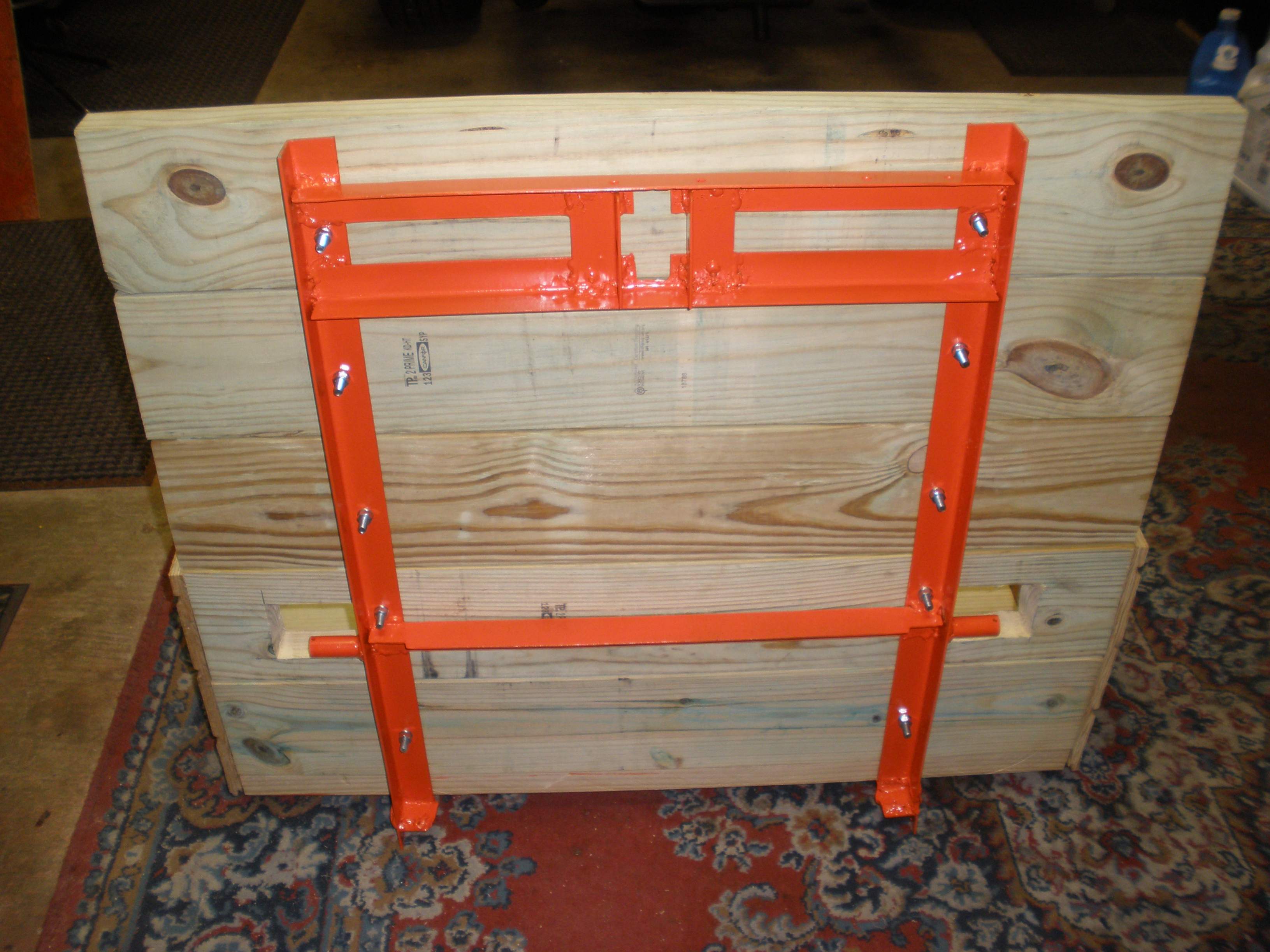

/ Carryalls #28

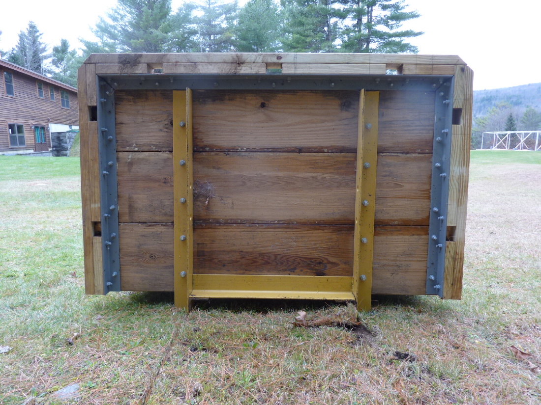

I built this one last week out of some poplar 2" boards I had. The TSC frame was $129. Coated it with some deck water sealer.

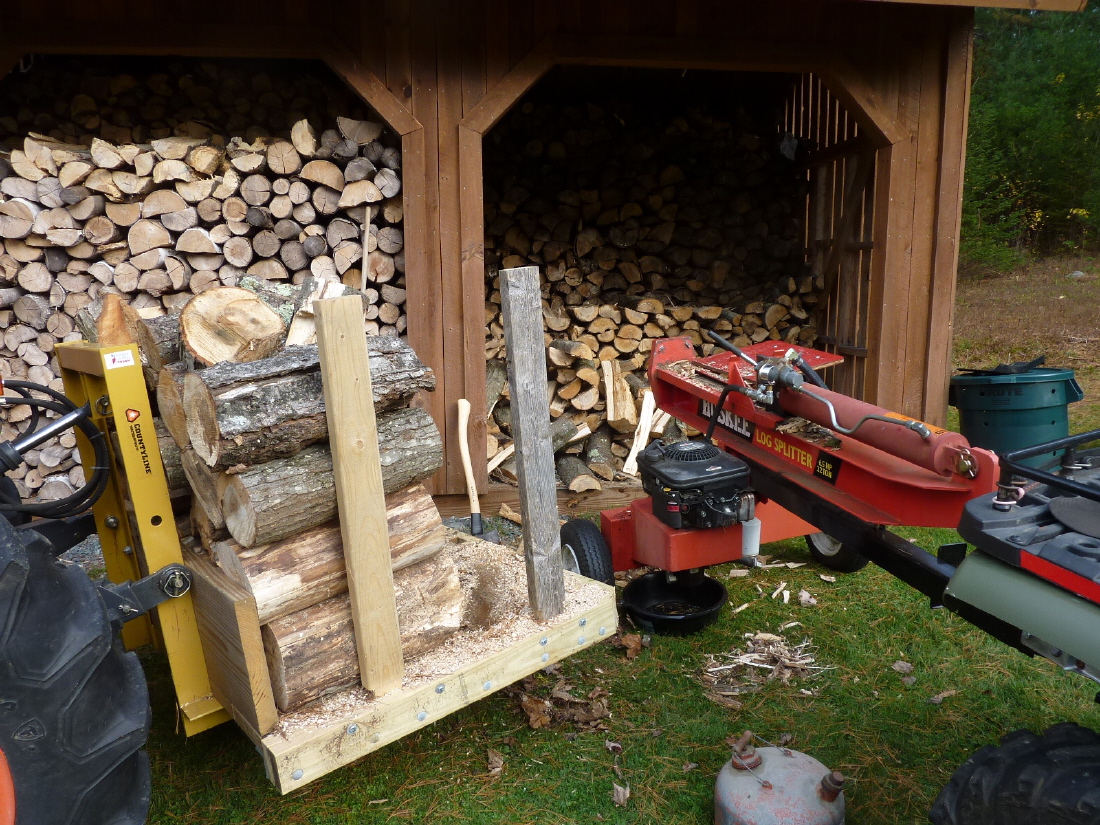

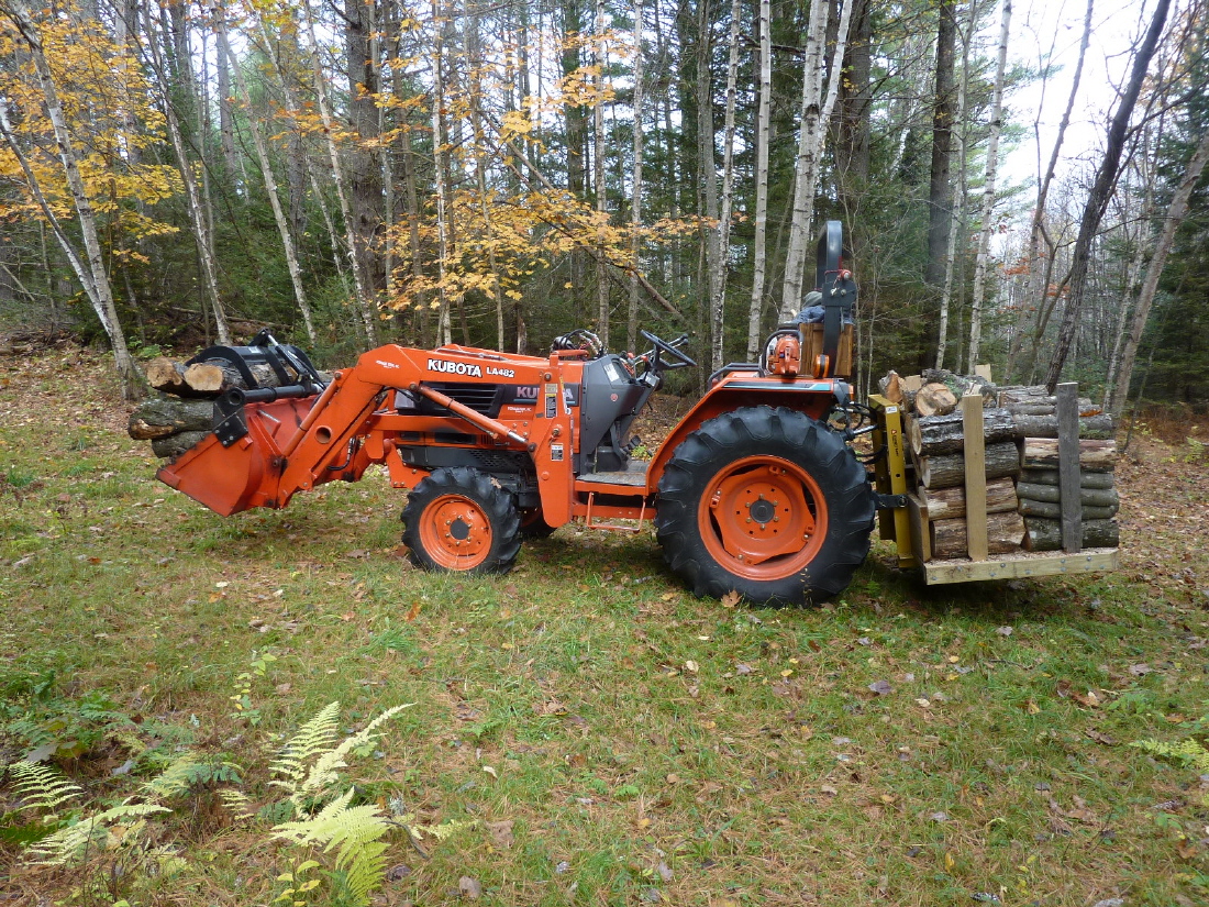

/ Carryalls #29
Here is mine in action. I cut up a few tree tops that came down last winter and hauled them over to be split and stacked for next year or the year after.
