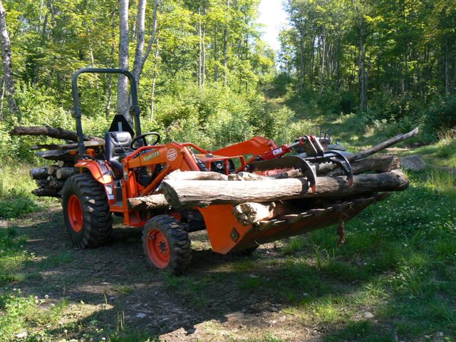

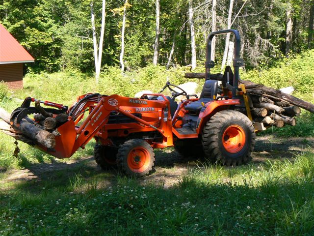

Before I got my B7800 I use to drive my 4x4 up my hillside, buck my maple logs with my Husky chainsaw, fill up my wheelbarrow, wheel it to the truck and throw them in the back of the truck, drive back to my wood shed, get in the bed and throw the logs out and then split them with my maul.
Now I drive my tractor up the hill with my chainsaw/gas/water etc., on my carry-all, pull the logs out with my sling choker hooked to the drawbar, cut the maple logs into 4 to 6 foot lenghts and then pick them up with the bucket/grapple as well as the carry-all and then bring them intact to the wood shed where I buck and then split them. A whole lot easier, more efficient and cleaner for the logs. Some day when I am too old to swing the maul I will buy a 3 pt or gas wood splitter.
Here's how I spent my day-see pictures

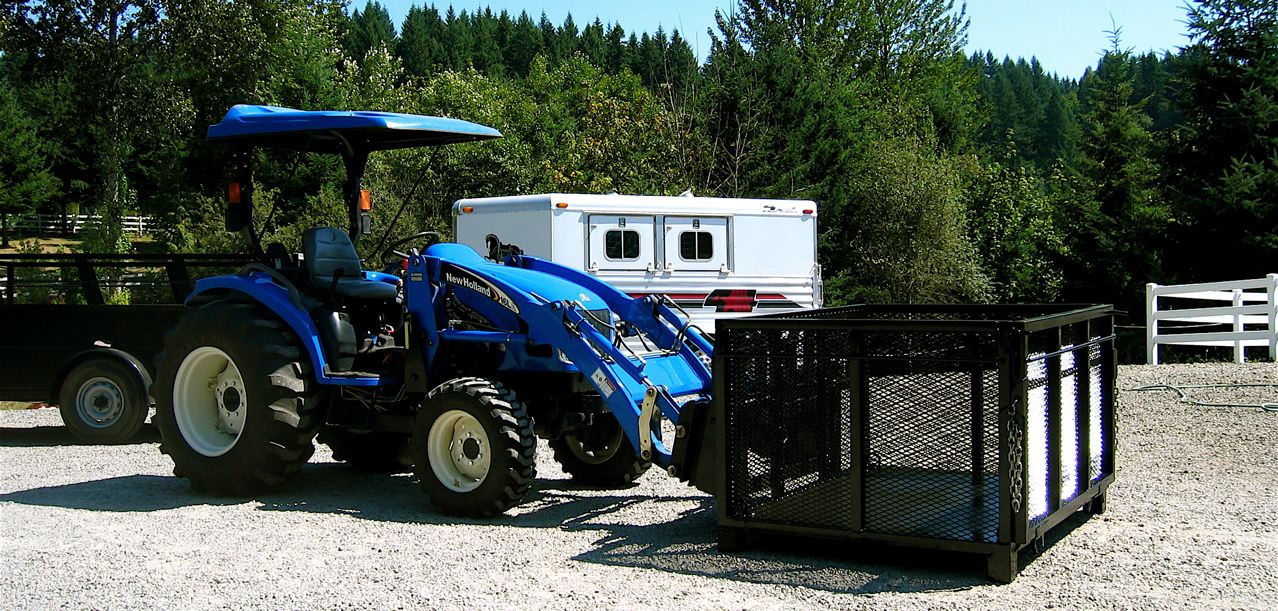

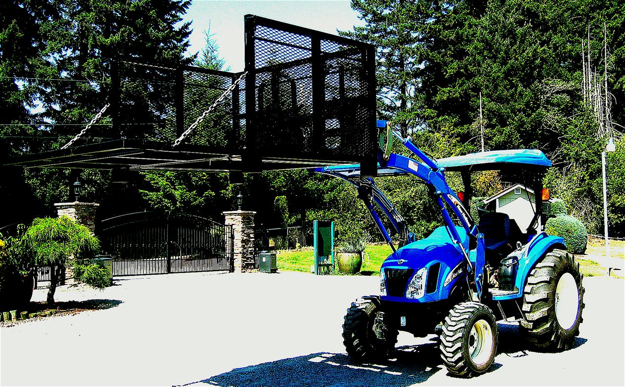

I am not sure what I have is called carryall but I named it FEC for Front End Carryall. It was delivered today. It can carry all kind of stuff from firewood, forest debri, to grandchildren. It can also used as a work platform for triming tree branches or blackberry picking. Here are couple of pics of my new FEC......

Just curious, I've been strongly advised not to use a FEL as a "cherry picker" because it would be dangerous if the hydraulics failed. OK, not likely that would happen, but it certainly could. This box is VERY cool, I like the FEC name too. Are there similar safety concerns there? Let us know how you like it. I may have to add that to my growing list of stuff you just have to have! :D Oh yeah, and where did you get it?
   / carryall use #50
Ideally, any hydraulic lift for humans should have check valves, like the pilot check valves on a top n tilt. This way, should a hose blow, the check valves will keep pressure in the cylinder, and keep the man from slamming to the ground.
A small leak in an unprotected system may not be as catastrophic, as it would tend to lower as the fluid/pressure leaked down. A blown hose is a "Zero" leak, and you would pretty much drop like a rock.
