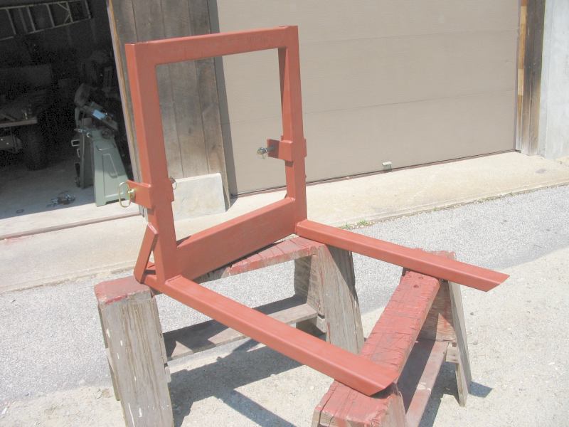

I bought a set of plans from www.how-to-plans.com and built several according to them. I also built a much heavier duty carryall that was based on those plans. If you have access to steel and can weld, they are very easy to build and can be done in an afternoon.

Great tool there Mad!
Will it work as you built it to move pallets (asuming you stay within the weight limits)?
One of the things I've see other places is to have a flat bed surface, and then have "stake holders", like on a trailer frame, around the perimeter, so you can add or remove sides on the carryall. I always thought that was a neat idea.
ron

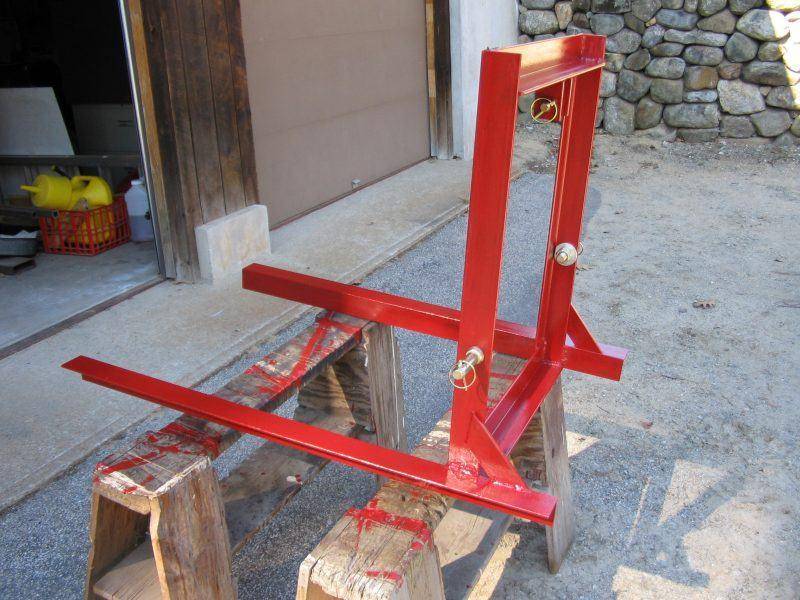

</font><font color="blue" class="small">( Will it work as you built it to move pallets (asuming you stay within the weight limits)? )</font>
That design using 2.5" x 1/4" angle is good for 700-900 lbs. I built a similar one using 2" x 3" x 3/16" rectangular tubing that is probably good for 2000 lbs. They move pallets that are within the weight range quite well.

I've never thought of using a carryall for skids... is this practical if you DON'T have a hydraulic toplink to easily keep it level or tilt it as needed?
I recently got a set of "real" forks for my FEL, but sometimes I have two skids to move and don't know if a carryall would work for me.
