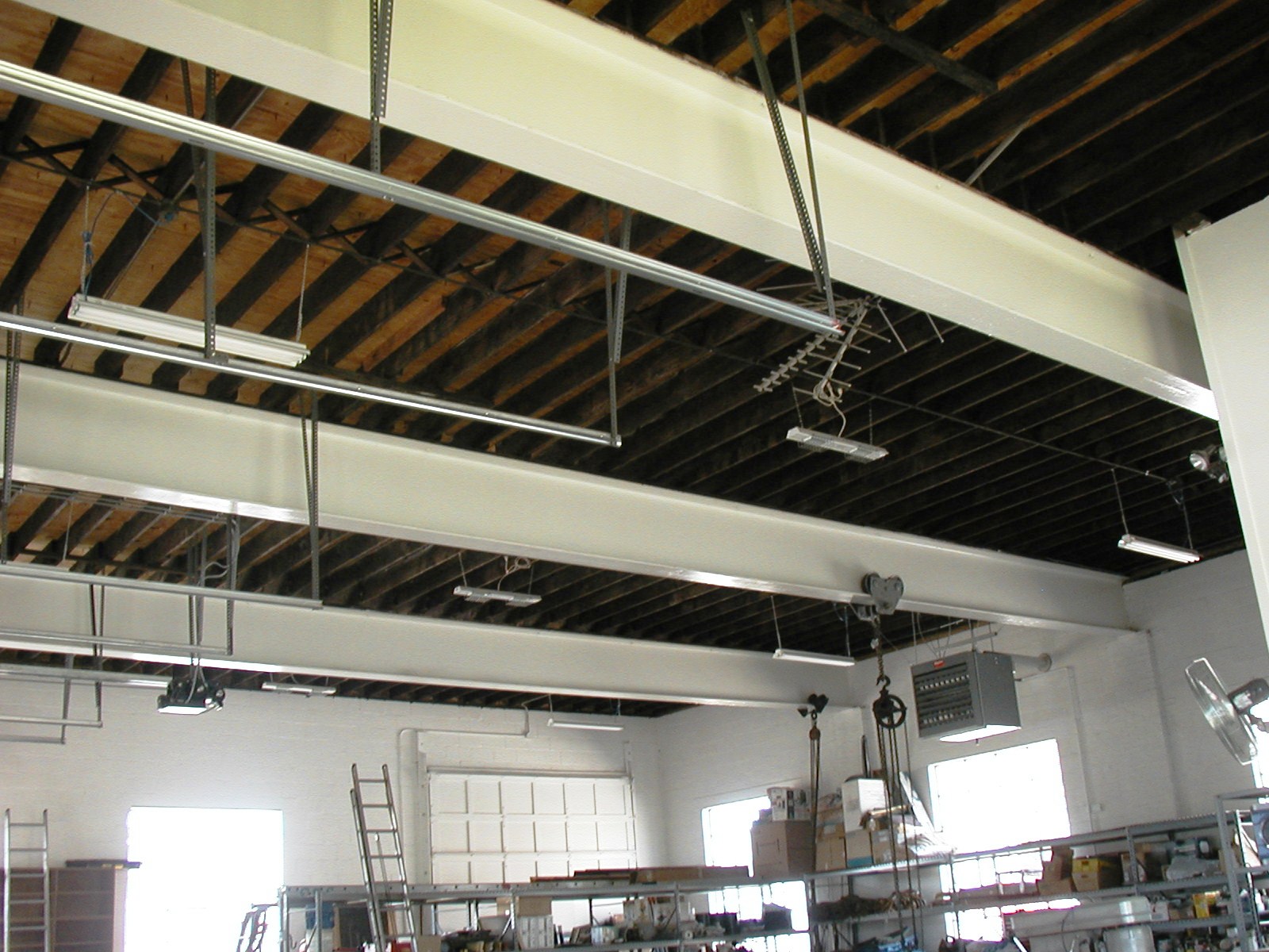

All my use of ply wood is for my own projects, so yes I will spend a couple bucks more a sheet. This pic is of my biggest decking (redeck) project ever. 3,000 sq ft flat roof, 18 ft high ceiling. It was my own shop, so I used 5/8, since carpentry is not my strong suit I did struggle with it. Afterwards I actually thought to myself maybe I should of gone with 3/4", not necessary I'm sure.

If we are sheating directly over rafters we use 1/2" plywood with clips. I will never use OSB on a roof unless its going onto the old roof boards. So many roofs around here get ice backing up under the shingles and we get called in to repair them and the OSB is usually shot from the ice/water sitting between the wood and asphalt shingles/felt paper. The plywood roofs will take a lot more water abuse then OSB.
OSB will work but does sag on 24" centers here. I just am not a fan of OSB and will only use it if there is a solid deck under it on a roof. If you insist on using it directly on rafters go with 5/8's with clips minimum.
