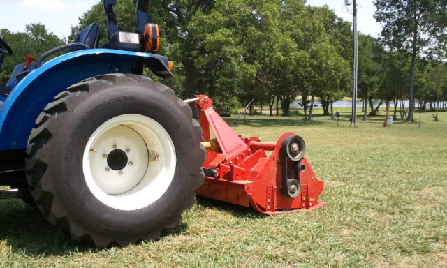

xtn, I have to try that configuration out the next time I mow. I have been leaving the bottom links double pinned and using the slot for the top link. I have many dips and mounds in the area I mow and in this configuration the mower rocks back and forth quite a bit. And you say to leave the position control all the way down (forward)? I've been leaving mine in about the middle simply because I didn't know any better. Thanks for the info!
   / Caroni TM1900 question...
#13
When using the slot to let the top link float as you have been doing, and as apparently most owners on this forum have been doing, you do need to keep the position control up to hold the front of the mower off the ground.
In my configuration, the top link is extended to serve that purpose, freeing you to give up control of the lower links and let them float all the way.
Please try this out yourself and report back. I would like to know if you find it to work as well as I do.
Set up on level ground. I used my concrete parking slab so I could see the angle/spacing very well without grass being in my way. Drop the mower all the way down, then extend the top link until the mower is resting only on the rear roller, with the front of the skids angled up a bit as I've described. Don't forget to remove the forward pins from those lower swiveling mounts so they can actually swivel. Now you're ready to mow!

I have one picture in this thread. There are several other pictures scattered around the forum that you can find if you search for the word Caroni and read some of the threads that turn up. I'm happy to post a close-up picture of something specific if you ask.
