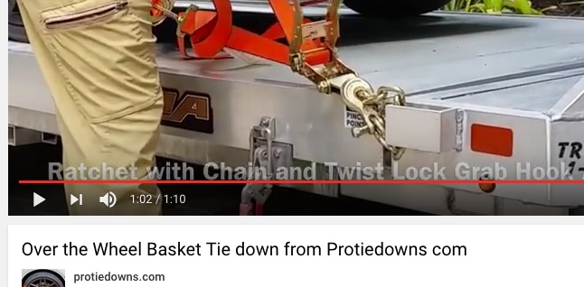

Wheel nets or straps through the wheels are by far the best options.
   / Car trailer lock down system #8

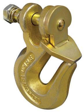

Here is a video showing someone using a wheel basket with a clip type ratchet strap and a chain type ratchet:
Aaron Z
   / Car trailer lock down system #10
Aaron Z
He needs to learn how to use a stake pocket and a chain!
