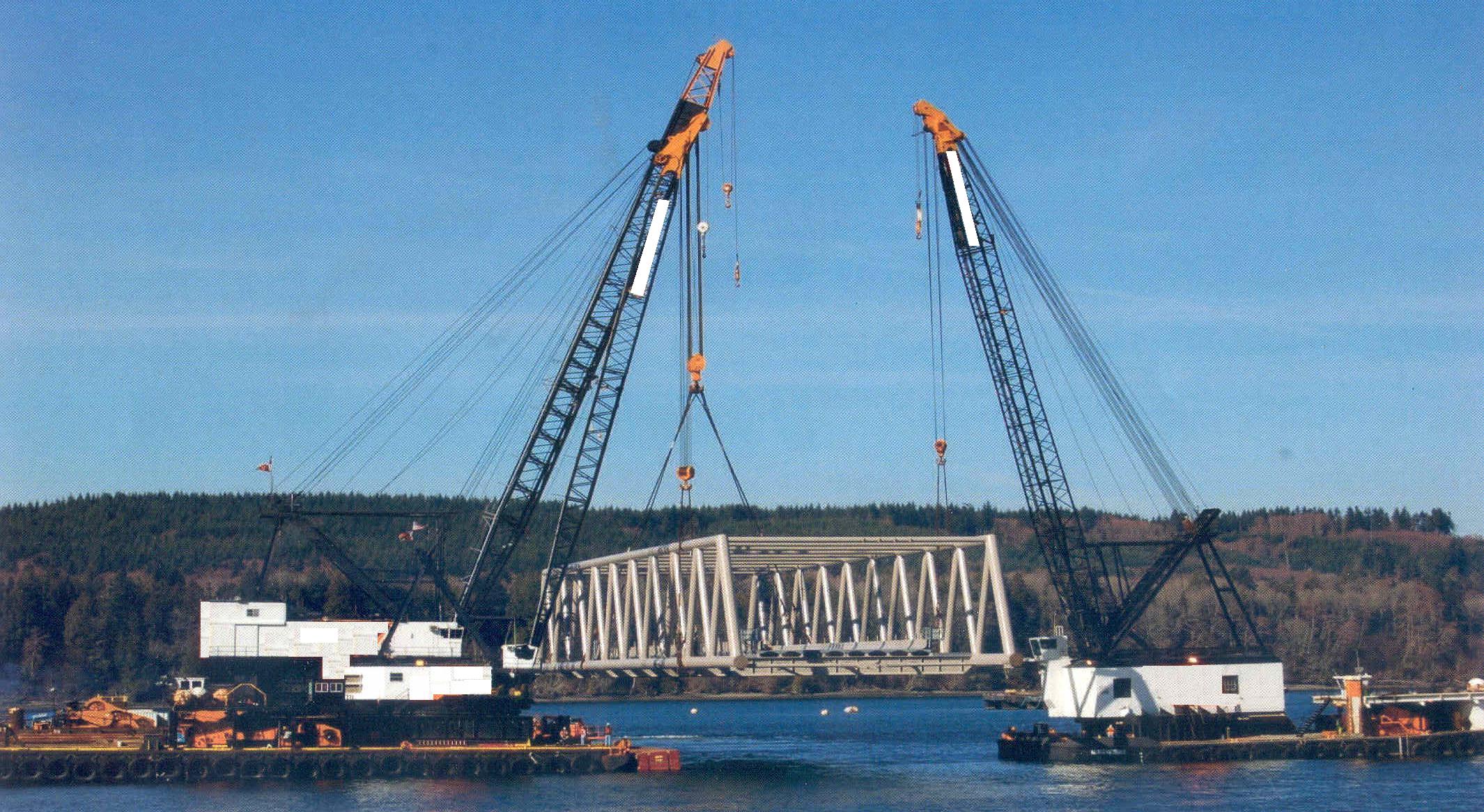

Honestly, I'm not much of a weldor! I worked way more years as a rigger than a weldor.;)
