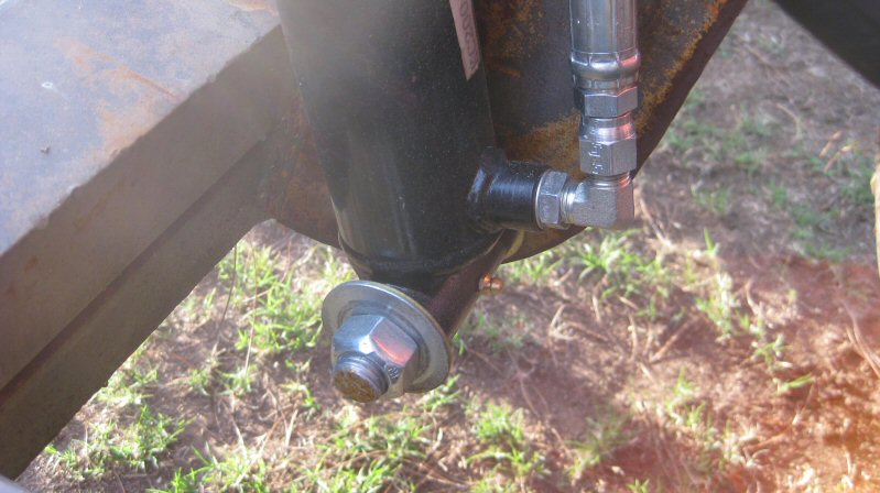

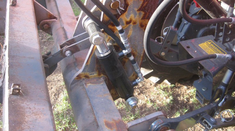

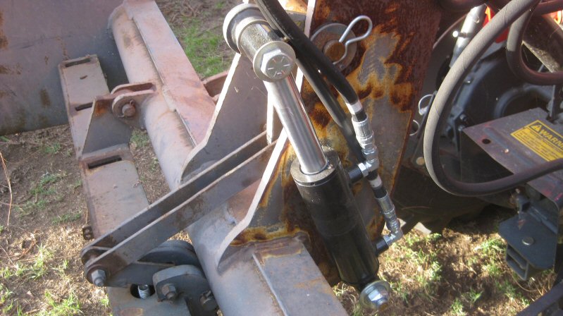

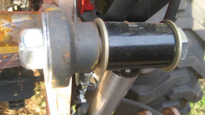

For Murphy or anyone else, here are a few pictures of what I did to change the manual ripper bar of my Gannon box blade over to hydraulic actuated.
Removed the spring assist, only had one side that was any good anyway and removed the manual control lever. Installing the hydraulic so that it is doing what the manual bar was doing, so should workout fine. :thumbsup:
Cut off flush the 1" pin that is welded in place that the manual lever was pinned to and allowed the manual lever to actuate the rippers.
Drilled out that pin to 3/4" for a 3/4" grade 8 bolt that will hold the rod end of the hydraulic.
Used some washers to go between stationary surfaces and the tubes at both ends of the of the hydraulic.
Also custom made some 3/4"-1" bushings to fit in the tube ends. They needed to be just a bit longer than the tube ends to allow for free movement of the cylinder.
Had the ripper bar blocked up in the fully raised position with the stop up against the mast.
Hung the hydraulic fully extended on the 3/4" bolt that was the pivot point of the manual lever that actually moved the ripper bar.
Rotated the hydraulic forward and back to find the best positioning for the stationary end of the cylinder. Don't want any binding with the movement of the cylinder as the ripper bar moves.
I tried this in several locations by clamping the stationary end tube of the cylinder to the mast, and moved the ripper bar up-down. As a side note, the plugs in the ports of the hydraulic cylinder need to be removed to easily allow full range of movement of the ram.
Once this lower pin location is found, the hardest part of this whole deal is at hand. To get a 3/4" hole drilled in the mast, sounds easy, but there is not much room there to get this done.
I ended up buying a Harbor Freight 90* electric drill to be able to get lined up straight. Drilled a 1/4" pilot hole and then used a 3/4" step drill to finish it. Step drill because they are so short worked quite well IMO. All of my std 3/4" drill bits are simply to long to be able to get a straight shot at the location required to be drilled.
I also used flow restrictors to slow the bar down so that the ripper bar does not slam up or down when actuated as is a common event without.

I'm gonna throw a bunch of pics on here. Then Murph can question what he does not understand.
I think Brian's setup is better than mine. His cylinder is out of the way. My cylinder was located by the previous owner. So I continued his build.
His problem was that it would break the cast iron latch when he activated the cylinder. That was because the latch hook was used to lift the scarifier beam. That's why I added the chain. The linkage first pulls on the latch hook to unlatch it, then the chain comes tight and the chain lifts the beam.
Please excuse my sloppy work. I wasn't sure it would work so kinda cobbled it. Works like a champ and I've not took the time to put it back in the shop and refine it.
I cannot figure out why Brian's works without something similar. If you look at his pics, his latch hook lifts his beam. The latch hook is very narrow in the middle where it swivels, that is what was breaking on mine. Maybe Brian's does not break because his cylinder maxes out before the beam is all the way up?? I know my cylinder never maxes out in either direction. I'm only using about 70% of my cylinder throw.

The guy I bought mine from had rigged up the cylinder and then quit using it because it kept breaking the hook. Rather than reconfigure the cylinder I just added the chain to take the pull off the hook.
