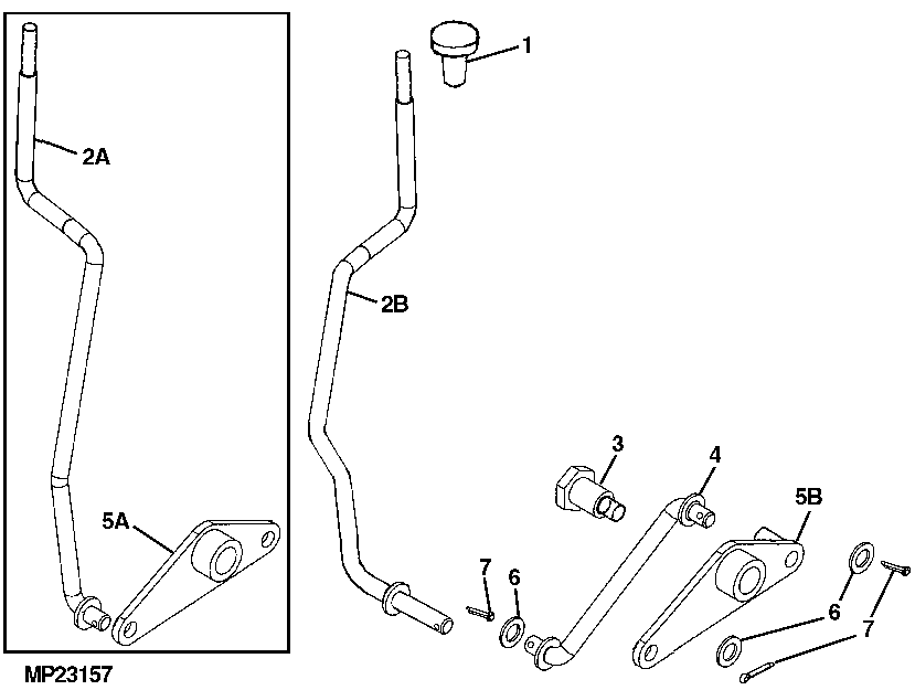

We have a John Deere 4200 that we have had for a few years now. When we purchased it the tractor it came with a mid mount mower but at that time we were just beginning to landscape our property, now that we are in need of the mid mount mower we can't seem to get it to engage. Hopefully someone out there can give me some advice because 3 acres of yard takes a long time to push a mower around (lol). Thanks a bunch .......Tamra F.
   / cant get mower to engage #2
Are you pulling up on the mid pto yellow knob with the rear pto lever in the brake position? Then engage the rear pto lever. Both rear and mid pto should turn on.
   / cant get mower to engage #3
Yes, you must first pull up the mid-PTO selector, it's down but your right heel IIRC. Then engage the rear-PTO.

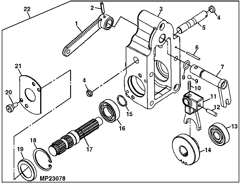

Hi ....thanks for the replys but I have been doing this and the knob won't come up.......any more ideas? Tamra
   / cant get mower to engage #5
It may be froze up where it enters the differential. Soak the area with pb blaster and work it back and forth to try to free it up.
   / cant get mower to engage #6
This is what your dealing with:
