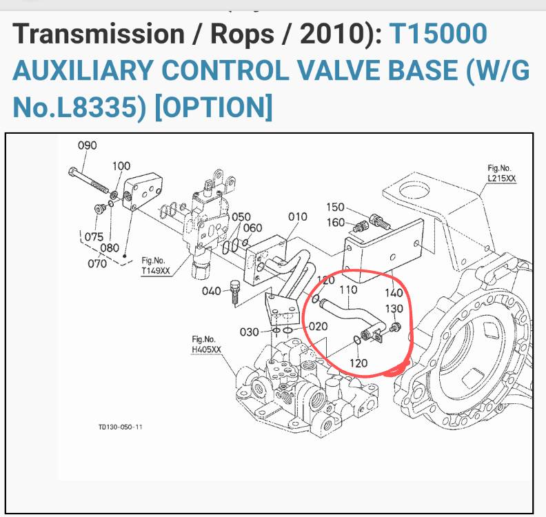

Good point, I was looking at the valve backwards.
About the only option I see would be to cut line 110 in this diagram and put in a compression tee:
Aaron Z

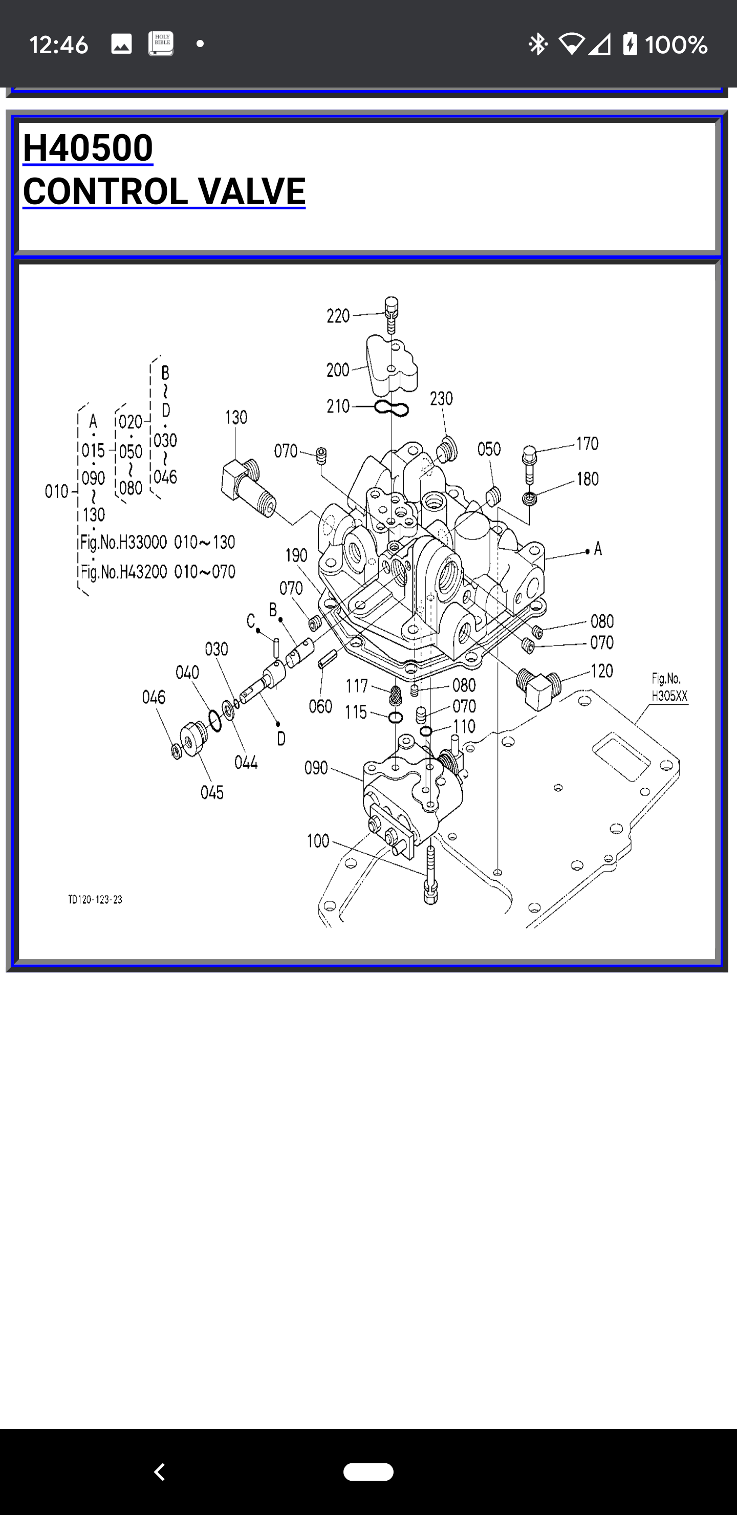

While I don't have exactly what's in your picture (it's an option), I do have the same base. We may be onto something. I don't have line #110 but I have a plug #230 right there. So if that indeed dumps to tank, that would work. I could maybe even purchase that line #110 and then tie into it. The hole is smooth bore and the plug just pushes in. Here are my pictures. Also, not the biggest hole so I'm wondering what it needs to support as far as flow.

If you use a valve with a PB port you can plumb the tank port into a tee in the tank line from the loader valve. Assuming it has one, some don't.
It doesn't, which is the problem.
Aaron Z
Excellent catch. This might work. As the OP said, he doesn't have rear remotes now, so that port is plugged and available.
Doesn't need to be big. Buying that hard line and having a JIC flare brazed/welded to the end would work.

Take plate #200 off that might be where it is to hook into.
   / Can't find tank return line #27
Re: Can't find tank return line L4240
If you look at Aaron's picture, you will see only two of the three necessary lines go through where plate 200 is. The third line (tank) goes where we are discussing. We know its tank and not P of BY, because when the rear remotes are not installed, a simple o-ringed plug caps it off.

The is about all I can find for pics. A couple drawings from Kubota website of what I believe is the right valve. The spot that was curious to me in the drawing was the O ring. Wouldn't need O ring just to bolt on a valve to the side of the case. In thinking maybe that's the passage for the fluid to tank? One of the drawing shows where the pressure relief is. As for my pictures. I got a view of under the seat, a side view, and a shot from up underneath.

If you look at Brian's post 15, last picture, you see a view of the valve from below. There is no return line like your reference shows. The bolt you see is the pressure relief valve, not an unused port either. However, it would be worthwhile for Brian to see whether there is an unused port on the transmission where located on your referenced part list (option 5 drawing).
