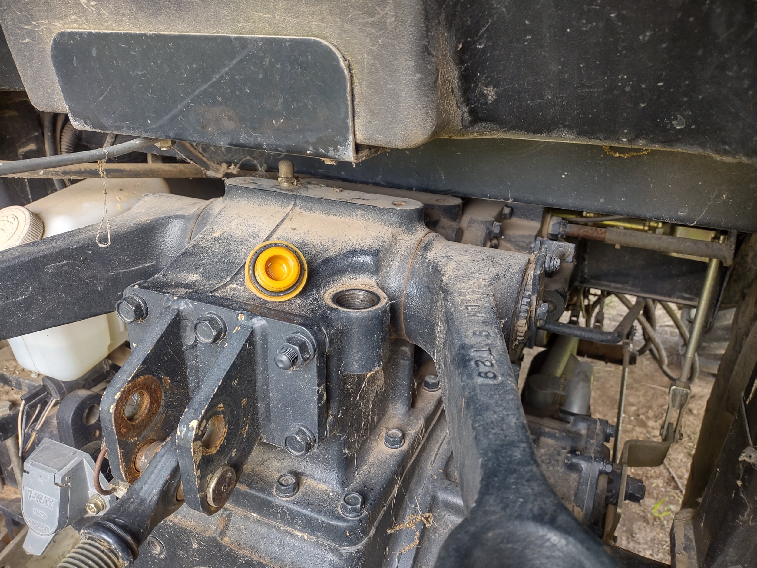

It is on a 2010 New Holland T2410. I have a service manual and an operator's manual and have looked everywhere online with no success, so I'm hoping to tap into the knowledge here.
The operators manual shows the hydraulic fill plug to also be the dipstick, but I only have the fill plug with no dipstick.
If I stick my finger down that hole, should there be fluid that high up?

No idea on the NH but I very much doubt you would be able to touch the fluid AT CORRECT fill from this hole.
Look around the feet area and under the seat for a dip stick. Have seen them on the back of a transmission.

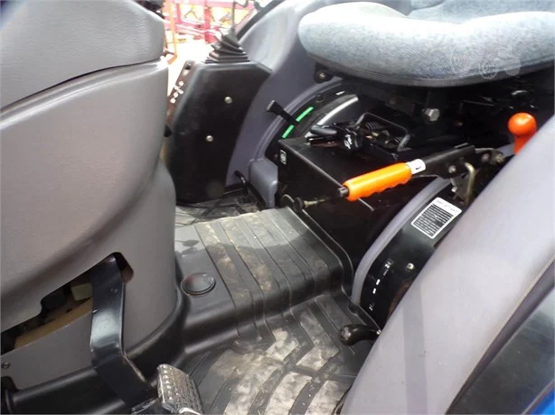

You shouldn't need to pull anything out. Have you check the parts diagram? Looks like it's located somewhere in the footrest area looking at the parts diagram from Messicks.
Looking at some online pictures, I see a round plug. Have tried pull it out and see if the dipstick is there?

That's it!
Thank you so much.
Silly thing for me to overlook.

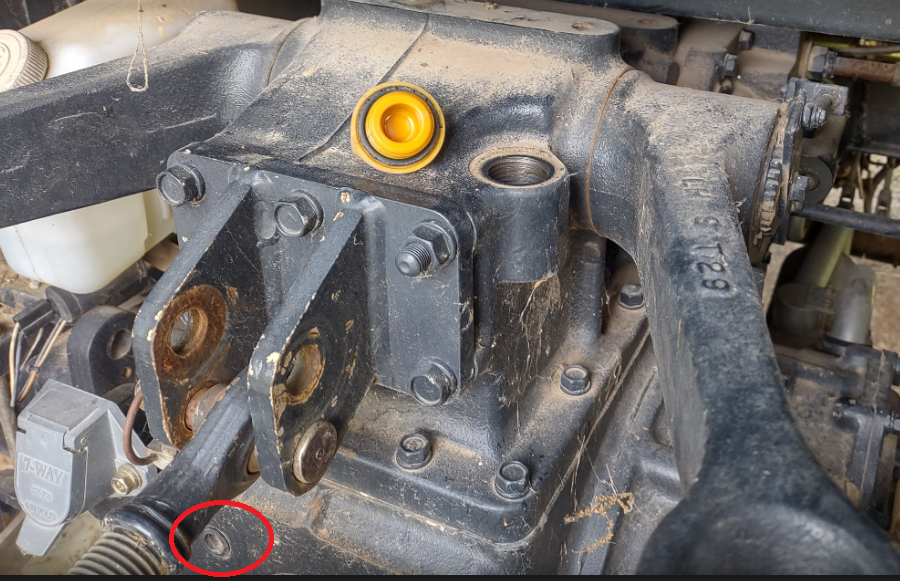

you should have a eye glass by the three point most tractor are like that ... this is from your picture looks like it right there.
   / Can't figure out how to check my hydraulic fluid level. New Holland T2410
Appreciate the tip. That is a top left threaded hole with a plastic plug.
4 similar holes total resembling the 4 corners of a rectangle.
