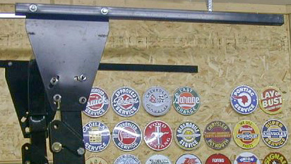

I am interested in making my own canopy from diamond plate aluminium. I borrowed a picture from Pineridge showing some canopy supports and that gives me the basic idea but I am still being lazy. /forums/images/graemlins/smirk.gif Can anyone measure the height width and thickness of the side plates and the dimensions and wall thickness of the long supports. I tend to overengineer sometimes and that adds more weight than necessary. Thanks.

Marty when I go out to the barn tomorrow I'll take some measurements for you and get back to you then.

glad to see you on-line. I have one other question, there is enough detail in your photo to show the tilt adjustment feature. Did you use this? I was inclined ( pardon the pun) to tilt the front up slightly so I woudn't end up with rain dropping all over the steering wheel. Any directions or preference on this adjustment? I am going to try and make my frame flexible enough to add lights now and maybe attach homemade cab sides eventually, but that is down the road. So many ideas, so little time.

Marty since I took the original pictures I added length of angle iron between the side rails in the front and in the rear. I plan on mounting some high intensity lamps pointed in both directions.
The top can be easily adjusted so that it pitches backward shedding all rain behind you. When I got it from the dealer it was set up dead level. After a good rain I jumped on the tractor moved it a couple of feet and when I hit the brake all the water from the rain channels came down in my lap. I was soaked & cussing for an hour. I now have an open drain hole on each rear corner of the drain channel. Trust me water running off the back is a lot better.

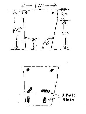

Marty attached is a hand drawn picture of what you will be needing to help you complete your project. The rails are made from 1-1/2" X 1-1/2" X 1/8 " tube. Each is 40" long but you can adjust that length to suit your top requirement. The two side plates are cut from 1/8" stock. If you have any trouble locating the U-Bolts you can purchase them from Firebird Fiberglass who also makes the tops. Firebird Fiberglass
If I can be of any further help just shout. Good luck with your project.

That's exactly the input I needed. I spied some thin diamond aluminum at the surplus yard last week, sounds like a road trip /forums/images/graemlins/cool.gif /forums/images/graemlins/cool.gif The diagram/ measurements are just what I needed. I would have/may still go a bit beefier depending on what I find available. I really plan to use it more in inclement weather so I want to think hard about how I might intregrate some homemade cab sides later. The trick about adjusting the tilt was obvious in the photo, I am sure I wouldn't have put that in homegrown design until I saw it. I am still thinking about how I might put some bow in the top given the way I was going to bend the aluminum /forums/images/graemlins/confused.gif Looks like a long cold winter up here, so I have some thinking time anyway. Really appreiciate all the help! /forums/images/graemlins/laugh.gif
