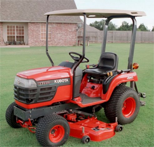

Hate to tell you this....but the canopie you are referring to clearly mounts over the top of the roll bar. The mounting brackets mount in front of the roll bar. I, on the other hand used a readily available top (not designed for a tractor) and made my own mounting brackets. It is supported at all four corners, is extremely sturdy, works like a Champ and the total cost was much less that you would spend for a cheap top. However, when I do a project like this, I never count my labor as added cost. Also built my own FEL, 3pt forks, 3pt reciever hitch, front bumper with reciever hitch and added rear hydraulics. I'm currently building/frabricating a hydraulic top link as well as Tilt. Oh yeah, I'm also just about to finish up my 110 gallon spray rig with PTO powered pump and 14' break away boom with hydraulic lift of the outter boom arms. Oh well, got carried away. Why don't you run down to EZGO and look at their Golf Cart tops. If you can do some fabrication, you'll be able to save some money. On the other hand, I've got a few extra sets of brackets that will fit a Kubota BX2200.

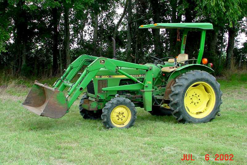

Something to consider is head clearance. My canopy on my JD950 mounts on top of the ROPS. I am fairly tall (6-4+) and I have very little head clearance. In fact, if I bounce over some rough spots while moving fairly fast, I sometime bump my head on it. /forums/images/graemlins/tongue.gif A canopy that mounts on the front of the ROPS as shown in the web site you attached and was below the height of the ROPS would have me bending over to see out from under it. /forums/images/graemlins/frown.gif I think you would have to be rather short or have a really tall ROPS to be happy with that.

I saw your picture you did an awesome job looks like it was made for it. I can do some fabrication, but I don't have anything to bend tubing.
The picture on the sunguard model "as far as I can tell" looks like it mounts to the rops. It also looks like it could be slid up
or down within reason. Since it mounts in the front of the rops it could be adjusted at the same height as rops. Am I missing something here?
How much was that EZGO and how do you bend tubing? /forums/images/graemlins/confused.gif

Considering I am sometimes mowing with temperatures 100+ /forums/images/graemlins/shocked.gif , I consider it not only useful, but essential.
The bumping is not a real problem. It just happens often enough to remind me it is there. It just happens that one of the cross structural bars in right above my head. If it had been a few inches forward or back, I would have had a couple inches extra clearance.

Mainiak!, I'm not sure exactly how the Sunguard model mounts or how much adjustment is available. I just don't like the large (not to be confused with HEAVY) mounting systems all the top manufactures are using. Who wants all that extra weight up high like that where it is certainly not needed.
As for the bends in my front mounting brackets. I did a lot of cutting and welding plus a little bondo and primer to produce the proto types. They look excellent and worked perfectly. I have since redesigned the front brackets to clear the FEL on a BX2200...they are close....about 3/16" from the side of the firewall bulkhead and they don't start the outward bend until they are high enough to clear the loader valve.
I did eventually but a tubing bender. It's time consuming, but it makes nice bends...not something I would want to go into production with.....too sloooooooowwwwwwww. /forums/images/graemlins/confused.gif
