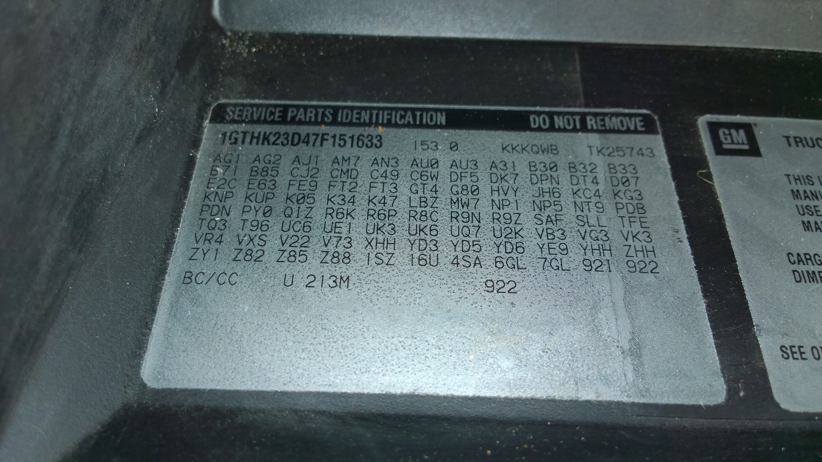

Anything on the build tag in the glovebox?

got that pic this morning.
   / can you tell the truck subtype trim package from the vin #?
that's the best focus / closest pic i can get, does that help anybody? i'm not sure which would be a trim code, or how to decode.
