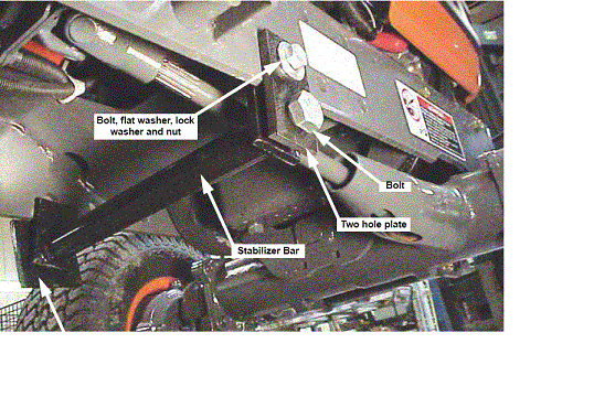

It is a 3-point mount. They have some brackets that attach to the rear of the frame that are part of their "stabilizer System" that helps take weight off the 3-point arms. They were suppose to be working on a subframe mount but I haven't heard anything more on that in a long time. For now the Woods is the way to go.

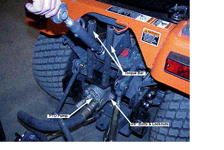

One more

Tom,
jrlichina is correct it appeared to be a modified attachement to the 3 point. I did not look it over very carefully just mainly noted it next to the BX23 and did a 3 minute look over. I did not notice the separate pump that jrlichina noted, but wasn't looking that carefully as stated above.
