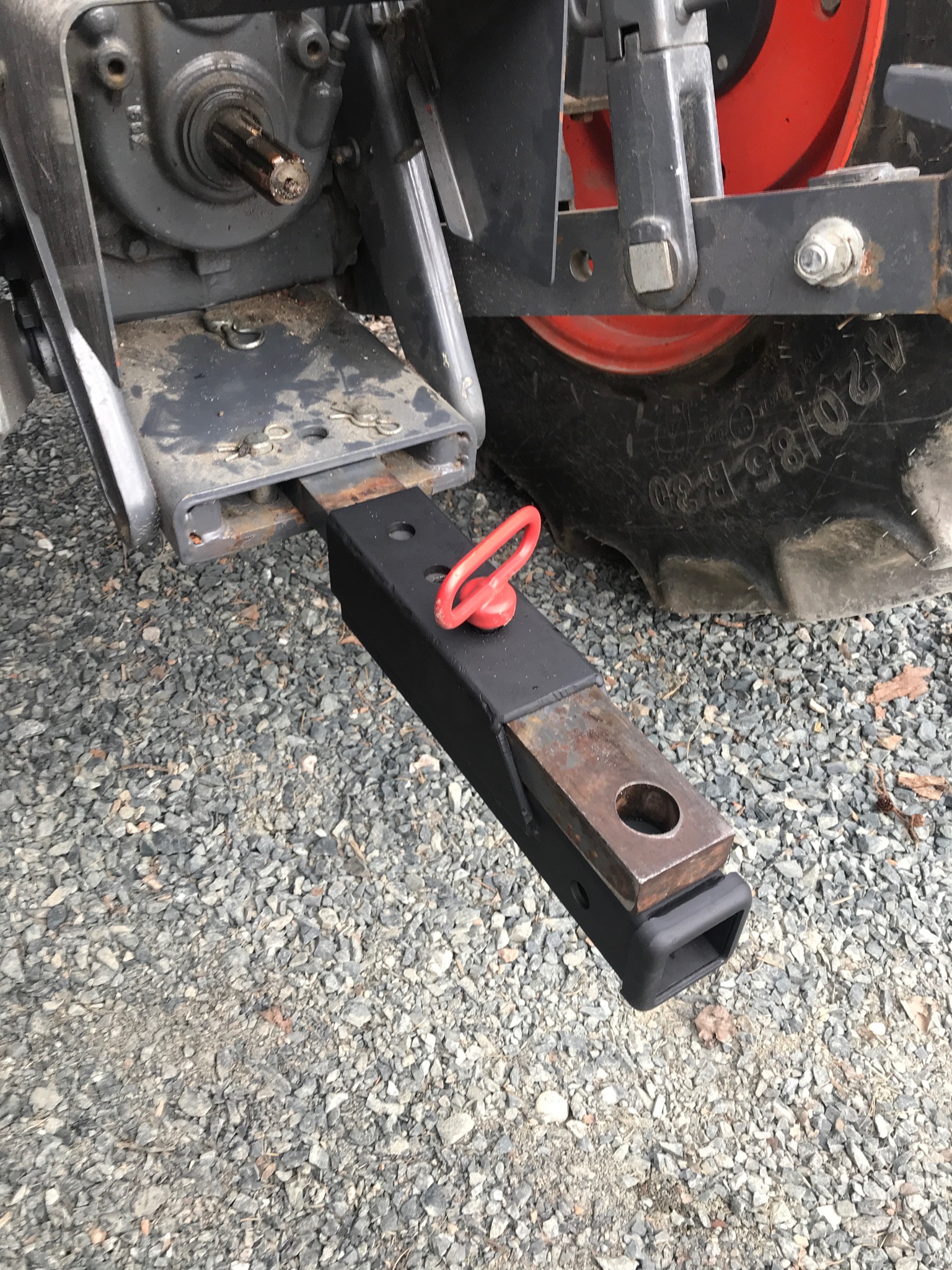

I pull a 6x10 dump to deliver firewood. I have used the 3pt hitch but prefer not to. I did not use the limiter chain idea others have suggested. Once the trailer did lift the hitch up and it was not a nice feeling. I would not trust it on the highway.
A friend welded this up for me. It slides over my drawbar. I then use my 2 receivers.
As I have my dump trailer plumbed into the tractor for hydraulic power and the light plug, I can稚 simply use the 3pt anyhoo for quick and easy moves unless it痴 just in the yard so my adapter is only a few extra cranks of the jack. I road travel 5-8 miles one way many times a day some days, 1 cord at a time.

Not sure why, but i cant see the pictures you attached.
