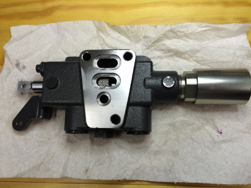

The float detent caps/springs on my Kubota rear hydraulic valves are VERY prominent. Can't miss 'em. Big cylinders on the right.

Well "/Pine" I am new to operating backhoes and am in a steep learning curve. In the owners manual for this machine they talk about a float on the boom "down" position. Where it would be adventagous is in cleaning out the bottom of a trench. You would put the bucket flat down on the bottom and float the boom. Then just pull back on the "dipper" and adjust the bucket curl to keep it at the bottom. There are two advantages to this: 1) the dipper and curl have more available hydraulic pressure if they needed it and 2) it's easier. I didn't know this "option" even existed and I have been practicing this same movement using all thee modes or valve (boom, dipper and bucket curl) and getting pretty good at it. This only became an issue for me when I read the operators manual and they talked about this feature. Then I googled it and watched a YouTube about it and thought it was a pretty good idea. Well when attempted to put the boom into the detent/float position it would not go into that detent as the loader valve will do. Now I was concerned that I had a system on my new machine that was defective and didn't work. The book says it was there and but it wouldn't work. So I have been on a three day quest to find out what is "wrong" and why it won't work. You can not believe how many people, including the dealer that sold me the machine didn't know anything about it. Finally I came here with a generic question and you men nailed it for me right away. The option was obviously not installed in to this control valve. Yes the picture was poor but it was the best I could do and you can see - kind of - all the valve caps are the same behind the hoses. So for me the mystery is solved. The valve is work as it was assembled. The option of "float/detent" was not installed. Again you guys nailed it for me and thank you.
Thank you for the informative explanation...I can easily see where the longer the reach of a hoe the more this action would be especially beneficial...
My hoe has a short reach and maintaining a smooth ditch bottom grade can be quite taxing on my skills...
If you're interested...there may be a (float) detent kit for your valve... they are not difficult to install...usually access is the issue...

Well "/pine" you bet I'm looking for a kit. LS says there is not one available but I will contact some hydraulics shops and figure out what we can do. The valve in my hoe can't be that special. Especially when it looks like from the description in the book and the hydraulic schematic that there once was the float option. Putting it in would be easy too. Already figured out the moves. Don't even have to disconnect the lines. Unbolt the valve from the mount, lay it down, remove the control lever from the top of the valve, remove the cap and spring. Remove the spool and install the new parts and seals and your back on the streets again. If I can buy the parts I will have this option in my hoe. Plus for no other reason then to say I got it.
All you guys have been a HUGE help here and give me the confidence to get it done. Just need the parts.
