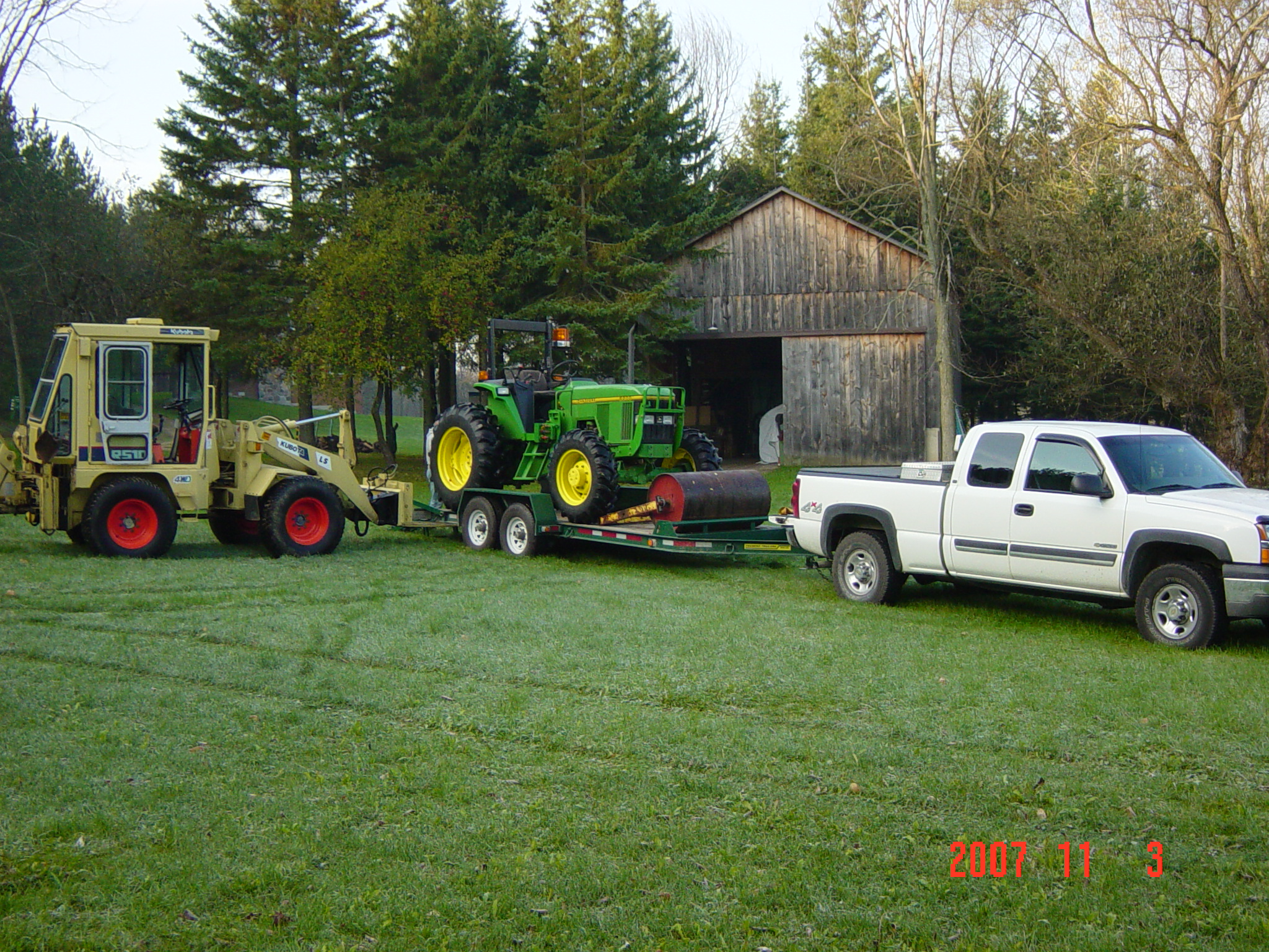

I thought I might have a picture. Well, it seems we could not get the BACK wheels past the fenders and put that roller full of gravel in the front for ballast. Funny the picture doesn't look like anything is really wrong, and yet the ride was quite unsettling.
That's a 3/4 ton truck. 8 lugs!
