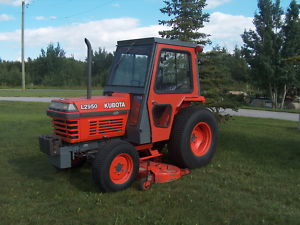

I'm looking at an L2950 that comes with cab, belly mower and 3pt hitch snowblower, but, no FEL. Was thinking that if I needed one I could add one but then realized that maybe it didn't have a loader as maybe the cab interferes with the FEL mounts.
Anyone have a 2950 with cab and FEL?

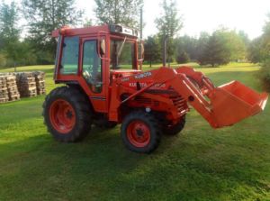

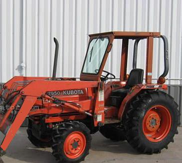

   / Can you add a loader to a L2950 that has a cab? #3
There wasn't a factory cab for the L2950. The most common cab on them is the Sims or Curtis with narrow windshield. There's no interference with a loader. There were a few wider cabs like Laurin's where a remote valve setup is needed but otherwise it is compatible with a loader.

Thanks for the replies. So what I'm hearing is that it won't interfere with the loader mounts but may need a different/remote joystick control.
Can you still get loaders for a L2950 new or just what I can find used?
Here is a pic of the tractor and cab.

   / Can you add a loader to a L2950 that has a cab? #6
Compare your pic with the ones above... I don't see the loader mounts working with the lower cab portions... Looks to be a custom built cab... I'd say no way!.
As for the BH, shouldn't be a problem... They either use a sub frame or the 3pt hitch...
   / Can you add a loader to a L2950 that has a cab? #7
......Here is a pic of the tractor and cab.........
Pretty unusual and unique cab design. Firefighter is right - looks like a lot of modification. If you are really after a loader and backhoe, you'd be better off finding a tractor that already has them. They are expensive new, can be very hard to find used, and fit-up is going to be a project in this case.
