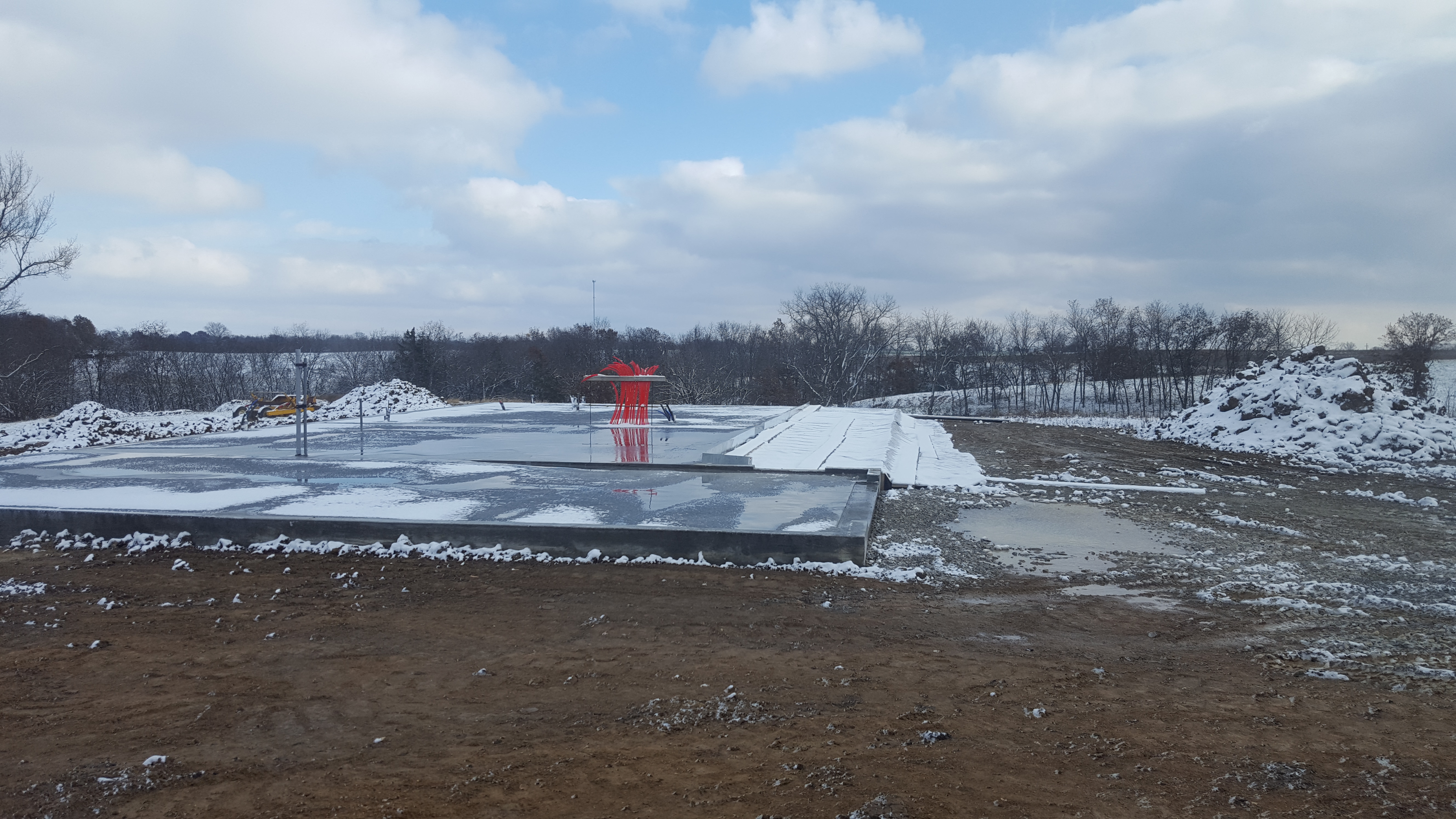

If a garage doesn't have a floor drain, when the snow/ice melts off the car, wouldn't the overhead door be frozen to the floor the next morning?
   / Can we talk about Concrete? #34
My current shop has no floor drain. No floor heat. Melt off runs under the overhead. It's never frozen. That shop has never been below 60F degrees.y
The shop we're finishing now doesn't have a floor drain. Has floor heat. I don't expect any problems.
The house we are building with attached garage doesn't have a floor drain. Has a 3" slope toward the overhead. Has floor heat. Don't expect any problems there either.
In attached pic, garage is in the foreground. Overhead exiting to the right. Look closely and you can see the floor slope.
