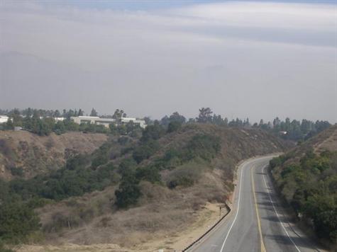

hello there!
I am interested in purchasing this land on the picture... problem is that the property has a steep slope facing the street and towards the hill is more of a gentle slope and it has a neighboring creek below it. the property is in southern california,can anybody give me a rough estimate on how much it will cost to level it... i am planning to build a prefabricated house once levelled. is it do-able?

If you're referring to the huge mound right next to the road to the left, I'd be surprised if it was allowed. I don't even know for sure what the reason would be, but, hey it's California - It's bound to be against some law.

YOu have to be careful. CA has stiff riparian laws. You can't move dirt on your property if it will adversely affect water flow over adjacent property. Disturbing the flow of a creek is a big deal in CA and can get you into big trouble with the law. You really need expert advice (geological, legal, etc) before you jump into this deal.

I can't imagine that being a viable building site, maybe not impossible, but definitely not cost effective.
Unless you mean just level a pad site at the top??

according to the realtor it can be rezoned from open space to what, i don't knw... the lot costs less than $50k. is there a way that maybe just the top can be levelled some to have a house built on it? will it cost more than $50k to have it levelled some?

Yep, like other have said, the minute you move a grain of sand you own the liability attached to that entire mountain.
If there is a rain and there is a mud slide that crosses the road and kills 20 people and, well you get the picture.

There are two types of creeks with two different sets of property development rules:
1. Year round flow
2. Ephemeral (seasonal) flow
You need to look into the laws regarding the placement of the septic system in relation to the creek. This could be a significantly larger hurdle than a grading permit.
Other types of home foundations to investigate for that terrain would be piling, stilt or pedestal foundations but only if the lot has a million dollar juicy view worth the money for that type of construction.

If you think free internet advice is unreliable, just get some advice from a realtor. For a starting point, I'd go to the building department with jurisdiction on that land and tell them you want to level it for a house. If they fall backward off their chairs laughing that's not a good sign. They can at least give you an idea of some of the leg-hold traps you're going to get into when you try.

if I were you I would not think about leveling all that out then building, I would build into it that way much/most of the home would be underground. leveling an area only big enough top park a couple 4x4 tractors/trucks on and hide in there IF you were going after it. to level that enough would cost as much as the property more than likely and the permits would cost half again as much as the property & construction.
this is from what I remember back in the early 90s of the CA laws. zoning then again may be an issue as well...

I agree with Nickleplate, Talk to the local building dept, they have the final word and you will find out in a matter seconds.
If it's zoned other than residential then I'd say it's a safe bet it would not be rezoned for you. You could always apply for a zone change but judging by it's appearance (looks like a scenic road) I think it would be a long shot.
As far as if you could build on top, sure if the building dept would allow you to perch a house up there, that would be doable. How many acres are there? The price is right.

Yes you can level it but you may not be allowed to do so.
Best be getting plans and permits organized.:D

There is a reason that the property is offered at a reasonable cost. IF you do some more research, you are going to find that it will be VERY expensive to do just about anything with the property. But to answer your question, yes it can be leveled, but at what cost? I can almost guarantee you that for what it will cost you to do what you want to do with this property, that you can find a different piece that is a nicer piece of property, end up with a better place for a lot less money spent in the long run. I would trust the realtor about 1/2 as far as I could throw them.

Homes in my city are often built on cliffs... stunning homes and very secure... they also have foundations and engineering that double the cost or more... as a general rule... it is easier here to build on a down slope because you are supporting the home... and not the mountain behind it.

As for actually levelling an area, if you can find a guy with something big like a D8, he can make it look very different in a few days. My whole 1/4 mile driveway is into a side hill and needed alot of fill moved, and it really only took a couple days of pushing to get it roughed in with an old D8.
