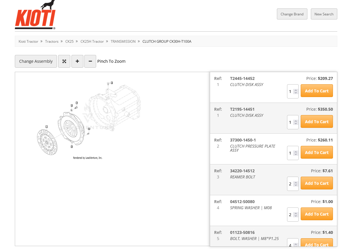

Yes, there is a conventional dry clutch. You can see it on post #66. It's there for the PTO. You don't really need a clutch to change ranges on an HST. Many HST tractors are like this.
I'll add a picture from the parts catalogue as well:

Arrow
The clutch is controlling the mechanical input from the engine to HST. It is not part of the HST transmission. On my Branson it controls the PTO like PTSG states and also disconnects all mechanical input from the engine. It also allows starting tractor without and mechanical power going to transaxle so engine turns over much easier in cold weather.
I have not seen a Kubota or Deere that have this feature but diagram posted by Len certainly looks like there is a clutch between engine and transaxle.
