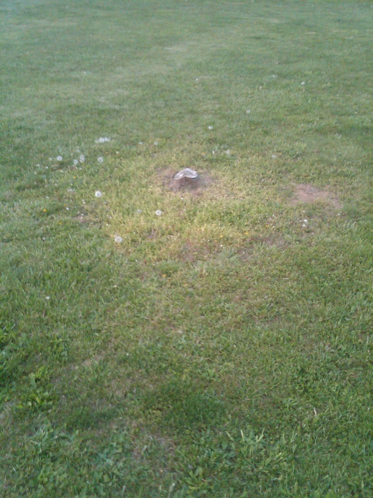

So, I am waiting for the new BX2660 and I am already planning things that I want to tackle. I have about 13 pine tree stumps (pic attached) that are anywhere from 6" to 10" around.
Think there is a way the BX can get them out without a backhoe?

yes you will need two dig out two sides push on it few times use a axe on some of the roots and it will come out takes a little time but they come out. just did about ten this week with my 2660. better than renting stump grinder if you got the time. helps alot if you leave about five feet to push and pull on good luck.

If it were me. I'd dig around the base of the stump so that you can flush cut with chain saw. Fill the hole back in and just mow over it. In several years it will be rotten enough you may want to mess with digging it out. Just flush cut and forget. Even with back hoe stumps are a beech. Read where some guy uses tractor to pull cable under to cut roots. It works for him.

It is going to be an individual thing and yes you "can" do it, but "should you". I personally wouldn't want to tear my lawn up and as others have recommended, just flush cut it. I have done hundreds this way as it works better for me than digging them out.

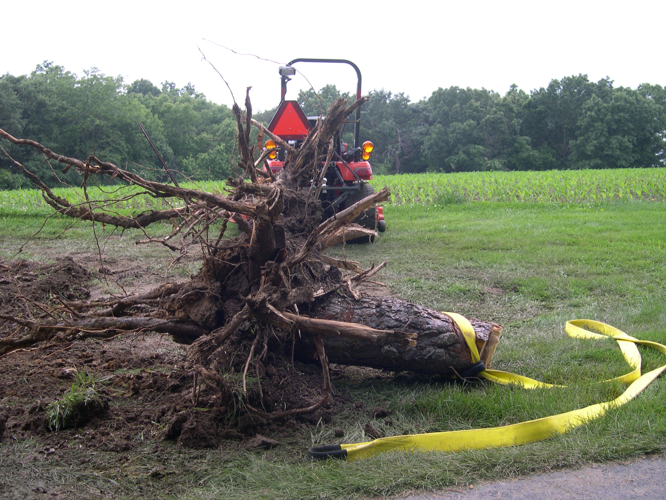

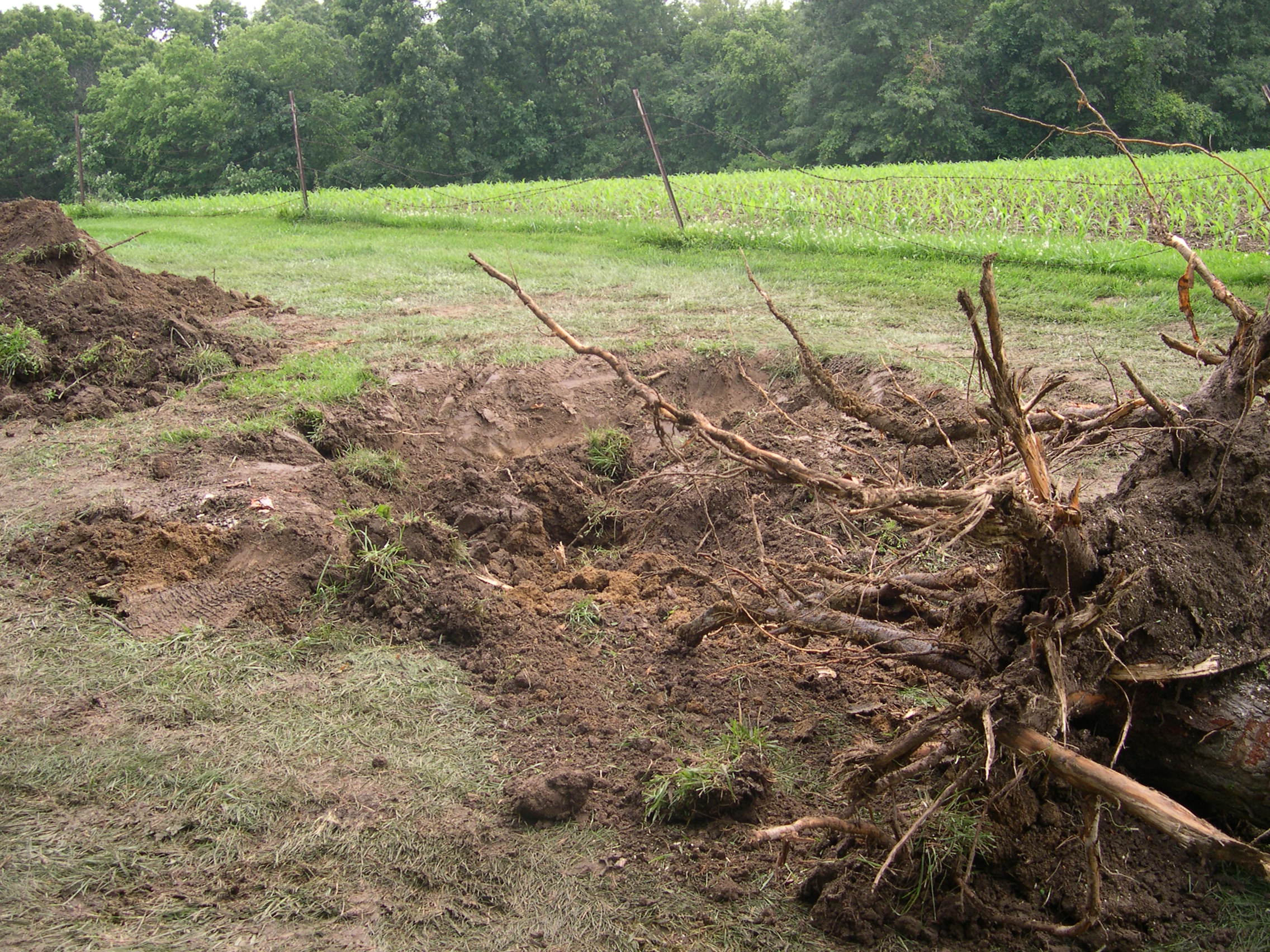

I dug out about a 12" pine stump with my BX and the FEL. It took a couple of hours and I ended up with a pretty big hole. The easiest is to cut if off flush, but its nice to get it out of the ground. Here is a couple of pictures of it. You will notice I left a couple of feet sticking out of the ground, and I actually pulled it out with my truck.

I wouldn't waste my time with the FEL. As others said you will just make a mess and probably end up bending something.
Rent a stump grinder and be done in 5 minutes on something that small. I have a few stumps and while a BH works well, it is still easier to eat them up with a stump grinder.
