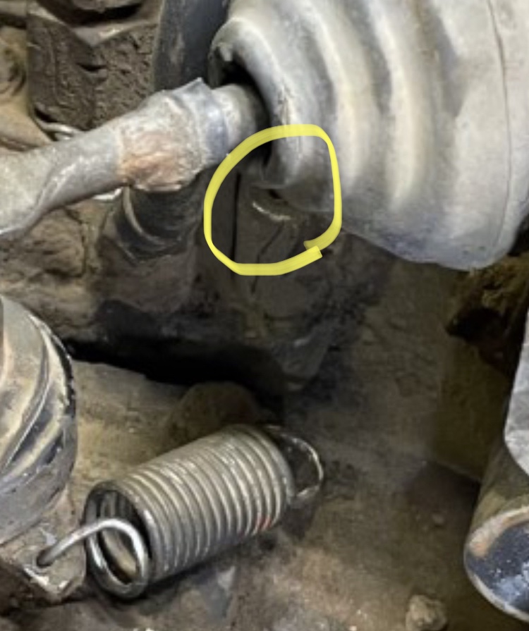

Can someone tell me where this spring is supposed to go? RTV900R6 model
   / Can someone tell me where this spring is supposed to go? RTV900R6 model
#11
I would expect the spring to go somewhere in that area. There's also something to the left of the circle being partially covered by the rubber boot. That also looks like a loop.
That's the forward upper socket head cap screw holding down the injection pump. It looks like a hole from that pic,just not a spring end hole. :(

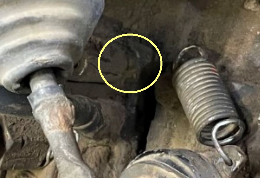

   / Can someone tell me where this spring is supposed to go? RTV900R6 model #17
Are you referring to the pics on top of page 5? If so, it looks like the direction of tension is almost directly in line with the stop solenoid. Maybe the other end of the spring attaches to the stop solenoid structure?
I'll have to go look.
Thanks!
thats what im thinking. it works against the stop solenoid.
   / Can someone tell me where this spring is supposed to go? RTV900R6 model #18
It could just be something out of focus but this looks like an eyelet the spring could reach. :confused3:
....and what is this?:
#19
I think I'm just going to make a bracket that fits under the SS and call it good.
