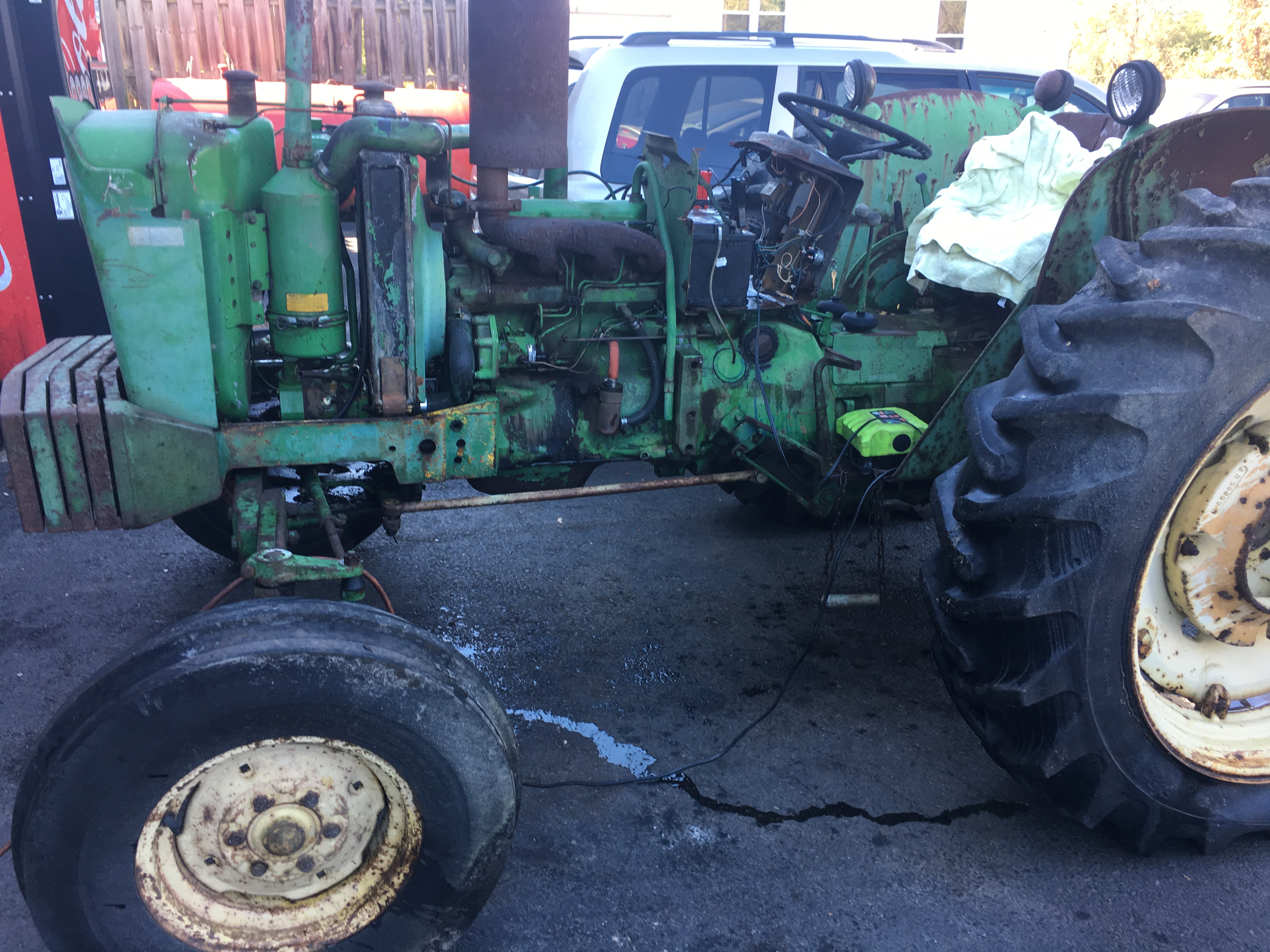

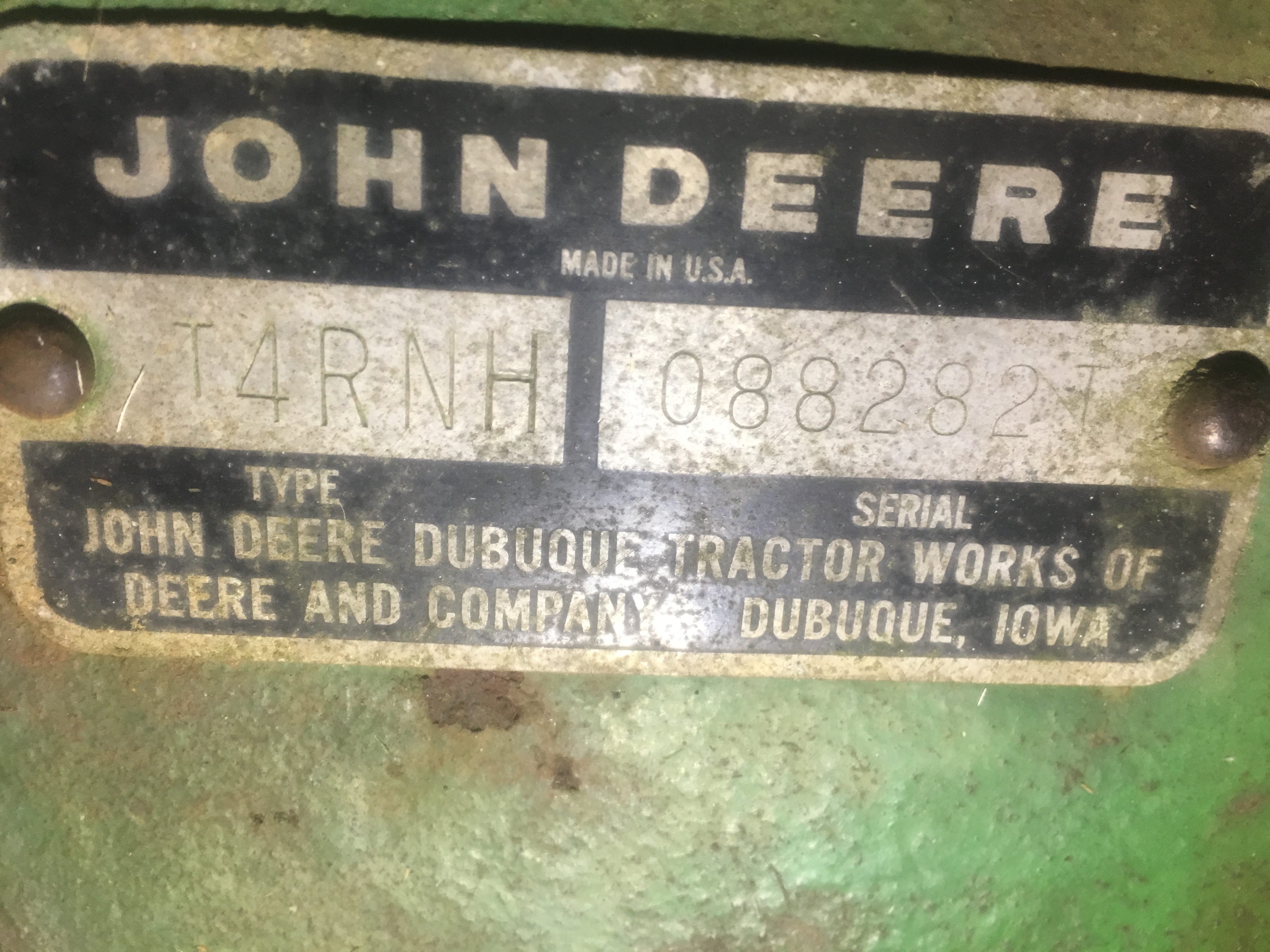

So I have inherited a John Deere tractor, I believe to be a 1020 or a 1520. I have been searching for a couple days and have not been able to identify which it is, or if I'm even correct between those two. I talked with my dealer and gave them the serial number, but they were not able to tell either. I'm hoping someone here can tell me. The serial number is T4RNH 088282T. Rear tires are 15.5 - 38. I will get some better pictures tonight, but this is all I have on my phone right now. Let me know if any other information will help. TIA

Send that pic of the tag to John Deere Dubuque Tractor plant and ask for information.. may take some pre-calls to their customer service to initiate where to send the pic and get that info, but think you will get it.

I don't think its an 1120. All of the ones I could find pictures of had the headlights on the front, and or bigger fenders, and also had dual fuel filters. I know I didn't have a picture of that side of my tractor to post right now, but it only has one filter. I called the Debuque tractor plant and they said they couldn't help and gave me another phone number. I sat on hold about 10 minutes to have a lady tell me that is not a valid serial number and she couldn't help me identify what model it is. Thanks for the replies though. I have most of the sheet metal tracked down, as they don't seem to be different model to model, but would like to get the correct graphics ordered, as well as a clutch kit.
That serial tag is the one off the right side of the transmission/rear end housing, just below the seat. That is the right one to be trying to track, correct?

Looking between the 1020 and 1520, my rear tire size doesn't match up with either they list. Mine are bigger than both, but someone could have changed them... I do have an oil bath air filter which it doesn't list for the 1520, but it does for the 1020.

it's a1520 row crop utility, diesel engine, column shift w/ hi-lo

Give me the #'s off the name plate on the inj. pump & I'll tell you in seconds..
   / Can Someone Tell Me What Model I Have?
#9
Roosa Master GBC—331-3AL
