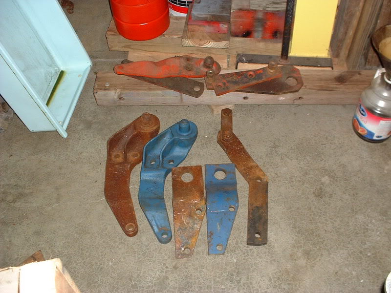

I replied to your pm yesterday. The brackets in your photo are for the early (1962-64 )4 cylinder 2000. Won't fit yours. The 'hip' bracket on the 3 cyl models and under tranny bracket/s are the same on all the 3 cyl tractors.
The front bracket is different depending on which model and year. They used different bolsters on the 2000s - early and late - light and heavy. My 68 2000 had the early/light bolster. Have photos of both types but need to get somewhere with wifi to get them.
I might know where there is the front bracket for an early bolster.
Sorry to be a pest, but my first post actually has two sets of brackets shown. One set is the nice painted version and the other is laying in the bucket and probably hard to see. I'm assuming that the "flat" piece brackets are the ones that don't fit my tractor. Are the rusty looking ones the correct ones then? I don 't know if I'm going to be in better shape or worse than I'd thought because I have the 3 cyl tractor with the heavy bolster. Soundguy on one post said, I think, that those are pretty hard to find.
So I'll really need to have a good photo showing how it all ties together and what exactly it is I need.

So....1968 Ford 2000, with the "light" front bolster. I need the one arm loader (model 711) with the 3 1/2 inch attachment "box" on the arm.
The necessary correct brackets are still a mystery even after a week's worth of effort to pin this down. I've posted a photo with two different types in my earlier post, but don't know if either is correct. Ultra Dog says the flat ones won't fit. Don't know if the other ones, shown in the bucket, will. Or if there's a third option. If anyone has a tractor with this set up, I'd be grateful for a photo or guidance on the proper set of brackets.

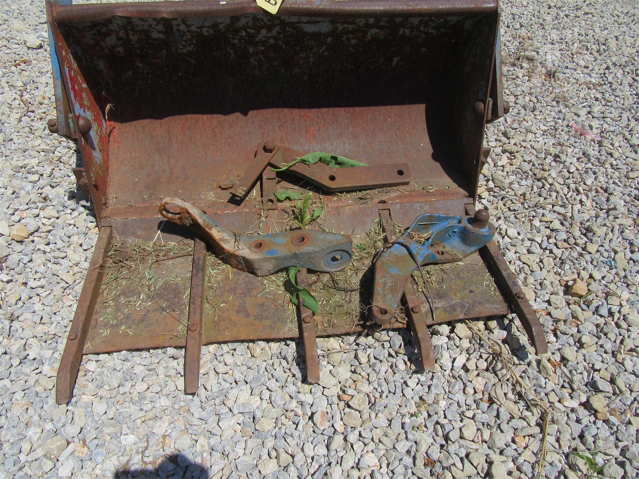

I've been trying to figure out exactly what Ford 711 one-arm loader will fit on my Ford 1968 2000 tractor. I have read all I can read on it, and know I need the "short box" style. I have seen manuals and instructions on line, and a bunch of photos. But I can't find any reference to the brackets. I've read where there are a few versions and if you have the wrong bracket, even if you have the correct loader, its not going to fit.
I started another post a few days ago and added some pictures there. There is a "long box" one arm loader on the Kansas City Craigslist site. He has a good photo of the brackets (below). There is another one on the Tractorhouse site and I think its the short box but it has cast looking brackets that I believe fit the older (800-900, etc.) tractors. I've added that picture but from what Ultradog MN says these might be the correct brackets

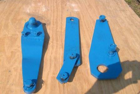

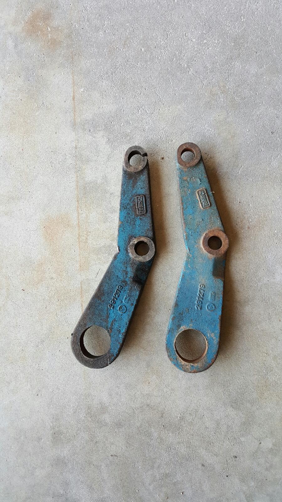

Ultradog MN was kind enough to provide me a couple photos. Its been a big help. There are two sets of the 3 cyl three brackets in the photo -- one painted blue and the other in a nice rust color. Those are the 3cyl bracket. The "hip" bracket is "ribbed." Its the same as one of the bracket in my first post laying in the loader. Ultradog also sent a picture of the bracket for the 2000 Ford 3 Cyl light bolster. There are two in the photo. Also, his picture has the brackets for the older models, so its pretty comprehensive. I've included those photos hoping that anyone looking for this info will tumble across this thread.Brackets Loader.jpgFront light bolster 3 cyl brackets.jpeg
