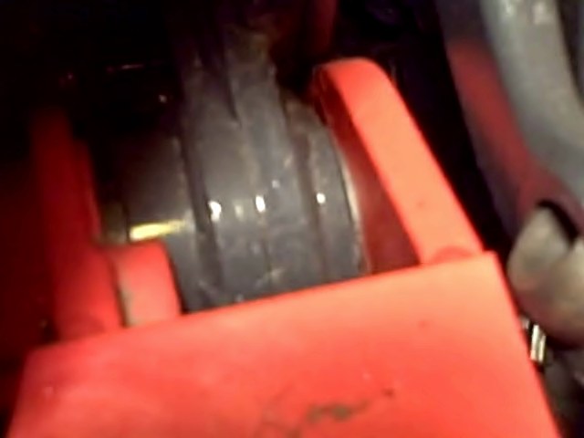

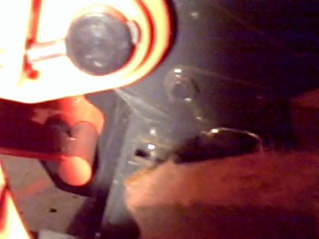

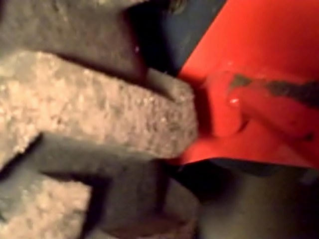

I did the best I could shooting some pics off my BX25. With the backhoe on it was tough. Like trying to tell someone how to put their coat on. Basically, the two lower pins on the hoe lock into a hook; the two upper pins are then inserted to lock the hoe in place.
Good Luck.

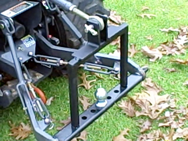

I found a pic with the hoe off the back of the BX25. However, I do have my homemade trailer hitch in the way.
