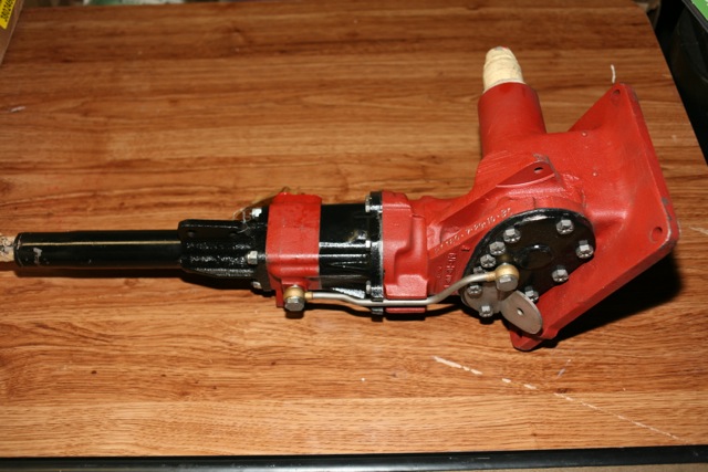

Can someone please help me identify this Ford Power Steering column/box? I purchased it at a storage auction and the only markings on the box are as follows:
Box itself:
Leys 30-00-01-479
and then engraved on the box (after rebuild I assume):
RC 180 then the date rebuilt and then BC
I really appreciate all help and assistance! Thank you!!

Looks to be a box from a machine with a cab... likely a Ford 4610 or similar.
   / Can someone help me identify this ford Power Steering Box Column? #3
depending on the bolt patern on the bottom it could be a late model 4000 a 4600, a 340a or 4610 also fits a 2600, 3600, 4100 cab tractor if the small bolt pattern if the large bolt pattern it can fit a late model 5000-7000 a 5600, 6600, 7600 and a 5610, 6610, 7610 with fit cab or open station depending on the length of the top shaft

I had one of those off a 7600 several times trying to get it to stop leaking under the steering wheel - never fixed it. Top shaft looks shorter - probably interchangable - next shaft down is $1200 at CNH.

Thanks for the responses. What are the bolt patterns? I can measure the unit and compare.
I fully intend on putting the unit on ebay as soon as I figure out what it is out of!

This is the best I can come up with, I have a feeling this is a rebuild by
Walts Tractors, please see:
Rebuilt Steering Box (CC*)
UF00028 Rebuilt Power Steering Box
Fits: : 4000, 4600, 4100 Dunham Log Hog, 340, 540, 4610, 1970 - 1990; Must Use Adapter Part #90026
For Return Line On 1981 - 1990 Models
$450.00 core charge included in price
To Receive Core Charge Refund:
Core Must Be Returned Intact(1 Piece),Visually Inspected & Deemed Rebuildable
The last two look very similar except for the fact mine does not have the ears on the top of the shaft.
