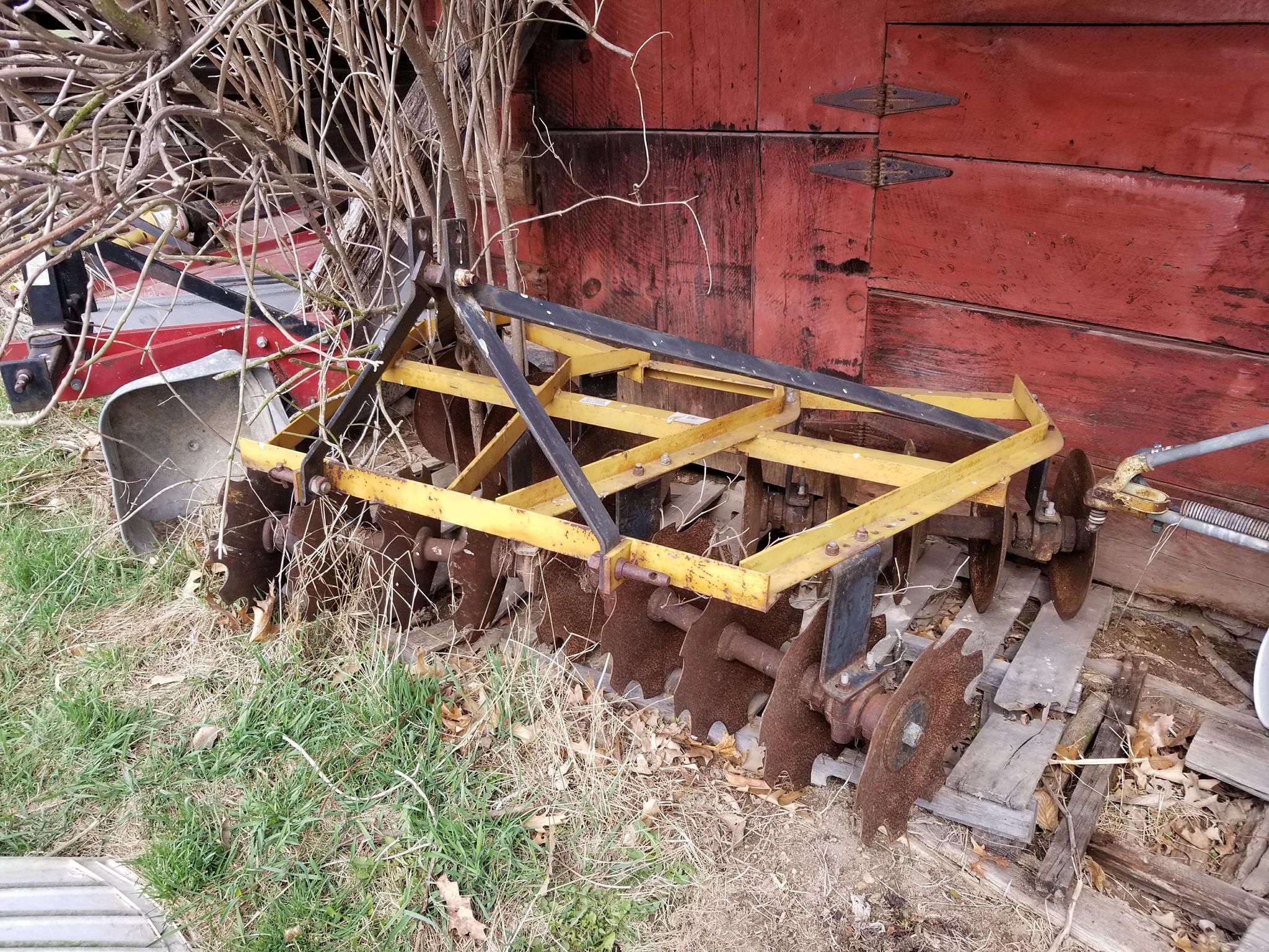

I am looking to purchase a used 3 point disc from someone. Its primary use will be to chop up the soil after plowing. I have a new holland T1110 28 hp, 4wd with ballast in the rear tires. The plow looks to be about 5' in width, with 14" discs.

Yes - your tractor should handle that disc quite easily.

I have that same disc harrow and my b2650 ( 26 hp) 4wd pulls it okay . Much will depend on how much traction you will get on newly plowed ground but shouldn't be a problem . If it is newly plowed up sod ground , don't expect to much . I went over the plowed up sod several times and still had big chunks of sod . With plowed up sod ground I ended up having to use a rototiller behind the 2650 to get the sod chopped up . The disc will work great on an established garden plot .

Angle iron frame Disc Harrows are very light. They are usually not adjustable.
Would be suitable for smoothing previously plowed ground in a garden situation, perhaps with two or more passes with the tractor/implement combination.
Useless for opening virgin ground.
Your New Holland T1110 28 hp, 4wd with ballast in the rear tires can pull this disc without any problem over virgin ground but without any result.
Go for the PTO powered roto-tiller.

If most of the soils you will farm are not very rocky I would choose a roto tiller. That harrow will take a lot of work on new ground since it is so light, but in rocky soils would be a much better choice. It will do it, but if you have the $$, I would get the tiller if rocks aren't an issue. Your tractor will handle the harrow just fine. If you choose the harrow, you can adjust the top link on the first pass, so that the front gang will be digging much deeper than the rear gang, that is angling the harrow into the ground as you travel forward. The rear gang will act as weight for the front gang. The harrow will be an 'all soil' ground engaging attachment, where the tiller will get beat up on rocky soils.

I would say - go get a rototiller. That disc harrow you pictured in post #1 is probably VERY reasonably priced - and for a reason. Its very light - definitely worthless on trying to open virgin ground and you will likely be disappointed with its ops on plowed ground. To force it to work - you could add weight on top of the existing framework but that risks damaging the harrow. You will likely have to make so many passes with the disc - you could cause soil compaction.

The maximum Box Frame, Tandem Disc Harrow a New Holland T1110 28 hp, 4wd with ballast in the rear tires can pull, with front gang set aggressively and rear gang set two increments less aggressively, has 18" diameter pans, about as wide as the tire spreads. Such a Disc Harrow is marginally effective.
Pans 14" in diameter will float over the ground, not cut. If you weight an angle iron frame Disc on the front there is a good chance it will come apart.
