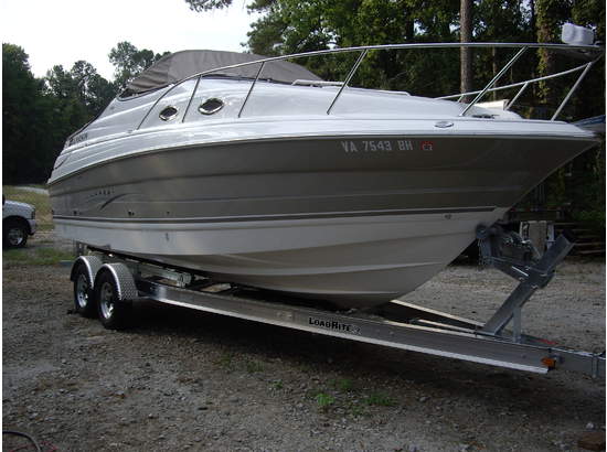

I tow my 28HP tractor that weighs 5,600# with a Bush Hog on the back on my 18' Car Hauler. It only weighs about 1,400# and is a 7K unit so its right at the max for the trailer. It tows great. I also tow my 30' long 9' wide boat that weights 9,700# with low fuel ect so usually around 10,000# with a normal load and it does fine. I have towed it well over 5,000 miles this last summer and averaged 9.1 mpg. Yes, a little over weight but not bad.
