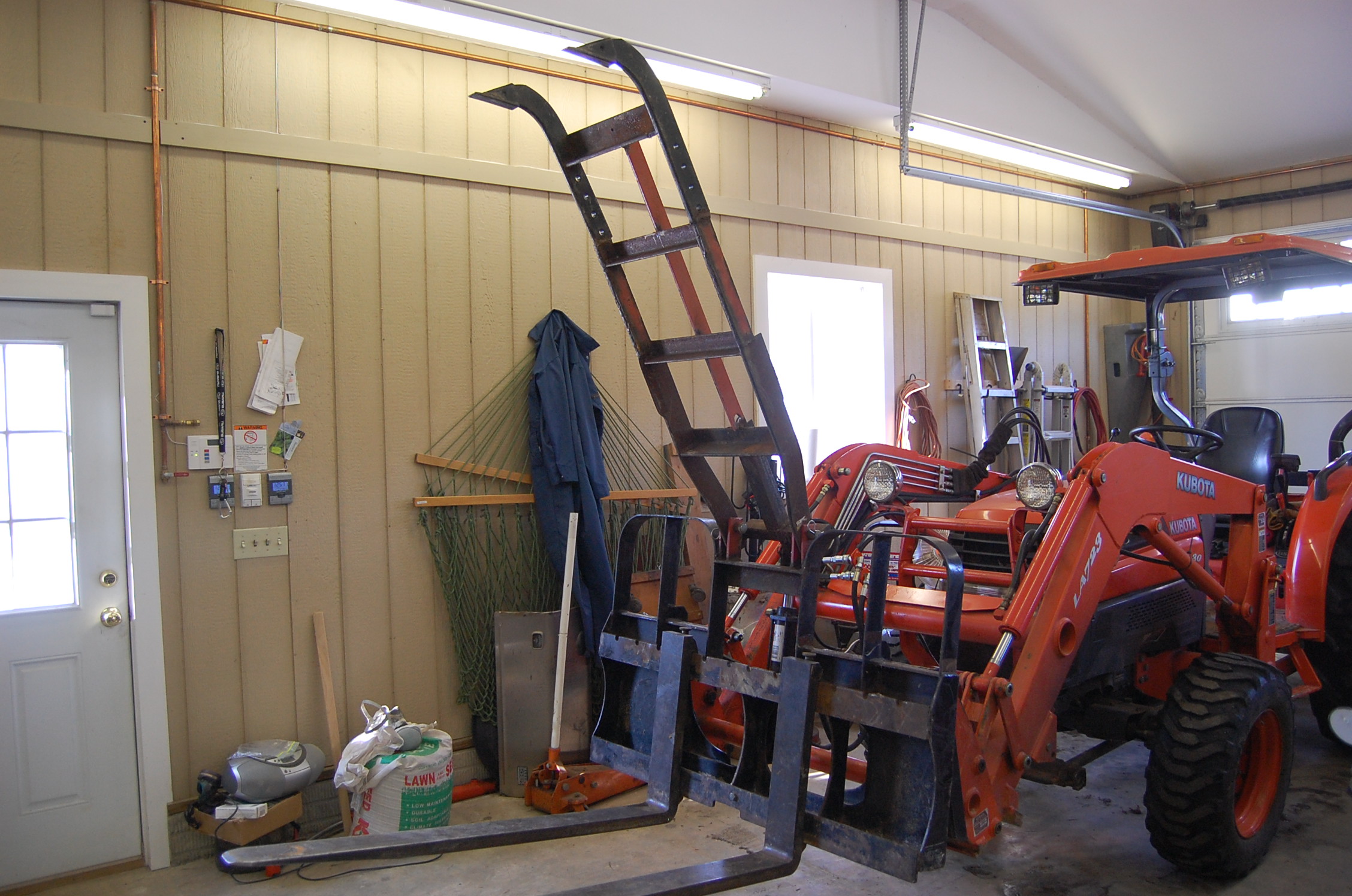

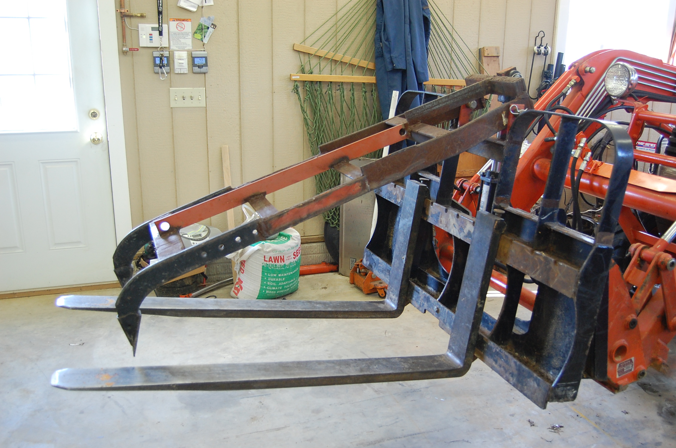

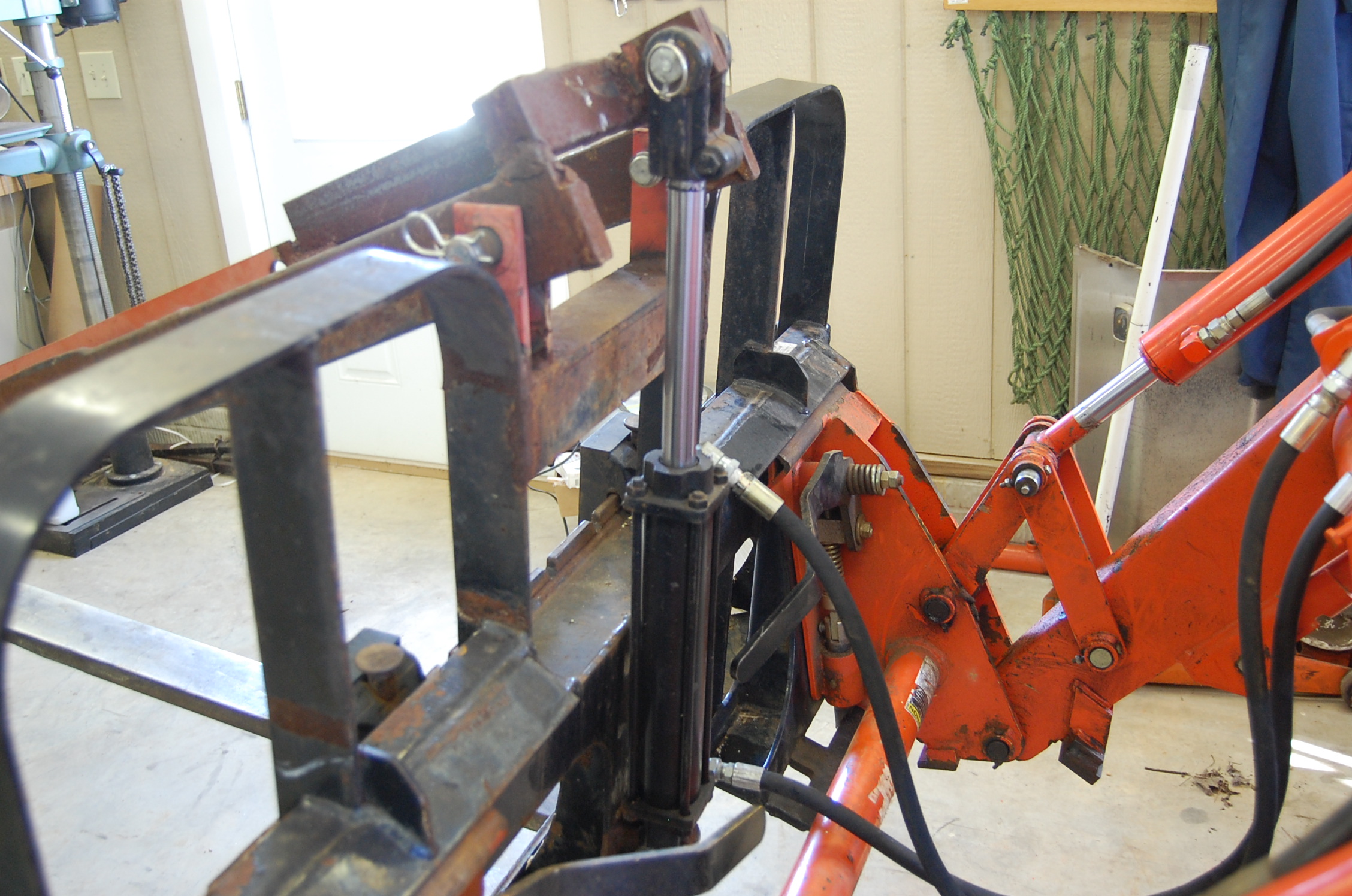

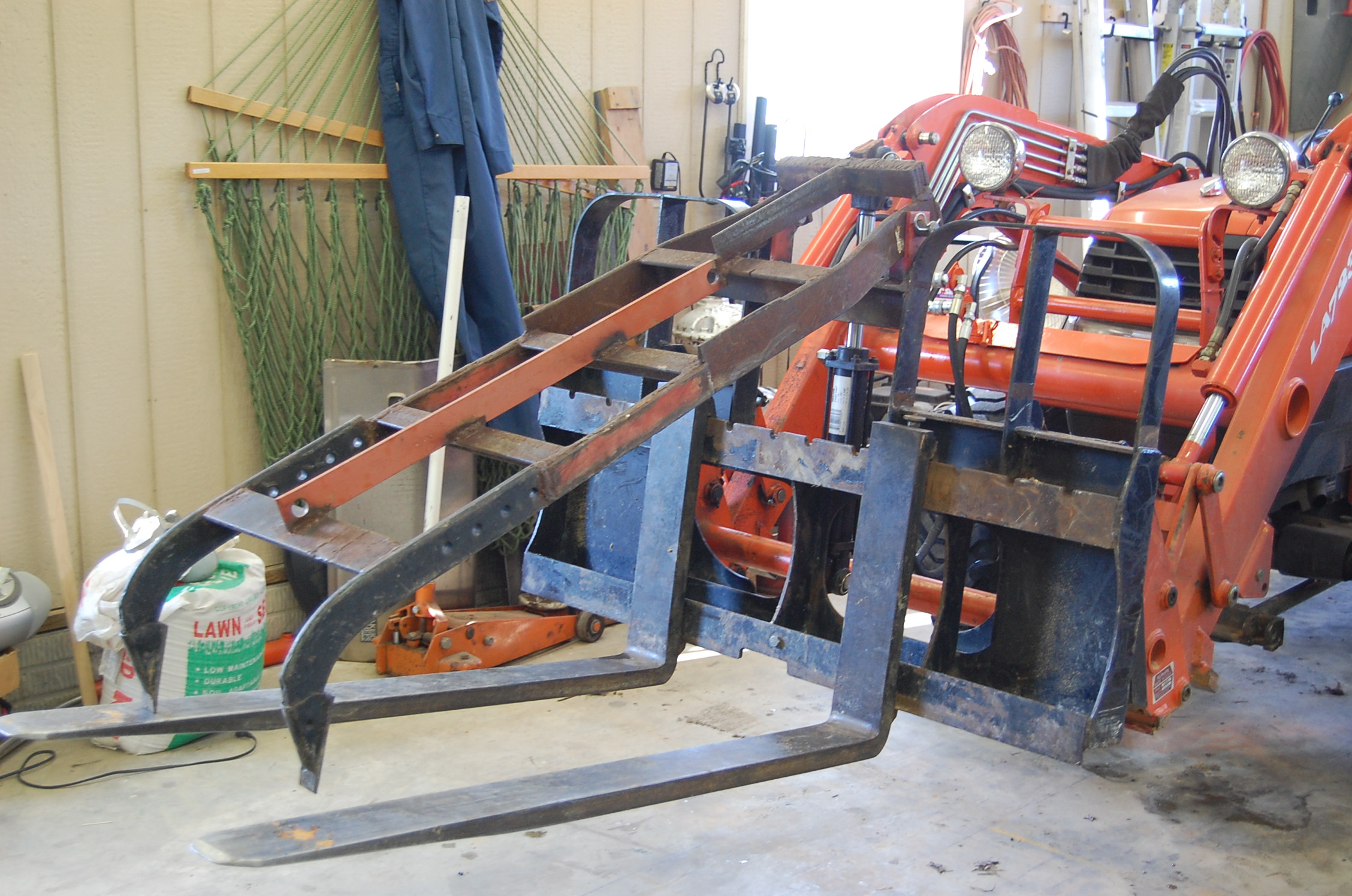

You can also add grapples to the pallet forks as I did. It makes it very easy to move brush, logs, etc. and it works great to secure loose loads on the pallets.
I welded mine up out of a couple of bush hog blades and box blade scarifiers. I use the rear remote to operate them.
They aren't pretty, but they work great. And one of these days I might actually get around to painting them.
