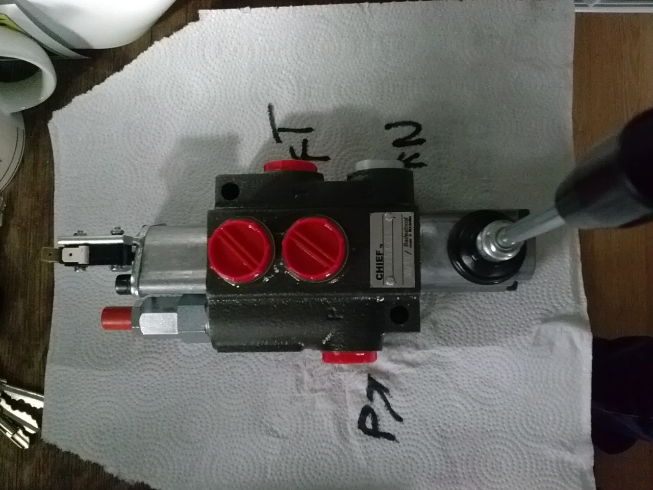

I need front skid steer style q/c on myloader to power hydraulic attachments.
can I use this chief 1 spool valve?
Chief 1 Spool Hydraulic Control 3 Way or 4 Way Valve - Tractor Supply Co.
I will come out of factory loader from the power beyond---into new valve inlet --- from new valve out to existing tractor power beyond outlet line to 3ph.
I also need to come out of new valve from OUT port and t into tank return from loader valve?
I cannot tell if there are only 4 or 5 ports on this.
Will this work?
Is the port with the hex cap blocking it off a power beyond port, I am assuming?
Thanks

I got the baileys valve with power beyond.
How do i plumb this up?
P on valve will be connected to power beyond out from loader valve. T on valve will goto power beyond IN? Do i not need to use N blocked off port? It has a hex plug of sorts.
The hydraulic motors are hi torque low speed auger and rockhound motors running thru a set of 1/2 skid steer q/cs.
Thanks!
   / can I use this TSC valve for front remotes #5
If the valve has the PB adapter or the hex screw, then you install the loader PBhose into the IN port of the new valve.
Tank port goes to any tank line.
PB from the new valve will go to the 3pt in port.
