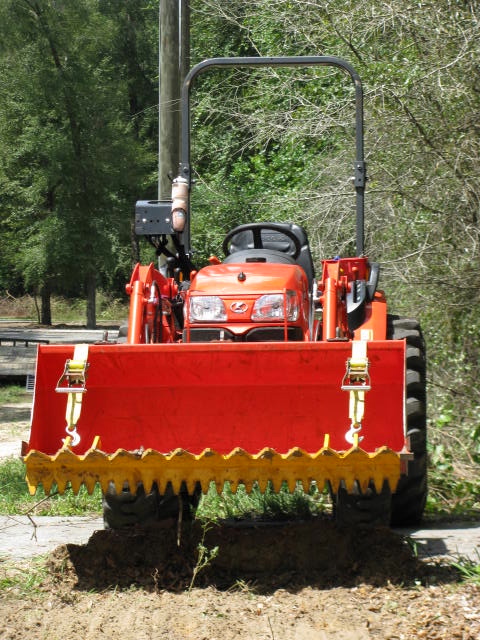

While the BX series have mostly Category 1 Three Point Hitches, they are reduced in width. It is unlikely any 60" Box Blade will fit on a BX hitch without interfering with the tractor.
Consider a Ratchet Rake bucket attachment in lieu of a Box Blade for grading 1,000 square feet area.
You can purchase a Ratchet Rake from the TBN store. Button is at top of this page.

Thanks for the good information. jeff9366, I have a Piranha Bar - would that work similar to a Ratchet Rake? I think if I can't figure out a box blade I'll give the FEL with PB a try.
Ratchet Rake has two rows of teeth, set at a 90 degree angle. Ratchet Rake will be better at grading but you cannot dig with it at all.
The Piranha Tooth Bar should be good, however. Dig with the PTB, then back drag with your FEL bucket to smooth.
