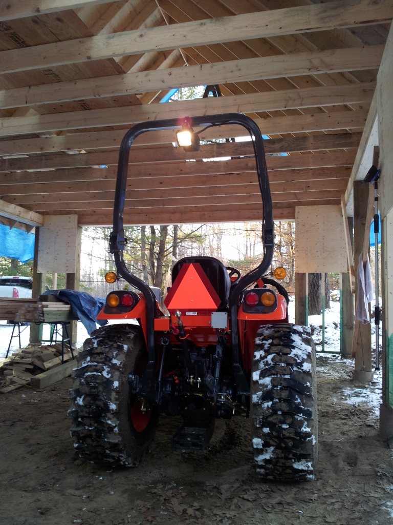

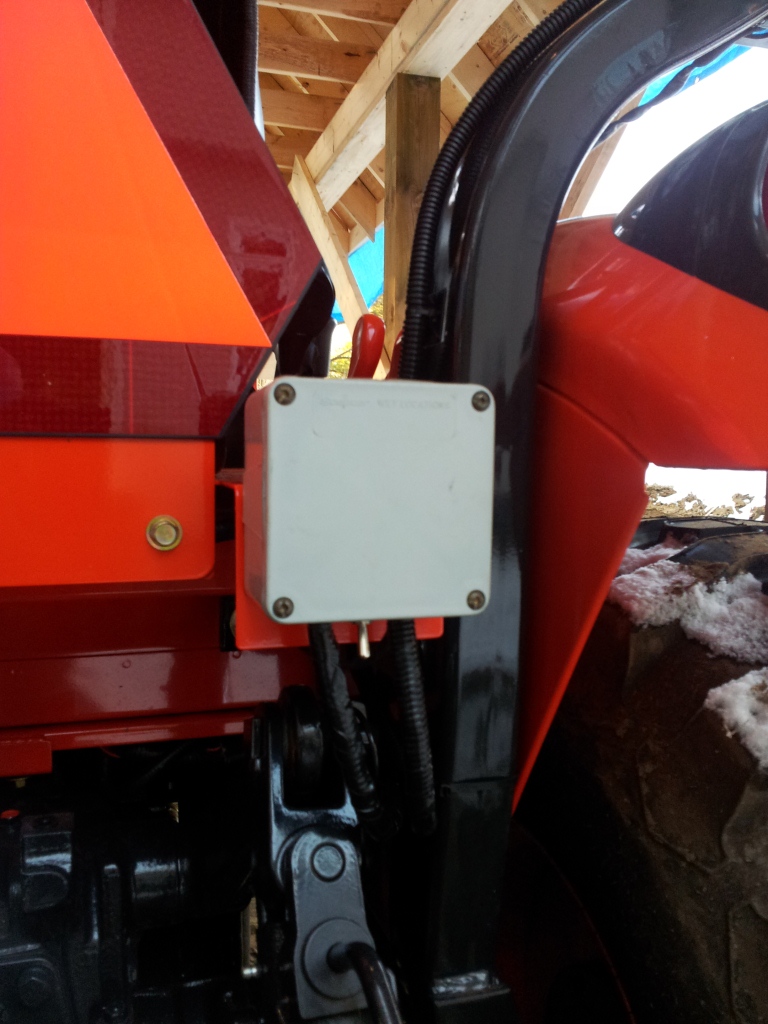

Hi. I just finished installing two 55W halogen worklights on the ROPS of my CK27. I wanted LED's but they are a little pricey and these were on sale. I will add a rear facing LED in the future and move the two halogens to be forward facing. I made a bracket from flat aluminum, installed a relay to run off the rear connector that runs from the ignition switch. To me the factory wiring looks under-sized so I ran a 10A fused home run from the battery to the relay and on to the lights on the ROPS. I couldn't find a half decent water proof switch so I used a good quality standard one and mounted it facing down with the relay and other connections in a weather proof PVC box - though I think I will move it to behind the mount point - a little less obvious. Works great!

Tip: Use a relay and use a waterproof switch conveniently located.
I didn't have any relays handy when I added lights to my canopy on my Mahindra and the lights eventually made the switch unreliable. I have to replace it when I have time- probably about 10 mins after it finally quits! :ashamed:
The upside is you can run a very small wire (thermostat wire, cat 5, etc) from the switch to the relay, so it is very convenient to route the wire and locate the switch.
A lighted switch is highly recommended.
Another tip: Mount the lights snugly, but so they can be tilted and rotated. I used driving lights and they mounted with a stud.
I move them CONSTANTLY depending on what I need to see or what I'm doing.
And I did run my two lights off the rear trailer plug. If I have to run the rear light at the same time, I only do it for very short periods.
ETA: Here is a link for a relay socket to make life easier. Use a waterproof relay. http://www.parts-express.com/pe/showdetl.cfm?Partnumber=330-080
Good prices at this site, but order a couple things at a time to keep down the shipping costs.
Hope this helps!
