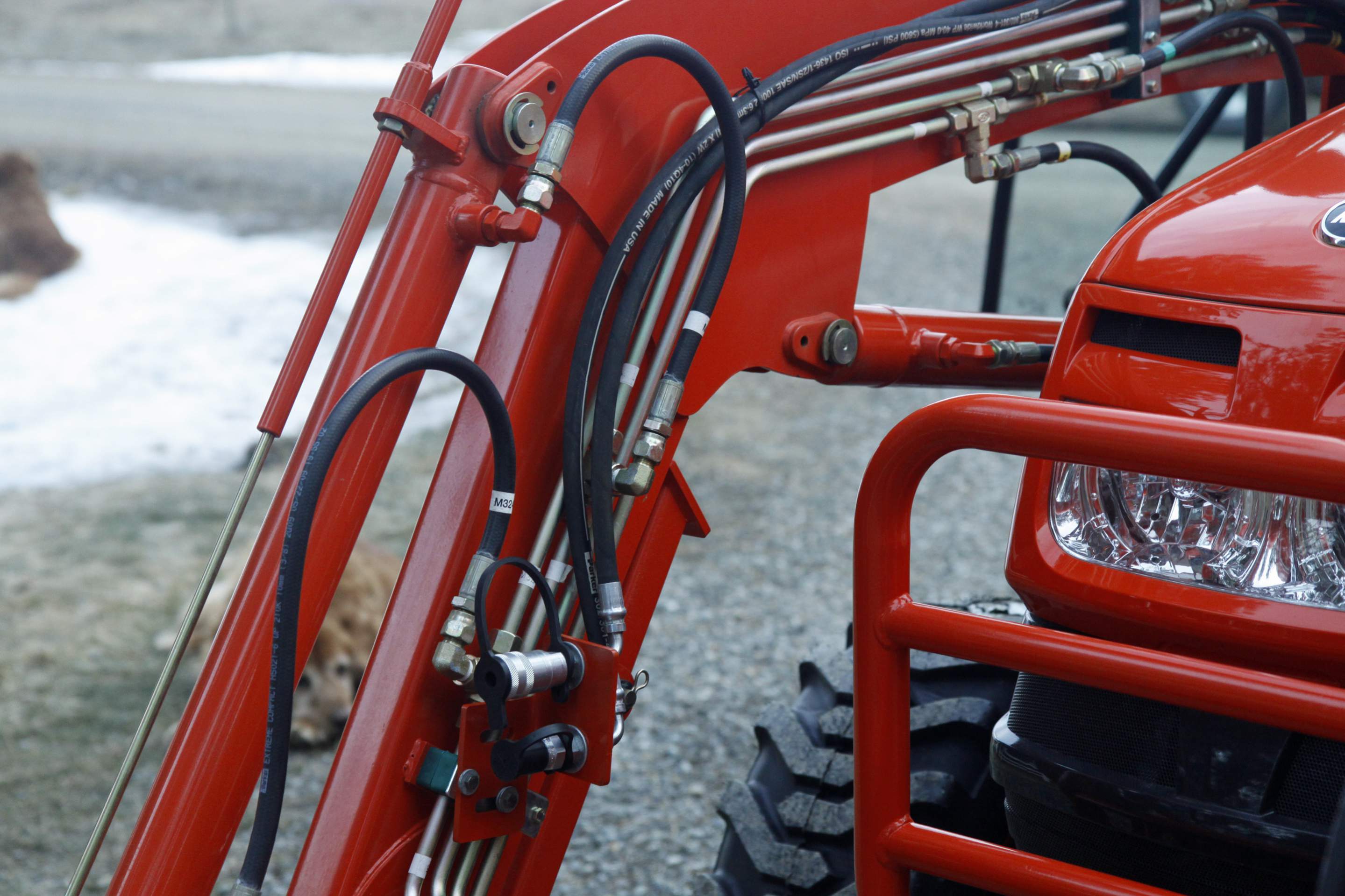

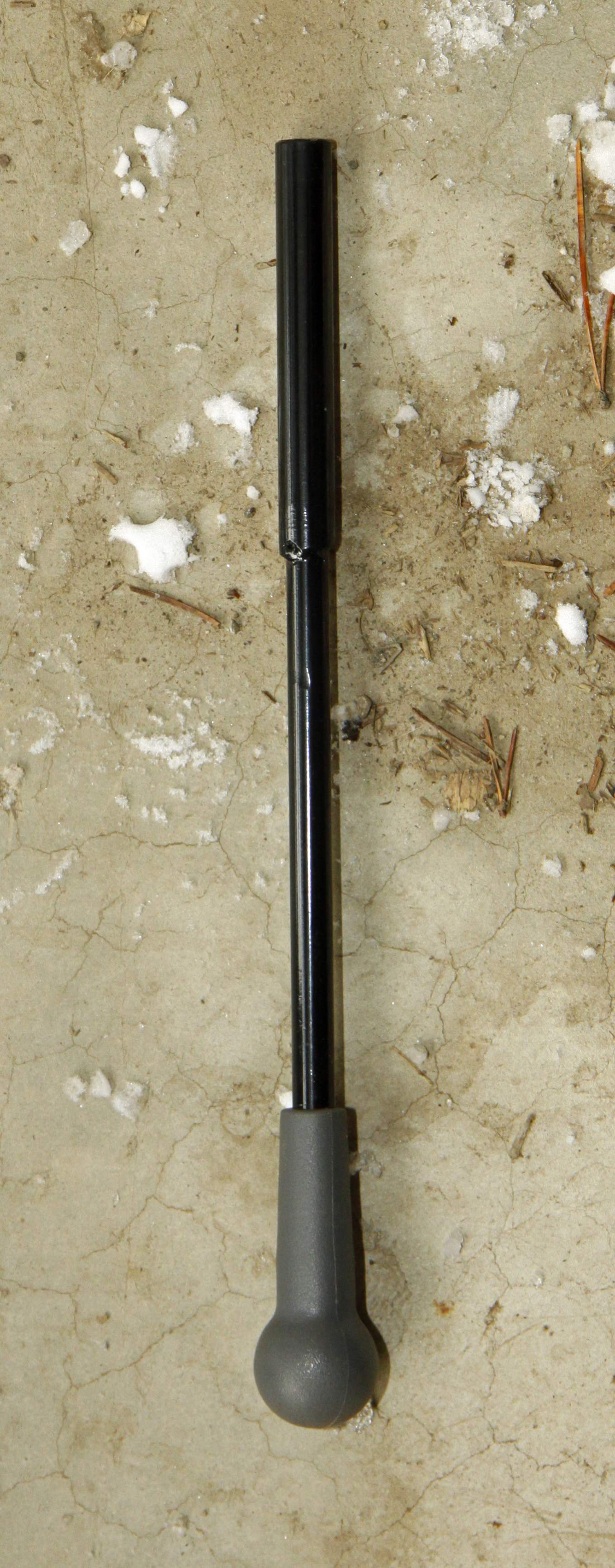

Of course the rear remotes can operate a grapple. I installed a set on my Kioti using permanent mounted hoses and a bracket to hold the connectors. I even have an extension piece that i attach to the control arm to make it easier to operate. works flawless. Doesnt matter how long the lines are.
Now that's creative! Looks pretty convenient on your tractor.

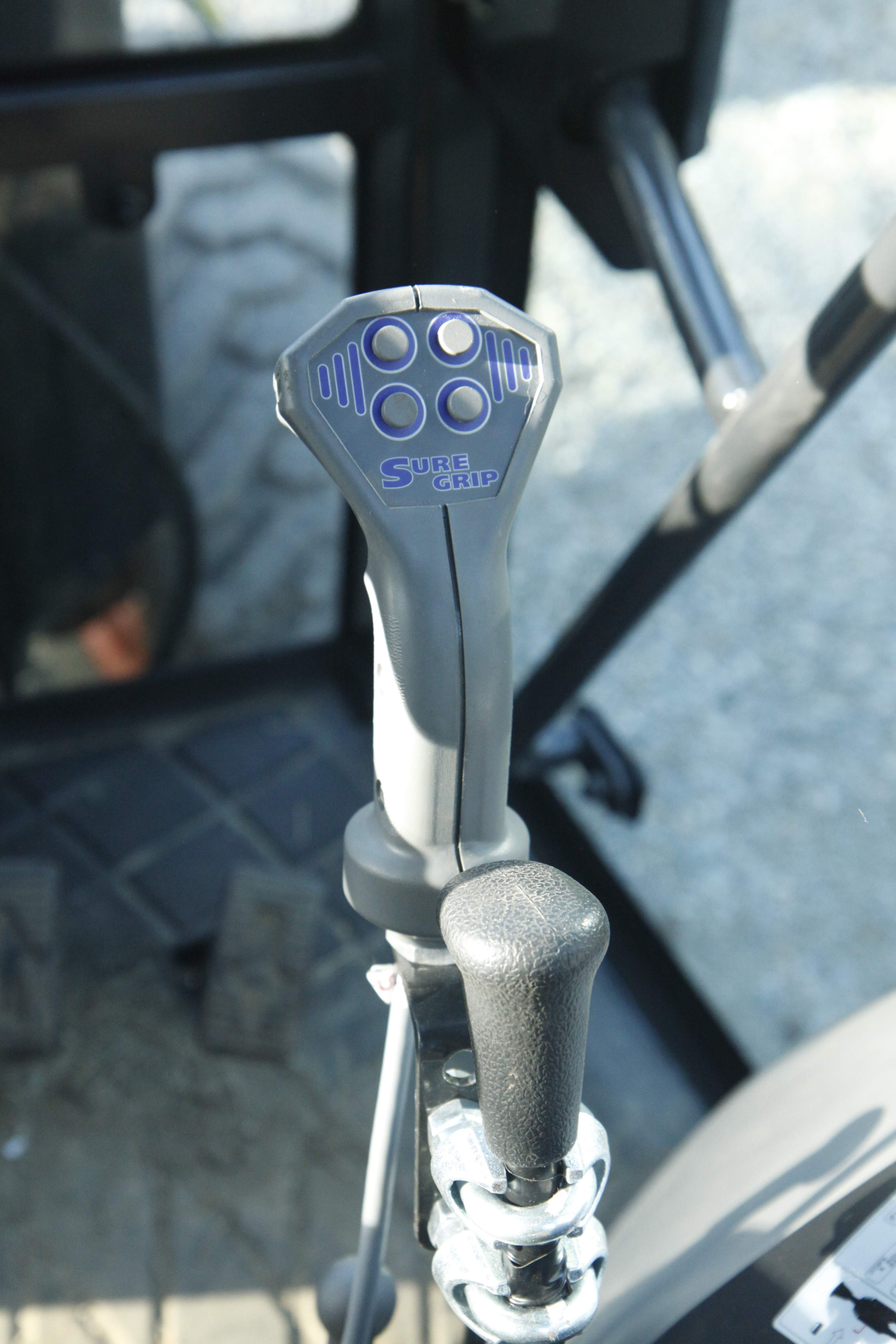

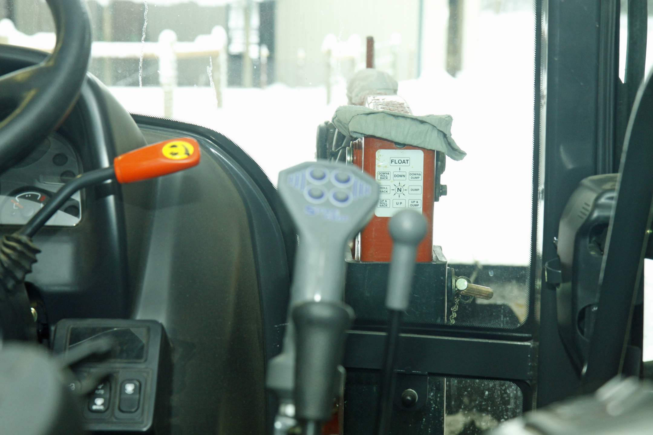

GRS the Great,
What do all those cool buttons on the joystick control?

they operate the chute on the snow blower...right and left swing, and up and down deflector.
i take the thing off when i put the blower away for the season. the buttons control the hydraulic valves which control the motion.
