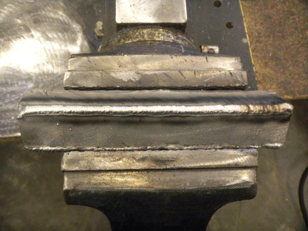

I didn't realize the 180C was a Mig machine:eek:. That is probably the cheapest way to weld aluminum. For stainless steel Mig welding you would need a tri-mix gas.

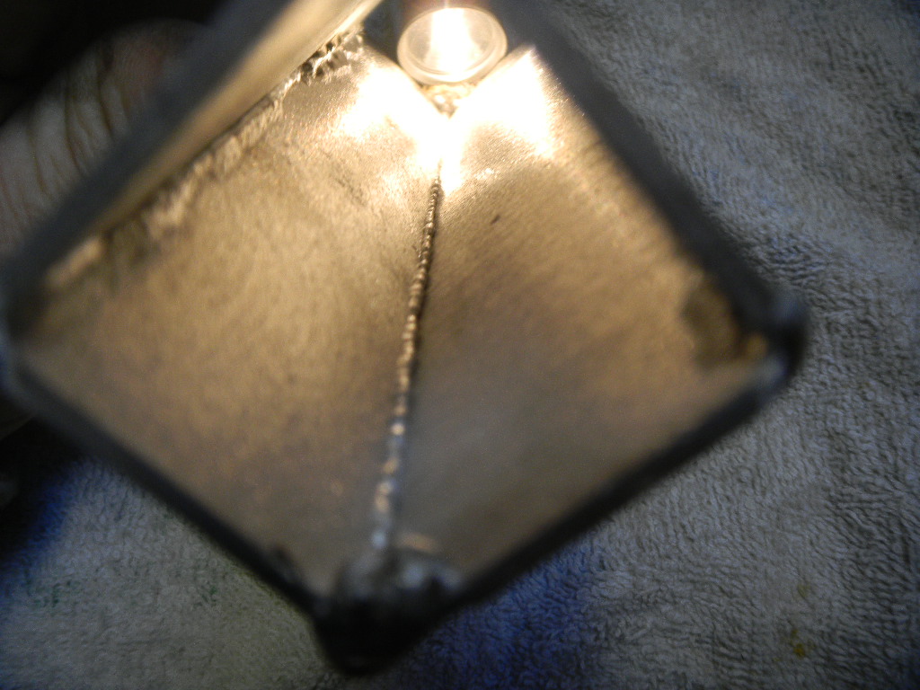

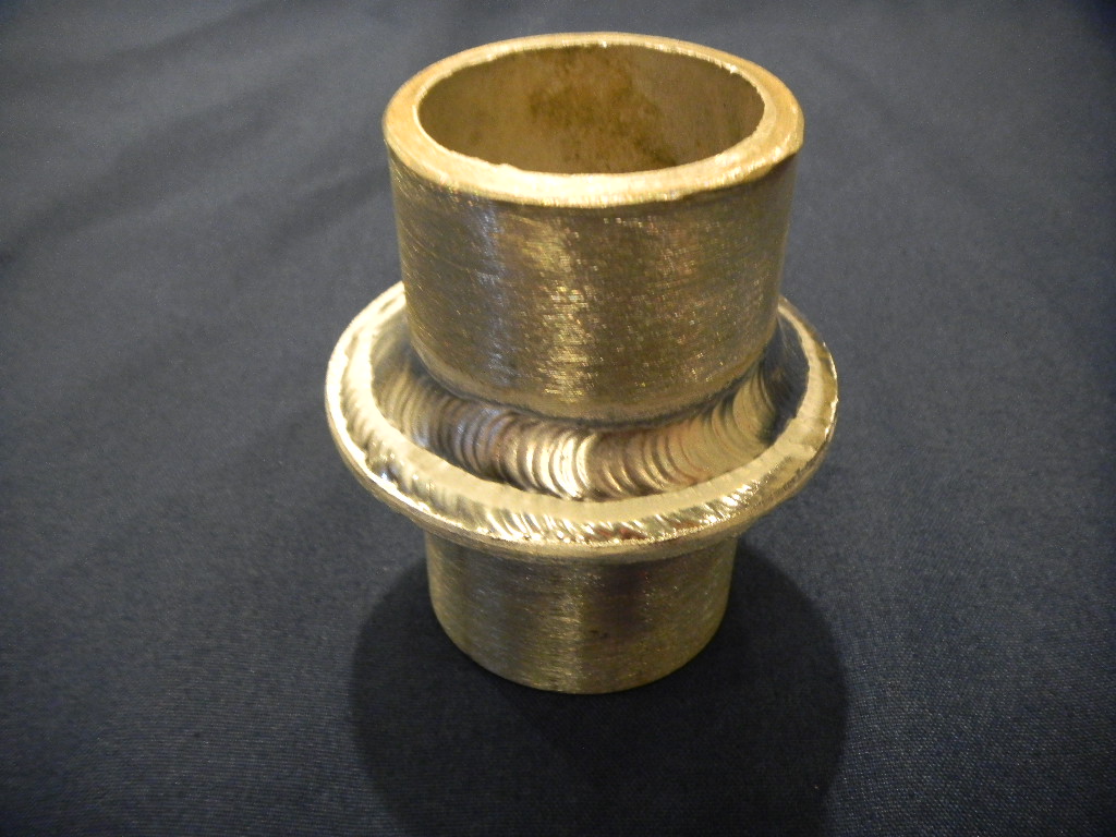

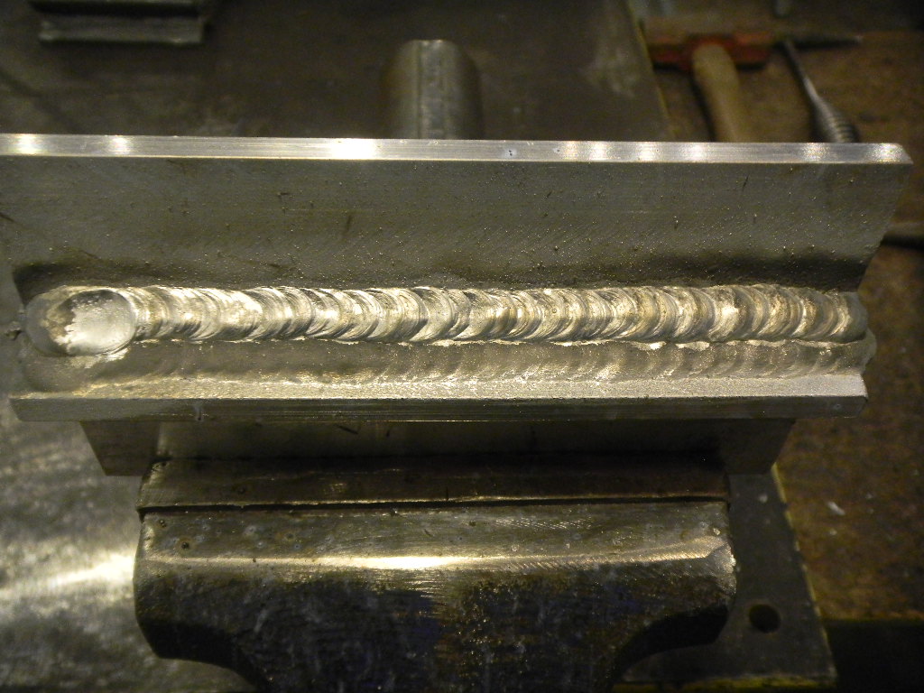

Here is a 16-GA corner joint on aluminum, and a fillet weld on 3/8-inch thick aluminum I did when I first got my spool gun.

Sorry guys, I should have been more specific on my machines.
So Shield you have a aluminum spool and are happy enough with the results? I keep getting lots of different opinions on the process...
/ Can I TIG with this #6
Yeah I'm happy with the results! Until buying my own spool gun last year, the last time I touched one was in the mid 1970's. The 16-GA corner joint was done with .030 wire, where as the 3/8-inch fillet was done with 3/64-inch wire. For production work a spool gun is the only way to go. But my Dynasty 300 isn't going anywhere soon. It almost made a Tig weldor out of me!
