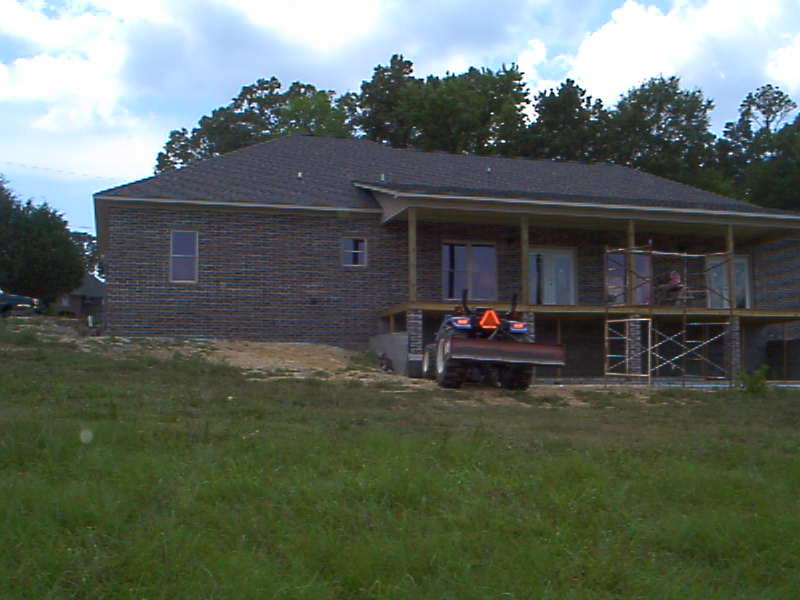

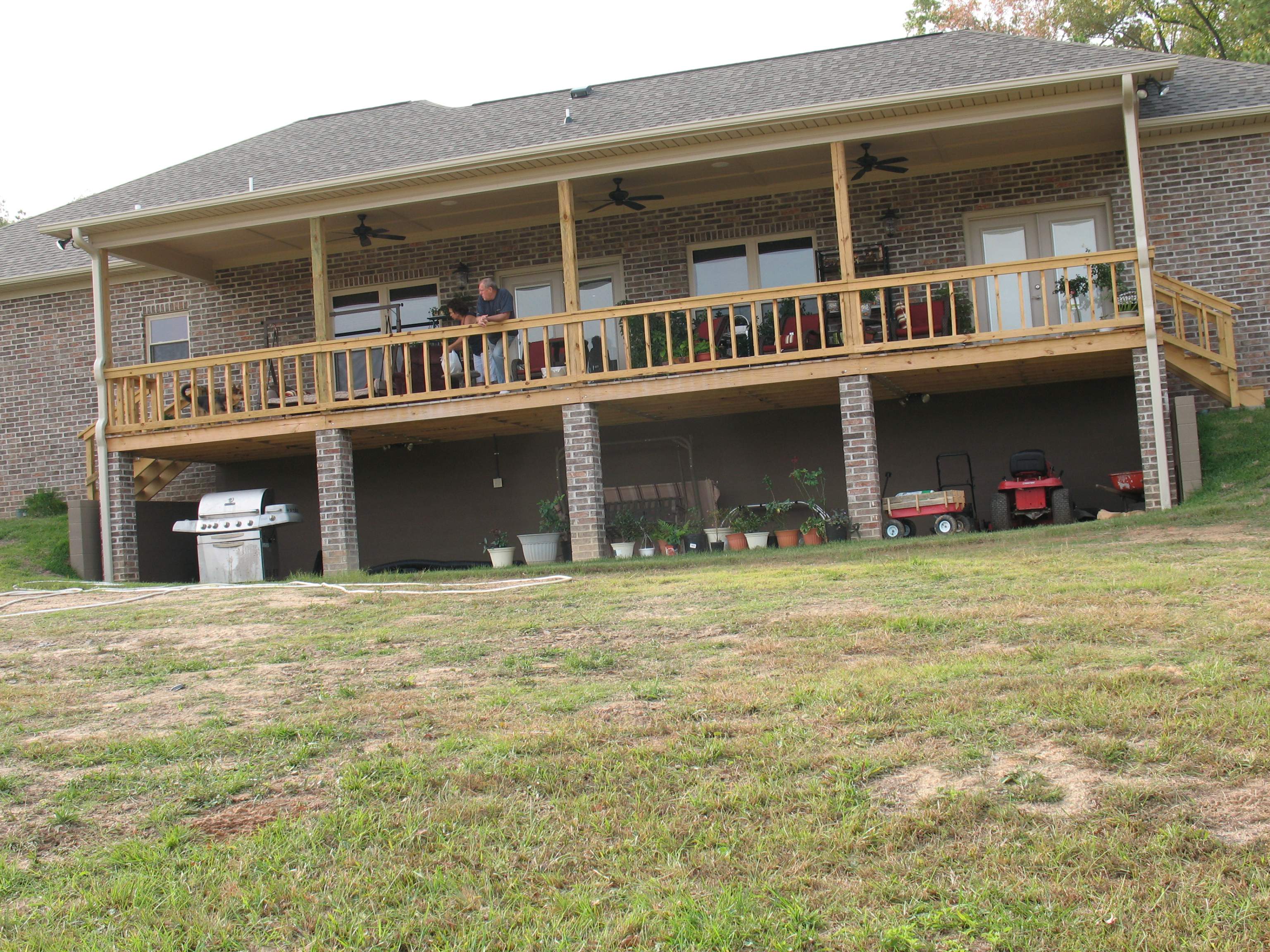

Several years ago I had a builder add some rooms onto the front of my cabin--two bedrooms and a large sun room. I lay out the design and made a slight error. I wanted a porch that was covered a bit, so I could sit out while it was raining. The porch was covered with deck boards. Problem is, the concrete blocks and footing ran along the rectangle of the addition, while the porch was inset from that. I know that is confusing, but the issue is the deck boards of the porch allow wind and rain to get underneath my house. I took care of what rain gets in by ditching and creating an exit for the water.
On cold nights, the wind comes whistling thru the deck boards to underneath the house, which does not help the heating process. I want to fix that, and hopefully without a major expense. I have included a couple of pictures to show the deck, and hopefully the design.
Is there a product to "seal" the space between the deck boards? Any type of thin solid material that i can lay over the deck? What are my options?

Just be careful that you don't seal it to where water will stay between your deck boards as they will rot very quickly if you do. Have you tried going under the deck and sealing the deck runner at the ends where they joint your house or even walling in the underside of the deck with some T111 or other outdoor plywood. I have a 12 x 44 deck on my house that I put a concrete pad underneath for storage or "stuff" mostly lawnmowers and gardening tools. It has a roof over it but still water blows in but with the concreted pad underneath, it all drains out. There should be an easy way to wall in the back side underneath the deck to stop all the wind and a nice roof over the deck would be nice in the summer and keep the rain off. This is a photo of mine under construction. They actually build the rest of the roof then put the deck roof on, you could do the same thing on your house to put a roof over yours if you wanted.

IMG_0833.jpgThis is how it looked when finished and a few weeks after we moved in.

I have seen people put a metal sub roof under a deck, slanted to drain towards the front. Not hardly noticeable at all and seems do do the job. I bet you could use the cheap corrugated metal from Lowes or HD. I dont think it would have to be to elaborate.

That's exactly what I'd do. Pick a color of your choice in 29 ga metal. It doesn't have to be strong because you are only using it to stop wind and catch water. By turning it so the color side is down, you can choose a color that matches your house's siding. You could use galvalume or just the corrugated metal, but then you give up making the roof match from below. . . just a case of your choice in looks.

I do plan to use that method to create a small storage area under the porch, but OUTSIDE the concrete block footing. My issue is inside the footing, inside the concrete blocks. I actually did us some T111 to help divert the rainwater to my exit pipe.
I am looking for more of a seal than the tin would provide, I think. My only option may be to take the existing boards up and start over. I don't want to do that, however.

Carpet over decking will quickly conform to the ridges of the board spaces and look strange AND it will hold moisture on the boards, which you do not want.
The spaces between the boards are there to let water through AND to allow for the boards to expand and contract.
If you seal up those spaces, your deck will rot quickly, and maybe the joists underneath them, too.
The key to making a deck last long is to keep good air circulation around it and standing water off of it.
As others have mentioned, you could put a sloped ceiling under it with corrugated metal so it drains forward. Just be sure that it allows for good air circulation or you may get mold and/or fungus under the deck if it stays dark and damp.

If the answer is to fix something underneath the deck porch, the looks will not matter....It is underneath my house, behind the concrete footing wall. I looked at something like that for the rain water diversion, but a simple ditch and exit pipe took care of that. Putting tin underneath will be a chore as there is little working space underneath, and I am not sure that would divert the cold wind. But that may be my only answer.
The expensive answer is to take up the existing deck boards, and replace with those interlocking deck boards that send the water away from the house. The new interlocked boards will have to run perpendicular to the wall. Thought about putting these on top of existing, but that creates a step up at the door.

10 years ago we decided that the under deck area would make a nice summer room.
I suspended metal roofing under my deck with a reasonably generous slope to drain rain away from the house.
I then installed windows all around and we now enjoy a nice bug free area.
Snow loads are not a problem as it is the deck that supports it and only water gets to see the metal roofing.
I ordered the metal white on the reverse side as that was we'd be looking up at.
Floor is carpeted over concrete and upholstered furniture lives out there year round.
A big surprise bonus was how cool that area is as sun never hits the tin and also wind breezes thru causing a cooling effect, to add it gets to the 80's and 90's around here and that 'tin room' is where we go to cool off.

I realize that I have not presented a clear picture of the problem area. I will try to draw it out, and will get better pictures. Indeed the outer portion of the porch is high off the ground, but the lot slopes steadily and the actual area under the house is close to the ground. There is partial standing space that narrows to just crawl space.
EDIT: I have tried to add a crude drawing, showing the area giving me the problem. Most of the deck is outside the house.

It is hard to visualize and I think some of us are misunderstanding the setting. As I get it, the additions were set on a footing with a short block wall that created a crawl space. The covered recessed/raised area of the deck is over that crawl space. That allows some water and a good bit of air flow to come through the lower level of the house. Am I on track here Lakngulr???

Yes, Mark, you are spot on. Perhaps this picture with my grandson Jack will help a bit. The area under him and to the right of the swing is the problem area, the deck to the left of the swing is ok. The concrete footing wall is probably right under his bottom.
