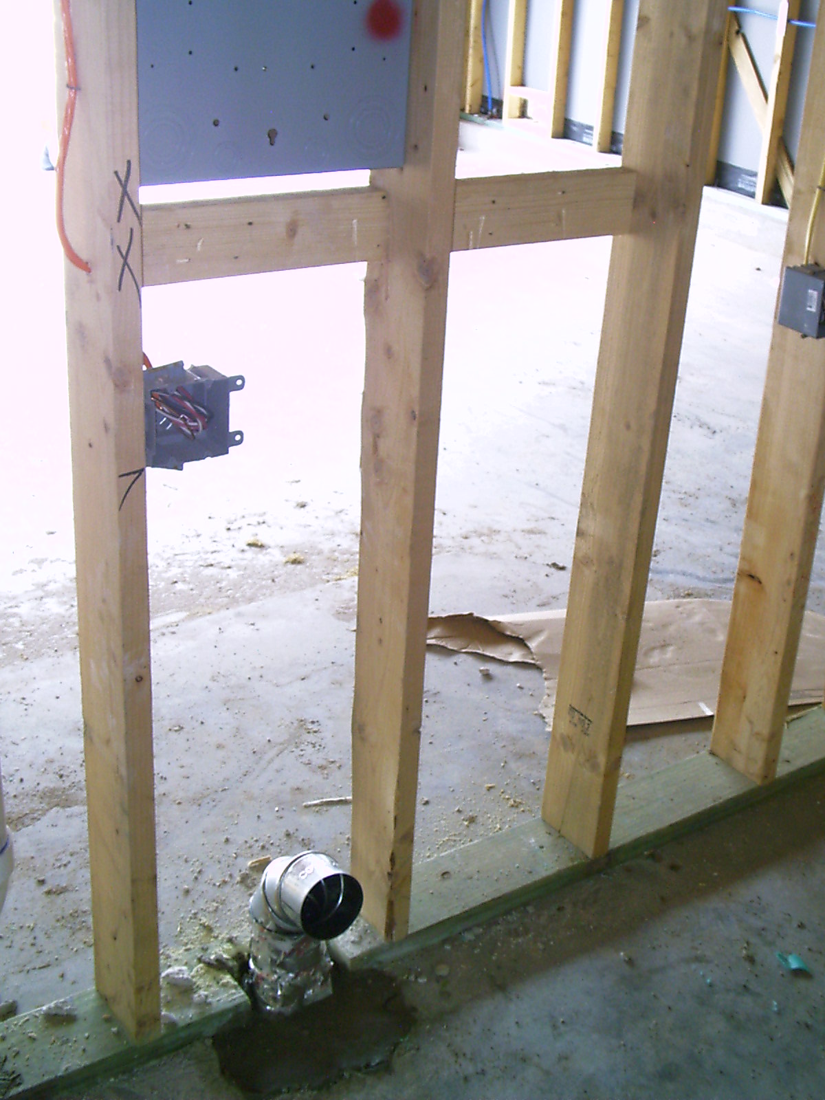

   / Can I put a dryer vent duct under a concrete slab? #4
Here is how they did mine with pvc in the slab and a metal elbow in the laundry room to connect to. That side of the house had about 2' of exposed concrete above the grade.
How long have you had your vent in place? Are you seeing any issues with either condensation or lint buildup?
Incidentally, what line size is that and how long of a run is it? Did you slope the vent downhill to let any condensation drain out?
Thanks for the pictures. That helps alot.

We had that house 2 years before we moved. It was sloped well, 1' drop in a 15' run, I never had a problem with it clogging up. The ones that run up the wall to the roof I seemed to have to clean those out as gravity causes buildup of lint and condensation. I designed our new house so the laundry is on an outside wall, the vent runs straight thru the wall to the outside.
