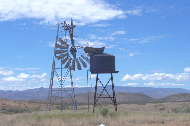

We actually have/had two windmills. One kinda lost an argument with a dust devil.
Both are about 280 feet deep and the pumps are at about 100ft. I just had the working one redone. The pump itself is about 2in. But it is hooked to a 3 1/2 in up pipe. I think if you get the up pipe too small the sucker rods will wear holes in it.

Wow, thats a lot of damage. How big is that tank? 1500 gallons? It amazes me that those little steel "chicken legs" can support 5 tons. So your pump casing is 3 1/2 inches and the pump is suspended inside right?

The pump is different from what most people are used to. A Pump cylinder is actually screwed to the bottom of the up pipe. they come in various sizes. It is open at both ends. You then drop the foot valve down the up pipe from the top of the well. It just kinda sits in the bottom of the cylinder. You then lower the pump piston down the pipe with the sucker rod untill it fits inside of the cylinder. The sucker rod is then connected to the wind motor and the motor adjusted for the length of stroke that you need. That is a 1200 gallon tank. te other well has a 2200 tank on it. Those spindly legs are 6in pipe.
