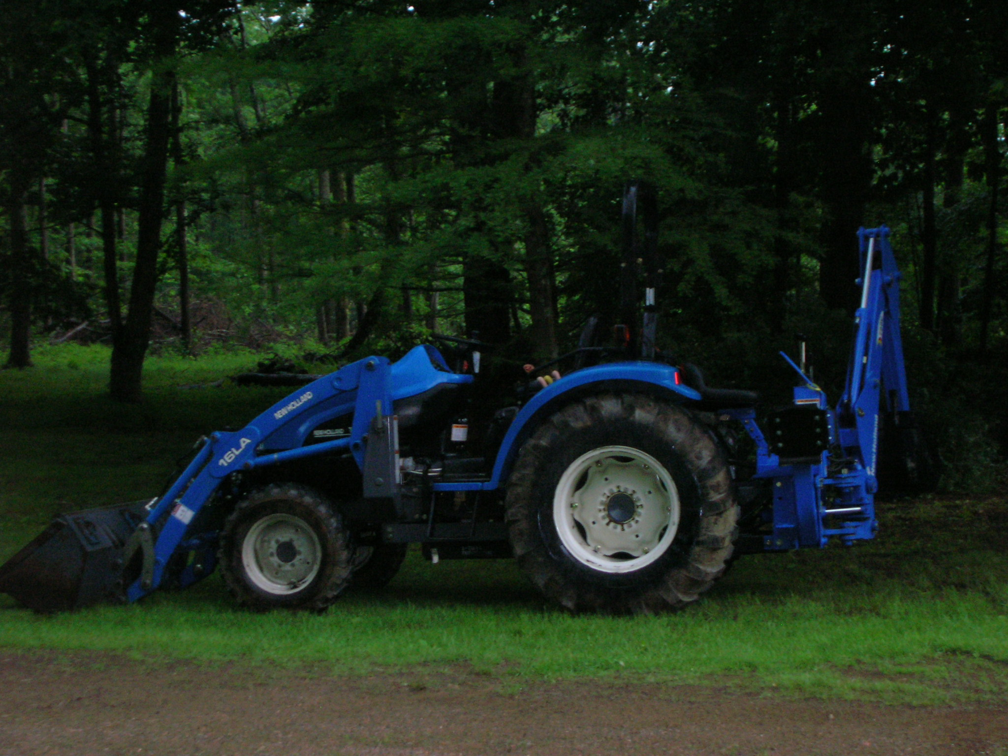

Yes taking them off is better than not. The ones that leave them on are stuck way too far off the back. Also the Kubota backhoe leaves the subframe on the tractor which is more user friendly to deal with.
Ahh. that makes sense... Our machine does not require it, nor does it push the backhoe further back when it is put on... It tight right up against the machine... There is a bracket that the 3 point arms rest on when you the BH is attached.
That's why I couldn't for the life of me think why you would want to take them off... (y)

I haven't taken my BH off yet. But I am quite sure I'll have to figure out how to do it myself. I am imagining that I will assemble a nice collection of wood blocking, and simply use the bucket out behind the hoe/tractor to apply downforce as needed to lift it up and take the weight off the tractor. Once it is slid out of the subframe brackets a few inches, disconnect hydraulics and drive away.

Every model is different, even within the same brand. I leave my 3Pt arms on. I have a 4 point BH mounting frame. Toughest part is backing in to align the lower pins. I can't turn around and look down well enough to do it, so I'm on and off the seat a few times. Once in place, using the BH controls isn't usually too difficult to drop it into place and set the two upper pins. Removing it when done is much easier.
It might not be so bad on level ground, but I have very little of that. No rolling dolly will work for me since it's all on grass or dirt, no paved surface.

Forget the blocks. Use the hydraulics, stabilizers and bucket to disconnect the backhoe. Move the tractor ahead a few inches, use the hydraulics to lower the backhoe frame to the ground (on plywood or similar if you prefer). Shut off the tractor and disconnect the hydraulics. Cribbing the backhoe high off the ground is unnecessary and unsafe. You will NEVER have it at exactly the correct height to reconnect.
