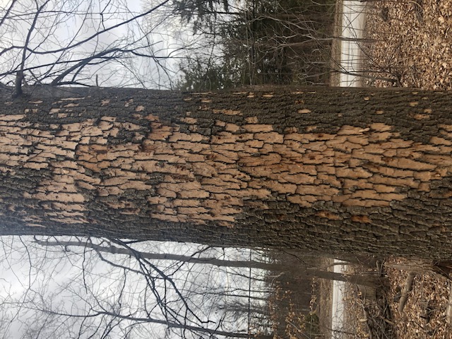

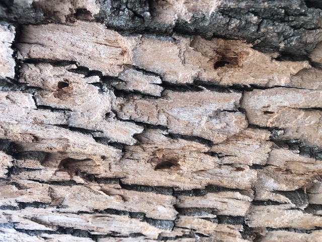

Can anyone identify what is happening with this tree?
   / Can anyone identify what is happening with this tree? #11
^^^^ Woodpeckers love EAB's. One way foresters can locate trees is by the woodpeckers' activity. I have active pairs (or more) of Downey, Hairy, and Red Bellied woodpeckers around here with an occasional Pileated woodpecker.
I believe the AEB/woodpecker damage weakens the tree so the virus can spread as well. Healthy ash trees can be treated with a systemic root poison to help protect the tree from EAB, but it costs ~$500/tree due to the cost of the chemicals and special equipment needed and the tree requires re-treatment every 2 years.
   / Can anyone identify what is happening with this tree? #12
This a more extreme condition (like yours) Most of my Ash shows more sporadic damage.
   / Can anyone identify what is happening with this tree? #13
The tree should have been turned into firewood a couple of years ago.
   / Can anyone identify what is happening with this tree? #14
Only got the place 2-1/2 years ago. And only have a tractor coming tomorrow. 11,000 lb skidding winch will be a week further out. With a lean in the direction of the Bell lines I figured I wouldn't worry about it too much in the past.
Got another one just as bad. That one has hydro lines in one direction, a bigger maple in another direction and my septic bed in a third direction. Going to use the winch and a snatch block to coax it where i want it to go.
