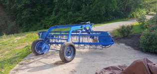

Can anyone identify this rake?

I’m going with New Idea. May have been one of the ones they made for Ford early on.
/ Can anyone identify this hay rake? #5
Definitely built by New Idea. Could have been badged as that or Ford. I’m thinking it could have been sold under another brand but which has escaped me.
/ Can anyone identify this hay rake? #6
/ Can anyone identify this hay rake? #7
If that is the original paint is it definitely a ford branded unit. I had the 3pt version. Ropes hay bad. Some parts (bearings and tines) are available, otherwise good luck on parts.
Twin - https://www.auctiontime.com/listings/farm-equipment/auctions/online/33606991/new-idea-402?gtmlt=1
This web site can help give you information on it too. Red Power Magazine
Manual New Idea 42 and 43 Parallel Bar Side Rakes Manual | Farm Manuals Fast
That’s hardly original paint. The color is wrong to be Ford and the left tire shows paint running down the sidewall.
These rakes run slower than a NH rollabar and work as well or better IMHO.
/ Can anyone identify this hay rake? #8
Except for the belt drive and the paint it looks identical to my IH 16. I wonder if during that time frame if a lot of parts were interchangeable.
#9
Meant to update everyone a long time ago, but it turns out it is an Allis-Chalmers model 77g. I have restored it (for the most part) but I still have some of the blue-painted areas to deal with. Getting it functional was my first priority. I will attach some pics when completed.
