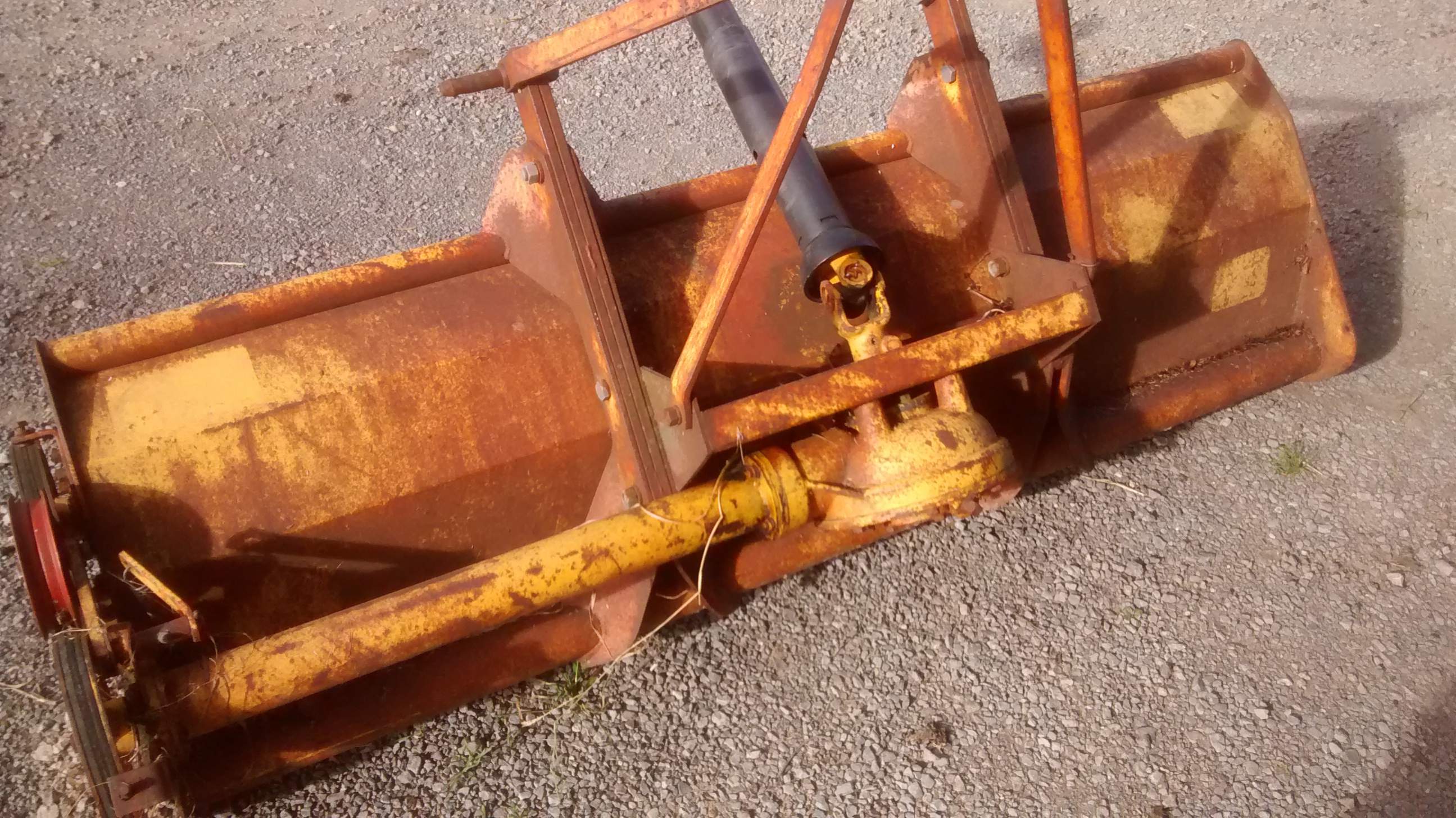

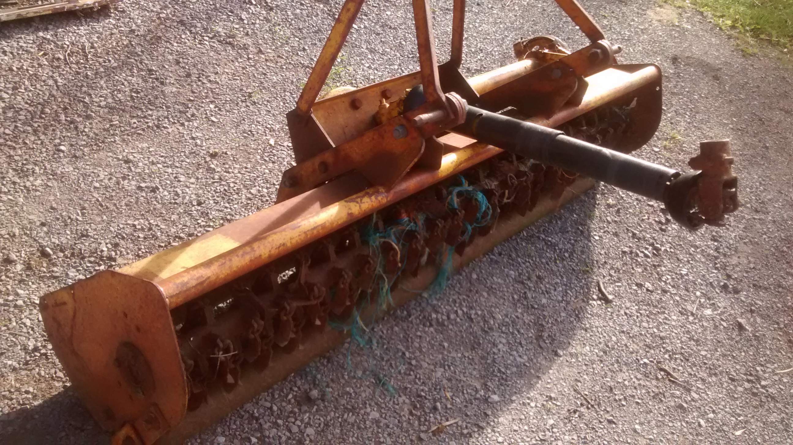

Hey,
Brand new to the forum. I've read lots but just registered.
I'm looking to buy this mower as the price is right ($300). It needs a new bearing and probably some new knives but other than that looks good for what I need. Can anyone tell me what make it is so I can determine parts availability.
Thanks,
Josh

It's a Mott.
/ Can anyone identify this flail mower? #4

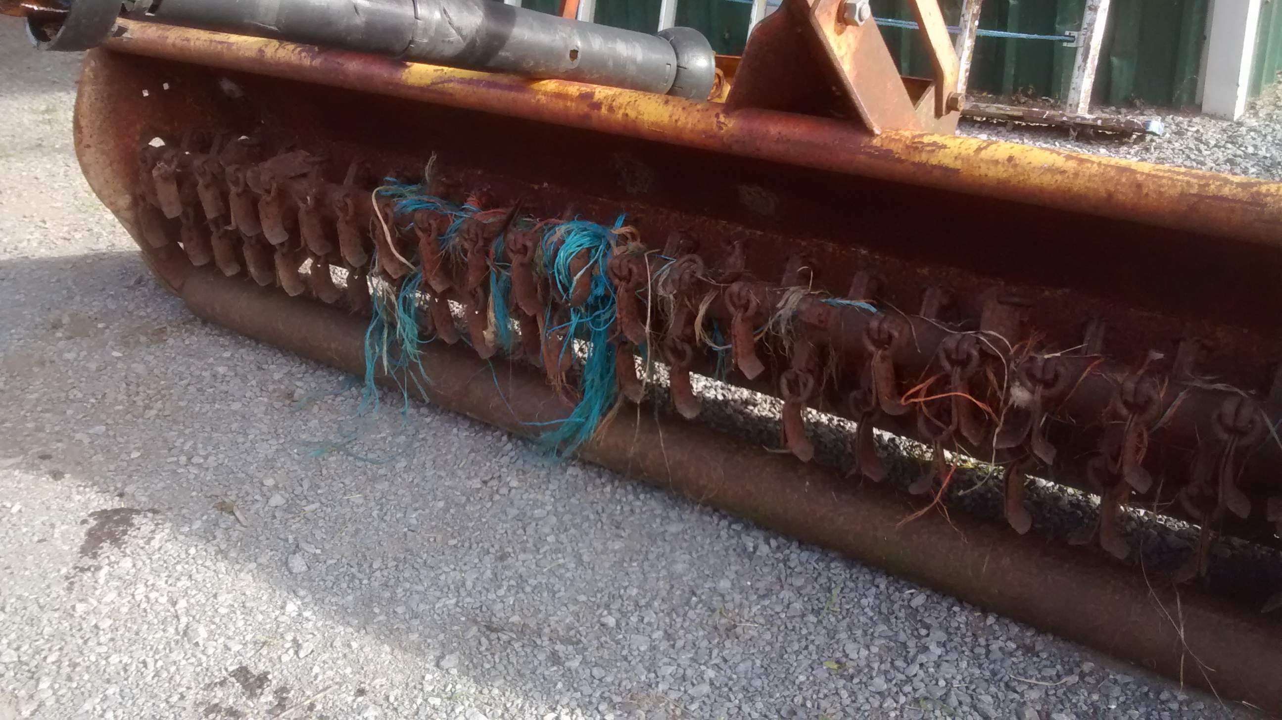

It will probably need a new belt and you will probably want to fab up a pulley cover as well if you're not finish mowing with it. I would order a PTO input shaft seal from the same place, when you order the new knives.
Wonder how long they ran it with all that bailer twine in it? :)
Knife replacement is a LOT of work.
/ Can anyone identify this flail mower? #5
It looks exactly like my Mott. The pulley set up is different though, on mine, the third pulley is spring loaded and the belt goes to the outside. Might check to see if that one has been modified. They are very good flails though, mine is old as heck and still works great.

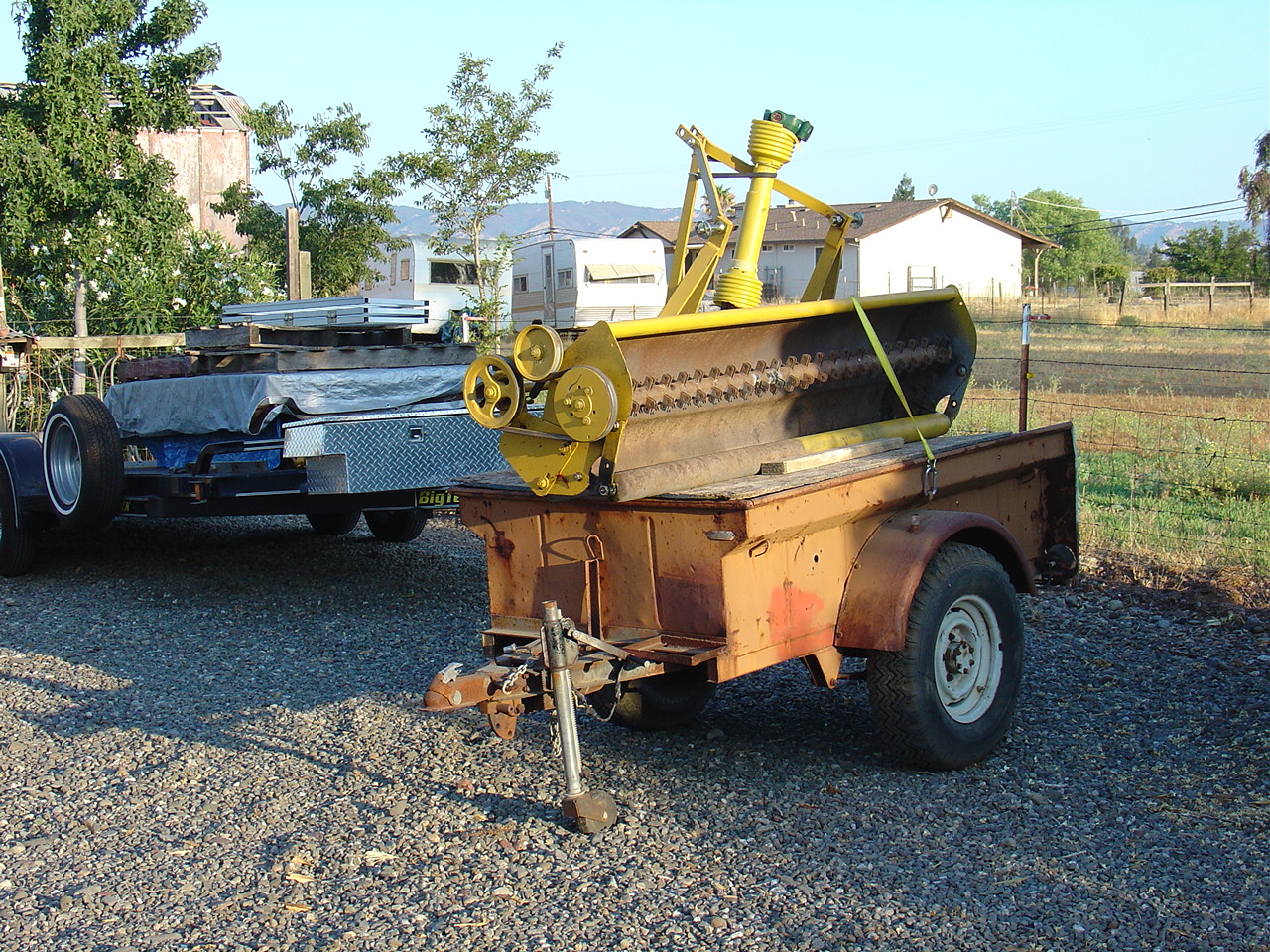

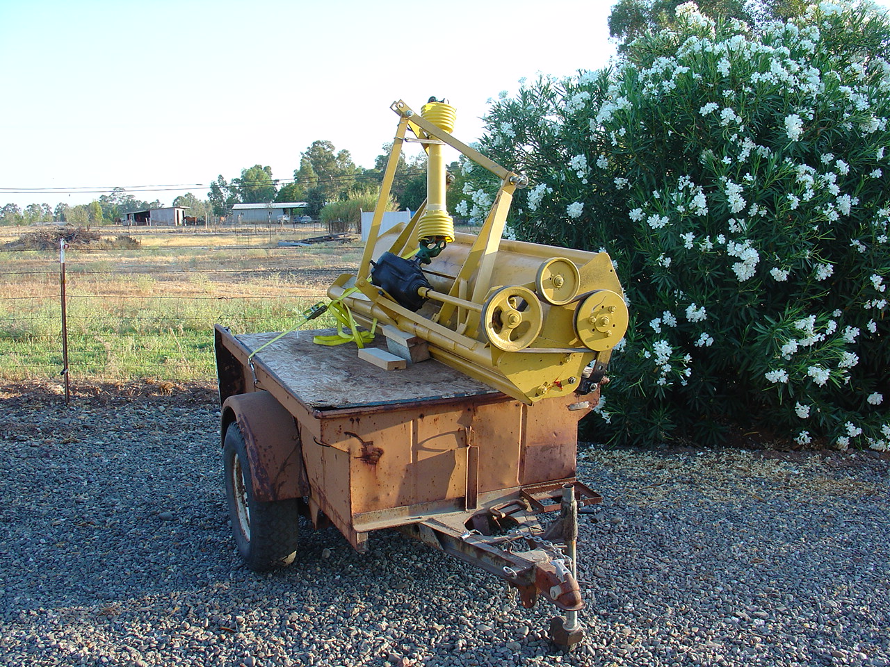

I'll go with the Mott crowd as well. Here is (was) mine in the middle of rebuilding.
However, note that the pulley arrangement is on the opposite side of the OP's.

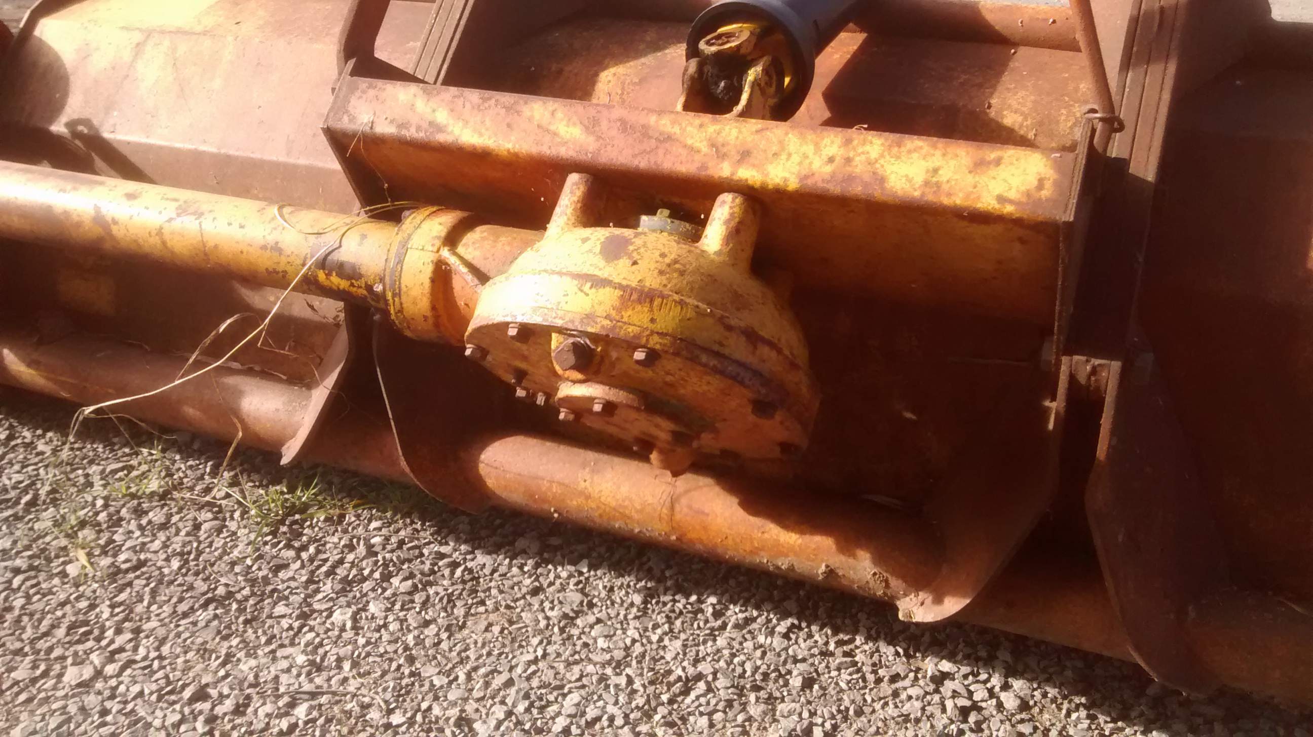

Sorry the for the late reply but the season is finally winding down and I have more time to think about this stuff. Is there any specific reason why I should replace the input shaft seal? I'm game to do it just wondering. Thanks.
