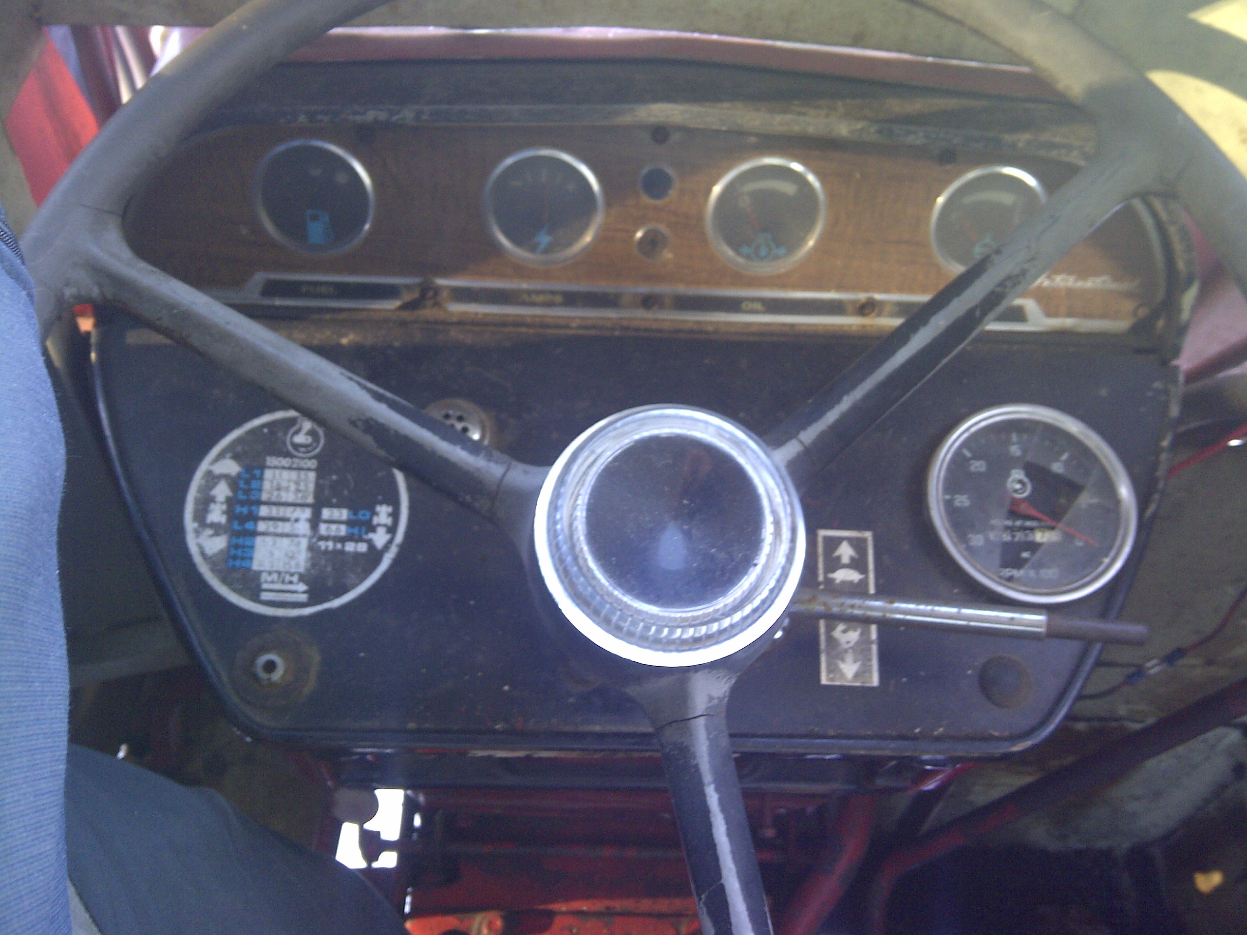

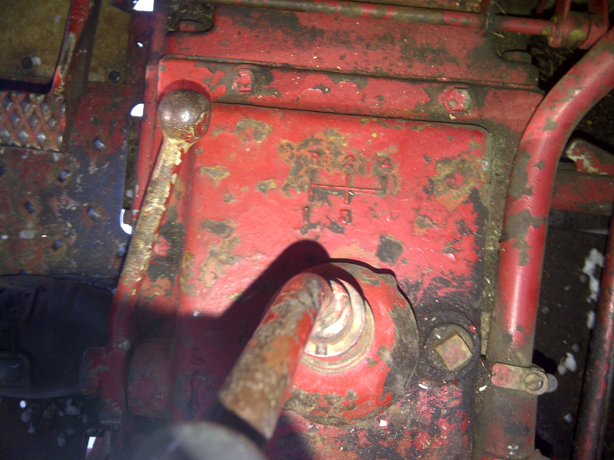

Thanks for all your investigative work. I'll have this thing home someday. At this point it's hard to say whether I'll smiling or sobbing. At the moment, I'm just nervous because I paid $5500 for a mystery that'll run and work I think. Rear tires and some hoses look original, so that's not so great. It'll be different than my loaderless 8N - that's for sure.
Blackberry came back to life and I've got two more images to share. One shows the dash. One shows the shifters. Seems to be a High-Low range shifter and a 1-4+R shifter.

First photos i had my suspicions the "hydrosteer" steering ram was fitted to IH Bradford built tractors!!
Further photos confirm my suspicions !! It is probably a 444. Confirmed by the location of the serial no plate on the r/hand of the clutch housing!!
Model no and serial no are all there stamped into the plate!!!
A480003 is the " kind code" or tractor build and B000643 tells me it is an early model as serial range stars @ 501 . B means built in Great Britain
I don't have a listing of kind codes so am guessing at 444 but am fairly certain
On 2nd photo there is a decal near bottom front of bonnet!! What does it say??
Other models of this similar family would be 354, 374 & 384 !!
Do you have a service manual as i sell these in PDF format on CD or as a download??

This is a 574 from the mid 70's. HP 68. It is fitted with a non IH cab.

I agree it is not a 674. Shifters TOTALLY incorrect. Not sure if the 374 and 384 had shifters on top of tranny, or at operator's hip. Grille is wrong but shifter is right for a 444.
