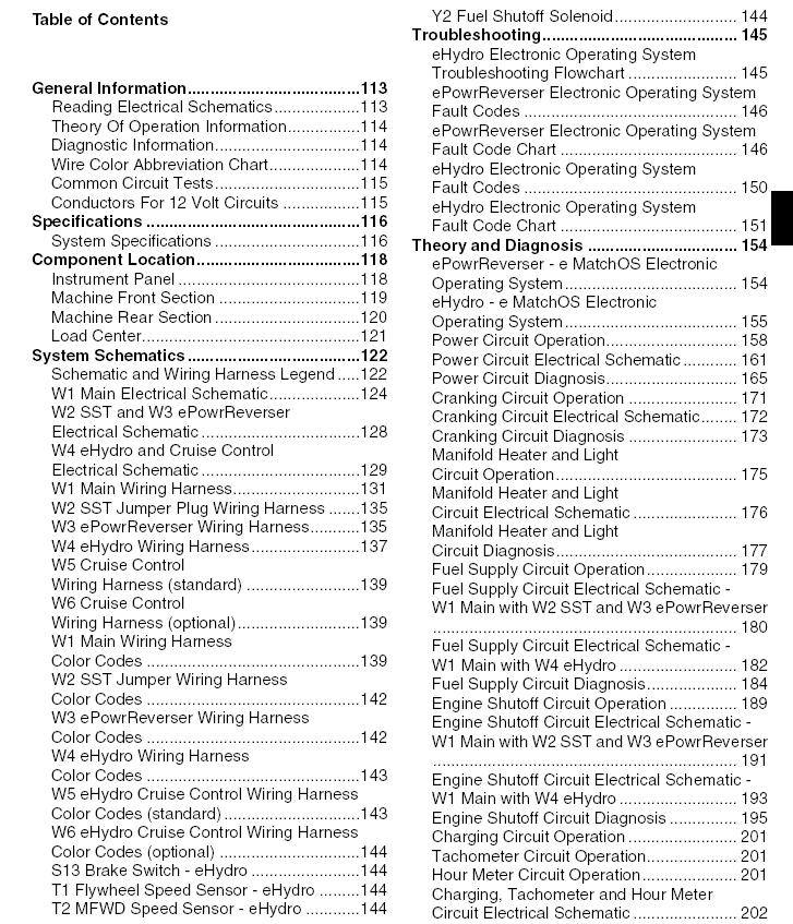

when i bought my 4310 i bought a manual to work on it but the manual didn't cover my sn#
and changes were made on the 4310 that the manual doesn't cover
i need the wiring diagram for the drive controller for an ehydro and test procedure for calibrating it
this is an emergency to me as now my tractor wont move at all and i need it , i have a horse farm
deere is closed till monday
also does anybody know how i can contact deere directly?
the sn# is lva4310h330143 so i need a manual that covers from that sn# forward
i bought it in march of 2004

Have you been on jdparts? Off hand don't know if the schematics are there or not.
I'll see if I can find some time to find it on my CD tech manual.
Here is the Electrical Table of Contents. See what you are looking for? I didn't find the drive controller (yet). :)

I may not be any more help than the dealer. I posted the table of contents. See anything there to dig into?

I posted the table of contents in Post #2 above.
There are many pages of wiring schematics, and I'm not finding anything specific to "drive controller" so hoped the TOC would list something that would lead to something particular to look at.
If you see anything, give a shout. Not sure here what revision chickenman is looking for. Maybe mine is too old ??

we can start with 155, 151, 150, 139, 143
maybe those pages will match my actual wiring
is this from a paper manual?
